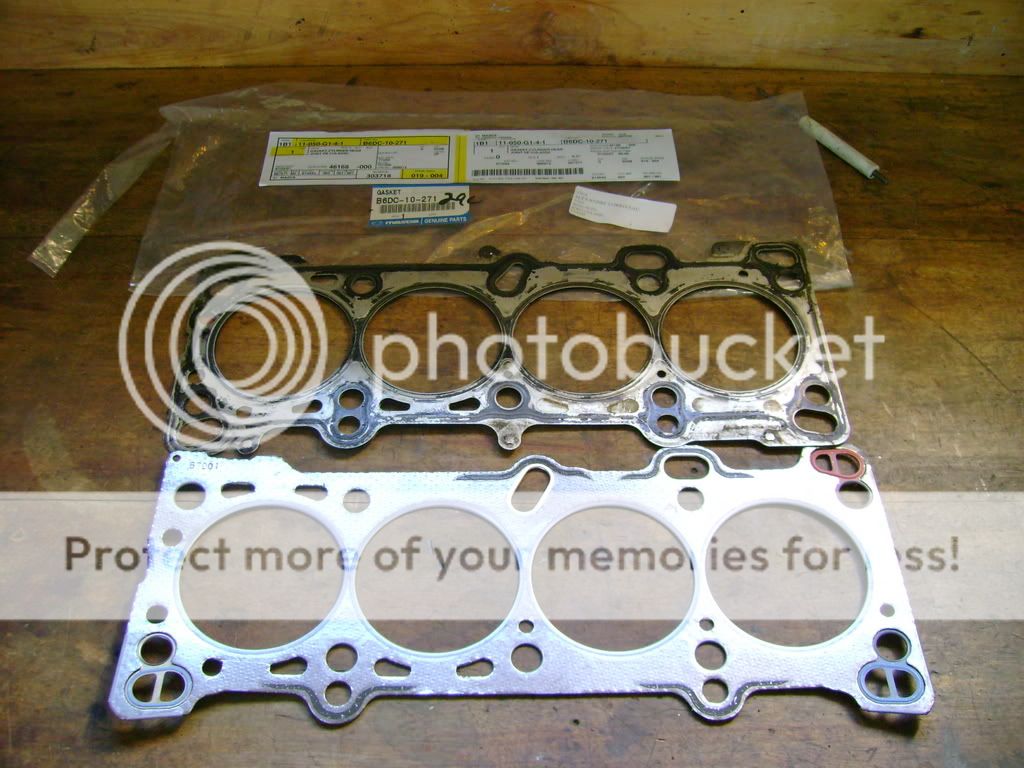

I'm going a different route with the pistons. the bottom end from the B6 miata is supposedly the same as the ZM protege but for some reason two different ZM people had to skim 1mm off their miata pistons to fit the ZM. human error? some variable between the two motors? don't know don't care. no need to risk losing warranties (parts and labor) and alter the pistons.
the only difference between both motor is the head gasket. Use the b6 ze head gasket
B6 ze: 1.1mm # b6dc-10-271
BP: 0.7mm
ZM: 0.4mm
HKS also made multiply metal gaskets for B6ZE 1.2mm and 2.0mm.
it maiby simply that way?
i've put the b6ze one on my zm stick there with copper gazket spray and arp studs
and evrething goes great
on mazda motorsport, it cost about 40$
BP: 0.7mm
ZM: 0.4mm
this is info I got from Mazda:
B6 specs:
Bore-78.000
Connecting rod length - 133.90+/-.05
CR Big hole bore - 21.838-21.890
ZM specs:
Bore - 78.000 - 78.019
CR length - 132.90 +/-.05
CR BHB - ????? not in any of my info.
