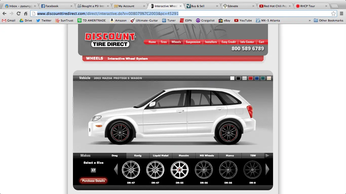

I like the look of a mesh type wheel on P5's. Go with any color but black on the wheels. Window tint is a must. Dealer logo has to go!
