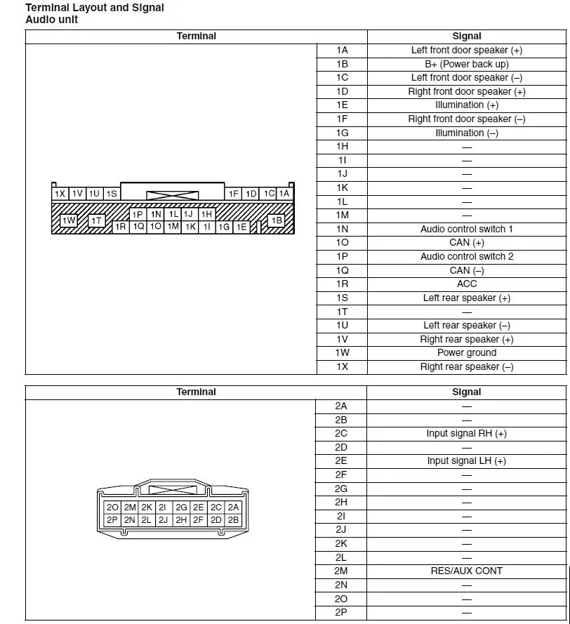

"If you want do it cheap, you have to do lot of stuff by yourself". One of the hardest thing was the preparation of wire harness connector. Metra 70-7903 comes with only 13 wires (8 wires for 4 speakers, +12V, GND, ACC (ignition), illumination and antenna) You need two extra wires for steering wheel control (Steering wheel control 1 and steering wheel control 2 in the diagram). So I bought two wire harness connectors and broke one connector apart (This is very hard. You need a hacksaw blade) and got 2 wires with correct connecting pins. I carefully inserted those two wires to other wire harness connector and put a little bit of glue.
Connecting wire harness:
I used attached diagram and after market unit documentation to do the connection. Those posi connectors eliminate the time consuming soldering. 2010 Mazda 5 has a separate antenna wire. So I didn't use the antenna wire (1H) in the harness.

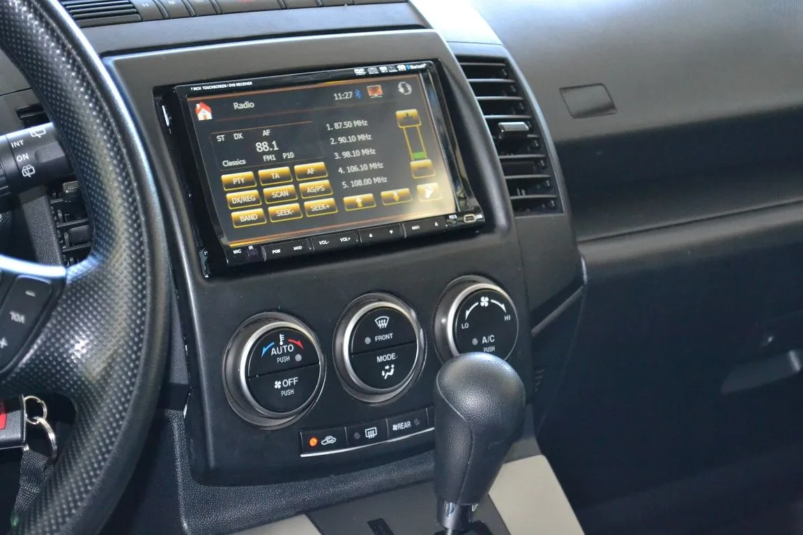

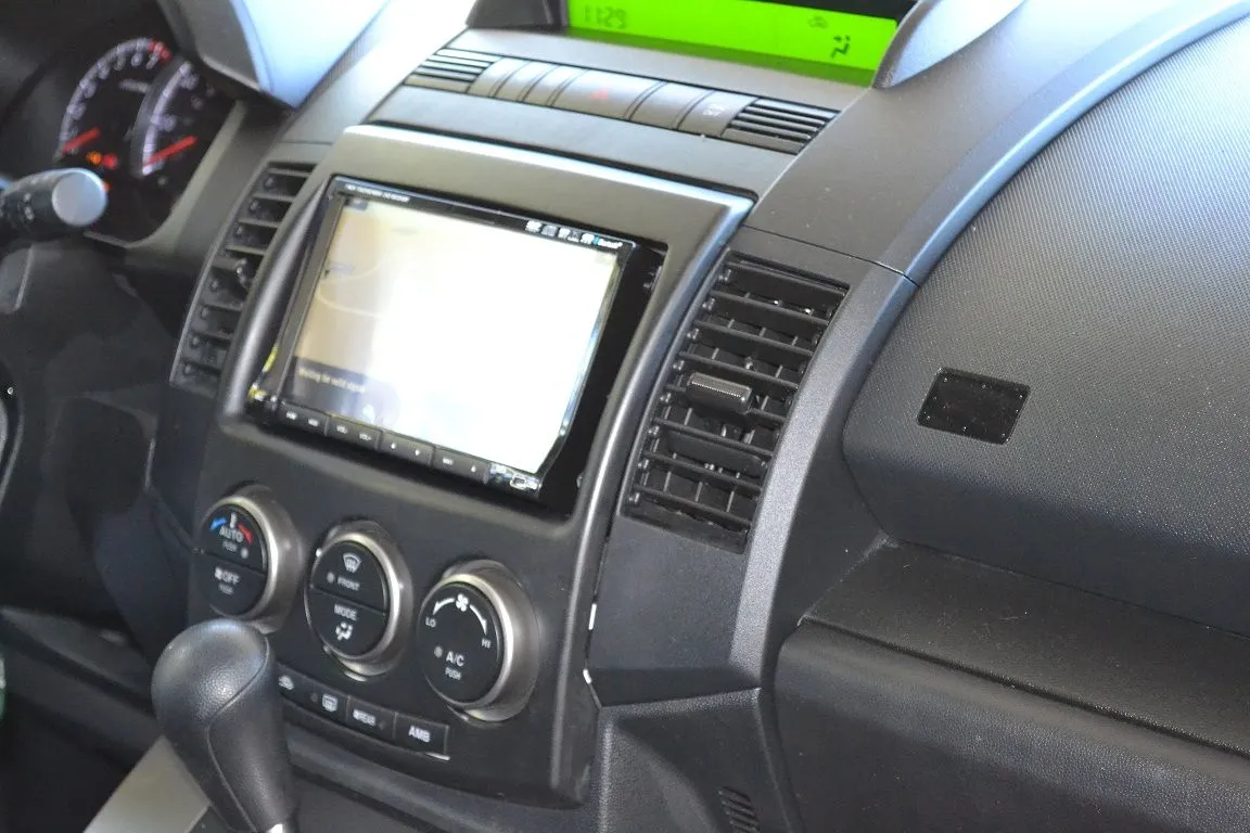

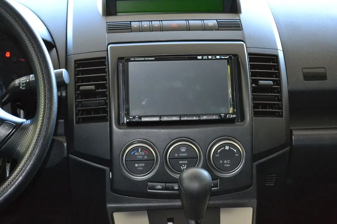

As I mentioned earlier, I removed the Metra cover and painted it in black (Black flat spray paint: $4.58). Before painting, I sanded the surface to remove existing paint. Please see attached pictures.

Looking at the pics, there seems to be a gap between the dash kit and dash. Also the HVAC buttons seem to be recessed a tad, are you sure it is mounted correctly?

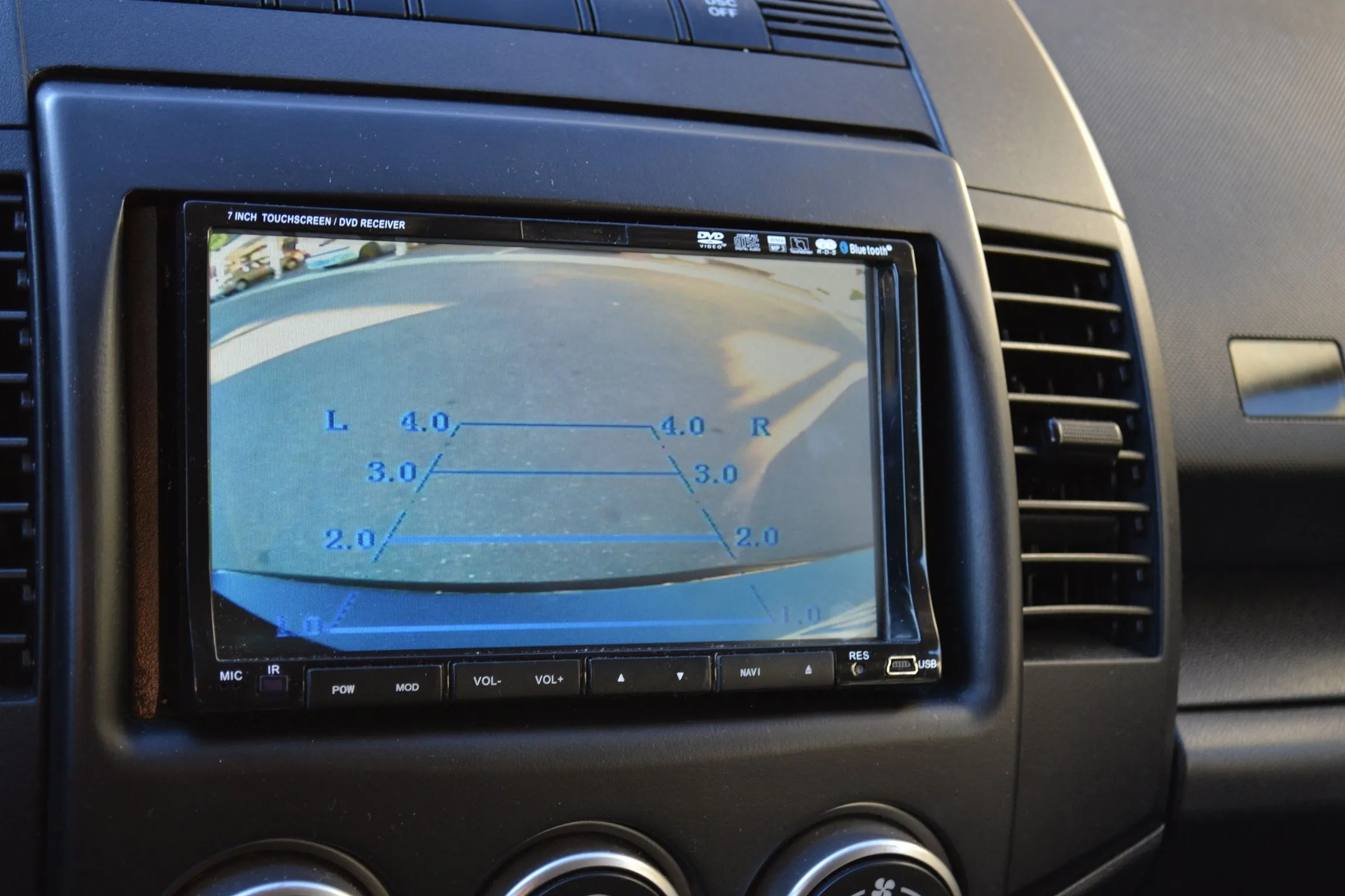

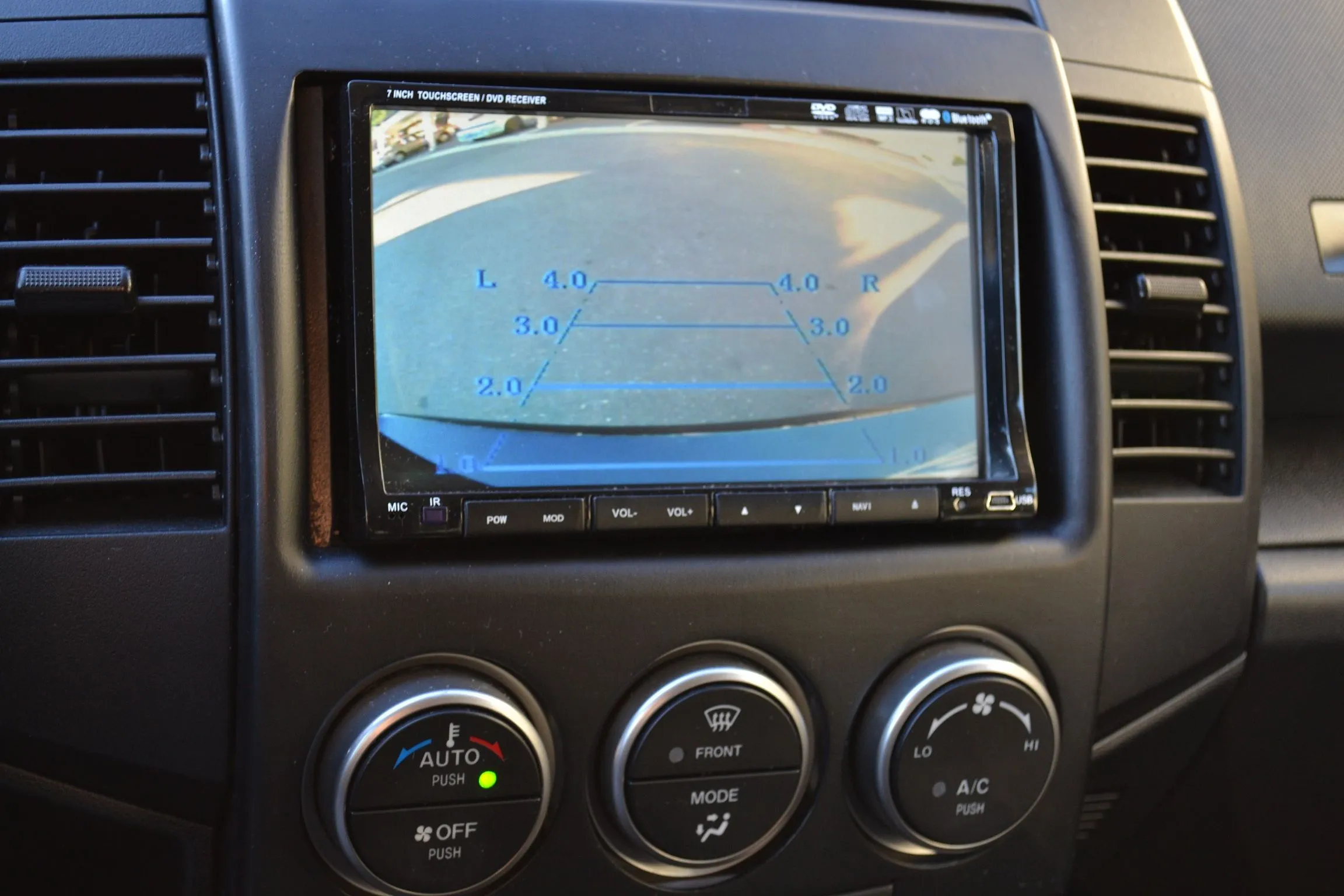

Here are some of pics.
Quality is good. But sometimes I get interference signal. Before finalizing the location of the transmitter, I turned on the system to see the quality of the image. Then, I realized that the orientation of the transmitter is critical. I found the best orientation and used Velcro strips to attach the transmitter to theliftgate. If you want to get a quality signal without any interference, you have to run wires to the front.
Installing camera: I removed the existing lamp cover to install this rear view camera. It does not come with a waterproof seal. One of the downside of this camera plate is it comes with two unnecessary openings. So I got a sticky sponge tape and covered openings and made it waterproof. This camera not the best. It doesn't have infrared LEDs. So you cannot see much in the dark.
Yes! it was mounted correctly. Metra cover is not fitting really well. But that is the only available cover in the market (Scosche cover doesn't work for this double DIN unit)
