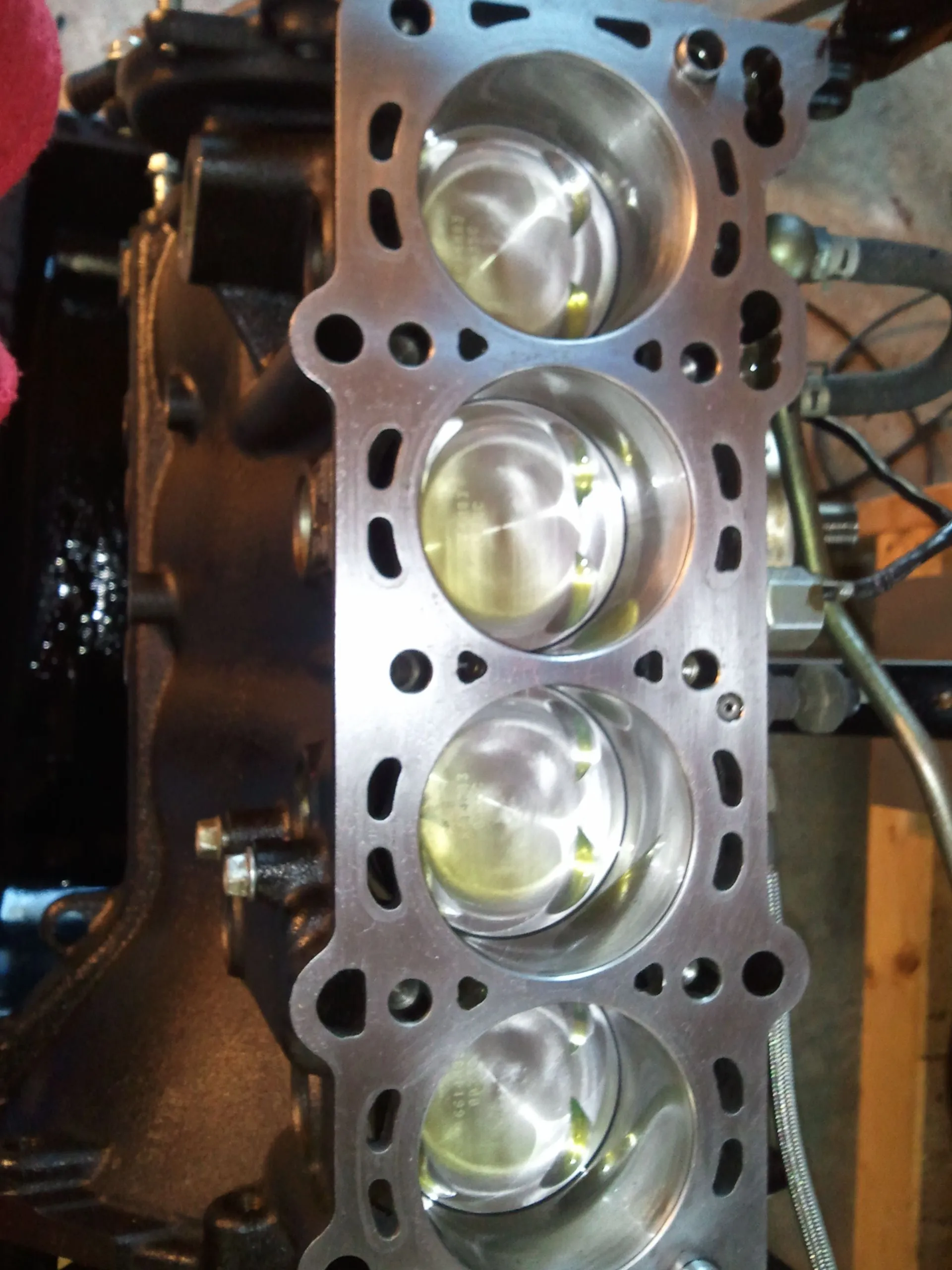

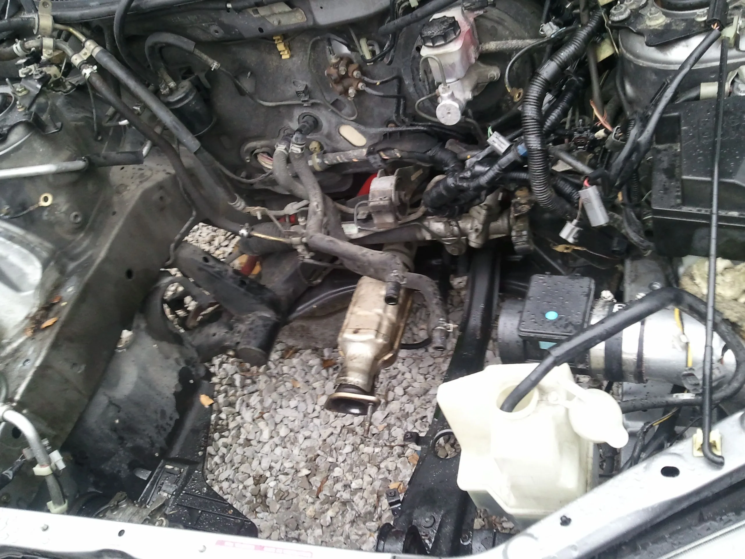

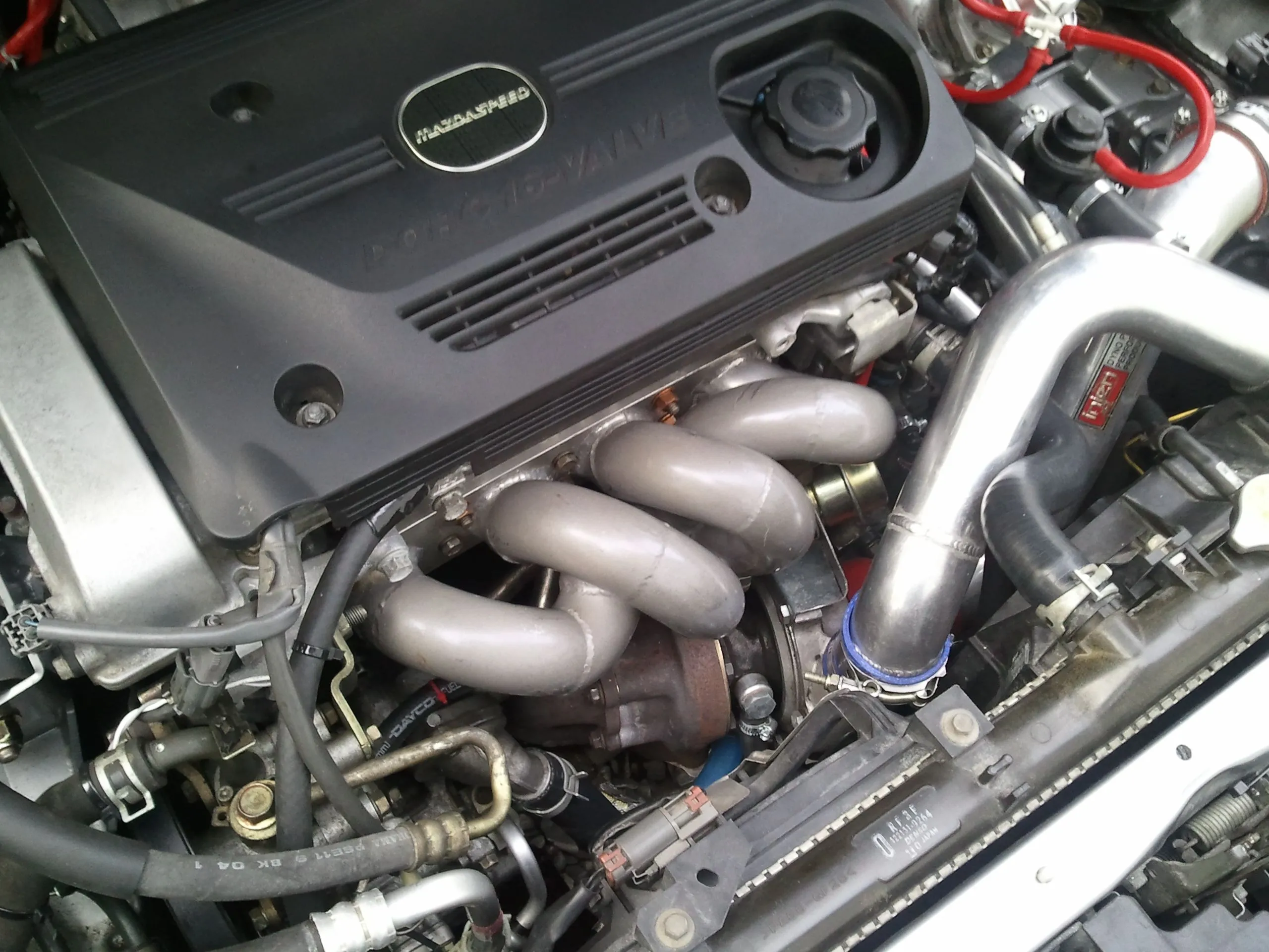

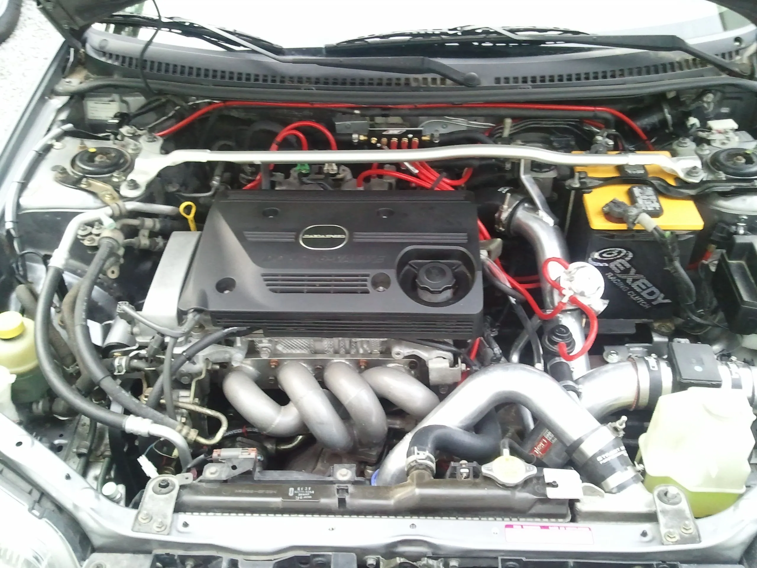

With that said, here are some of pics of my winter time build!
The motor was rebuilt and forged, and I installed a gt28rs on an MAM manifold. The parts list is toooooo long to post lol, I'm sure you guys can tell from looking at the pictures!
Also, if you see anything odd, please feel free to let me know!
The never ending project continues with a new coolant elbow and an ss braided oil return line install this weekend!
Awesome man. Congrats on your build. This forum helped me out a ton too. Now drop that thing and get a fmic
You kept the VTCS and VICS in the intake? You could probably get rid of the stock BPV and it looks like the vac lines for the BPV/BOV are hooked up weird, should run to the vacuum block. Looks good I hope you have some solid motor mounts under there, and a DP and full exhaust will wake up that 28rs like nothing else.
I have the bov/bpv tee'd on a single line that goes to the vacuum block. Is there something to gain by running them each on their own line?
The intake manifold is a project for a later date, along with a dp and exhaust. I'll be over in the FS section checking for a setup.

You get used to the vibrations from the mounts, they are entirely worth it though. The WG and BOV need to be run off seperate lines for sure, it might be better to run the BOV and BPV independently but there isn't really a reason to. You should remove the BPV and cap off the lines.
