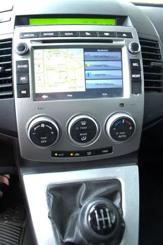

As you can notice in the picture, the org. 07 HU is a bright silver the Chinese HU is a richer Pewter kind of color. Nobody has noticed the shade difterence as it looks like it maches perfectly because of light angles and shade. I lkie the Pewter better it dosn't look as cheap.
I guess the only real problem with the HU is that they couldn't spell Menu ( use the Meun button for this function! ) Like I said above the instal and operation of the unit... Just great. Putting in an optional Reverse Camera, that was a couple of days. I wanted to keep all the wiring invisable. Hidiing the RCA and Power feeds in the rear hatch required some real thinking and difficult drilling. The trm around the window is part of the bonded structure and there is a steel sub frame with solid corners that wont allow you to pass the wires internaly. It's all done and looks like afactory insalation now.

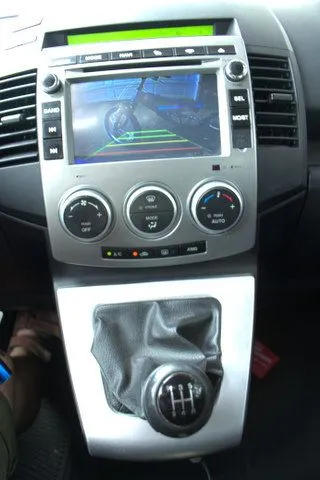

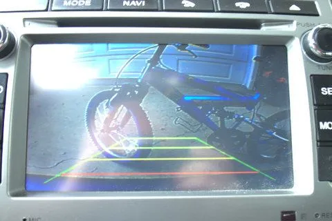

Photos
Here are a couple photos. One shows the 30 dollar backup camera image. Its been working flawlessly for over A year. Noticed the graphed lines. The green (second furthest) line allows about two extra inches to lift the tailgate. The red line tells you when the bumper is about to touch. It was perfectly calibrated out of the box!!
