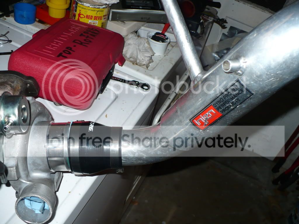

-Intake coupler (I used 3"-2.5" reducer with an injen CAI. The CAI is a 2.25" but works if its really tight of trimmed on the intake)

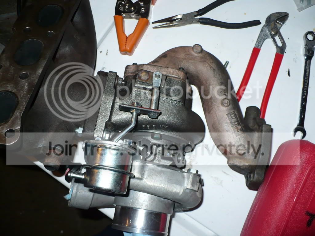

Once that its out, you can now get to the turbo flange and s-pipe to separate them. Now clock the new turbo with the 13mm bolts(don’t
take them out just loosen a few turns otherwise the housing may come off) in the middle. Try to match it up best to the old turbo, the oil
drain line, hot pipe out put, etc. there are two methods to get the WGA to fit in the car( wont fit the way it comes).
You can move the WGA bracket to the two closest bolts to the hot pipe, using the WGA bracket and WGA that came with the gt2860, or
use the GT2554 bracket and WGA. The argument is that the stock WGA isn’t going to open the WG all the way 90 degrees.
But the gt2860 WGA rod has to be modified, see link for full discussion http://www.mazdas247.com/forum/showthread.php?t=114003.
(I am claiming no credit for this idea)
Also its a good idea, suggested by "terbow" to use locktite or something on the bolts that you use for the WGA to keep them from coming
loose, and causing overboost. Once you got this and you have the new studs in the manifold and the new turbo install the gaskets and the
s-pipe and manifold to the turbo. Now you have to move one of the coolant pipes from the engine block. It’s the pipe that goes from
behind the thermostat housing to underneath the upper radiator hose which is where the one coolant line for the turbo hooks up. I found
twisting the pipe some and cutting the three way hose will lift the line high enough to fit the WGA.
Be prepared to test fit and reclock your turbo several times. I had to close to 10 times. Looking back its probably best to clock the turbo
with the two coolant lines on with the turbo out, so you get the middle close to perfect, then you can bend them into place.
Now you can put it all back in the car, you might have the radiator fans hit the coolant lines in the new position, just takes some work to
get it in. Also the intake from turbo to MAF may not line up perfect but fit for me. The gt2860 is at a slight angle towards the front.
And for some reason I had trouble getting the oil drain line to hook up to the pan, I hooked it first to the turbo. I’m guessing it was from
the clockin I had the turbo at.
