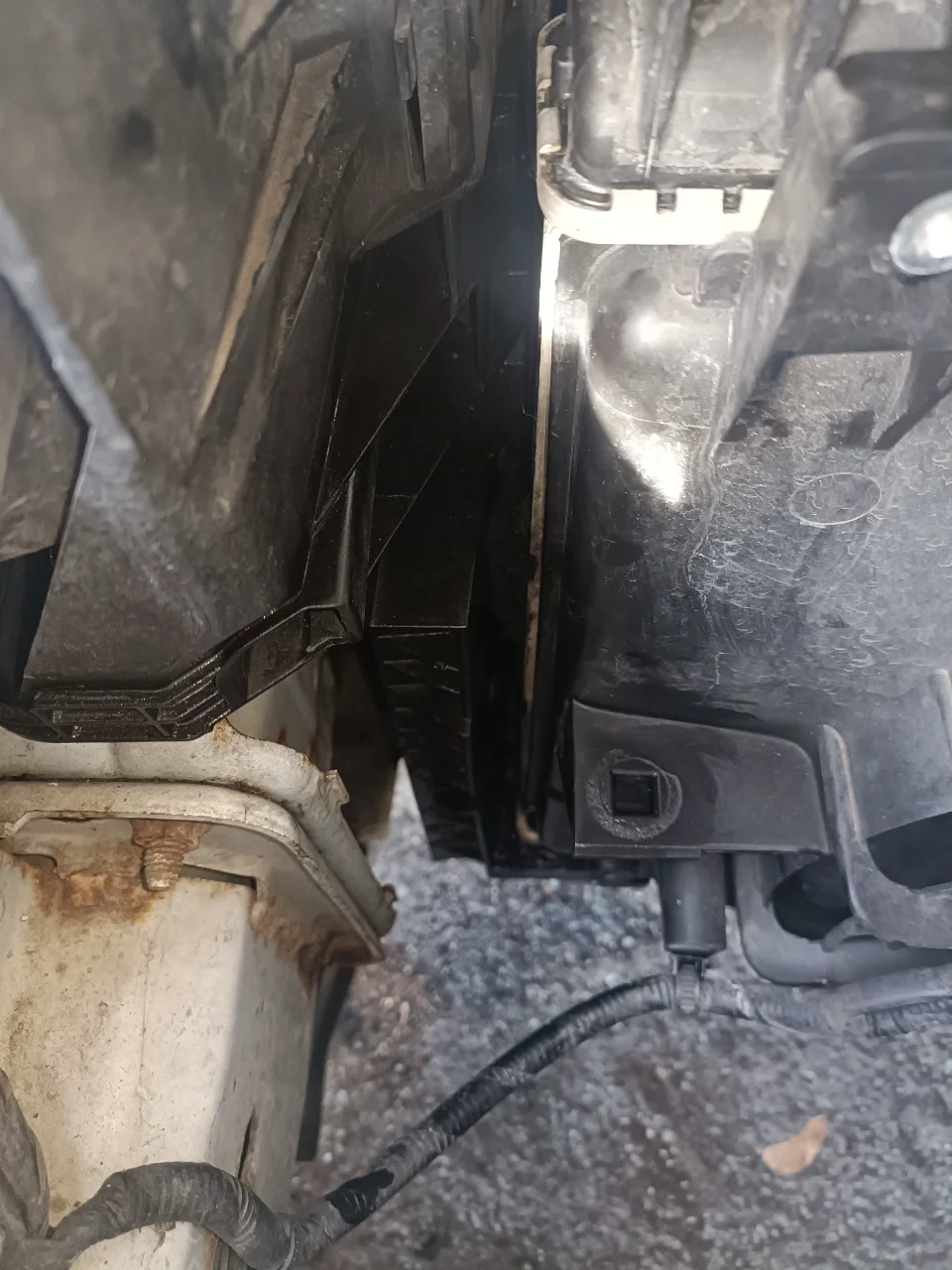

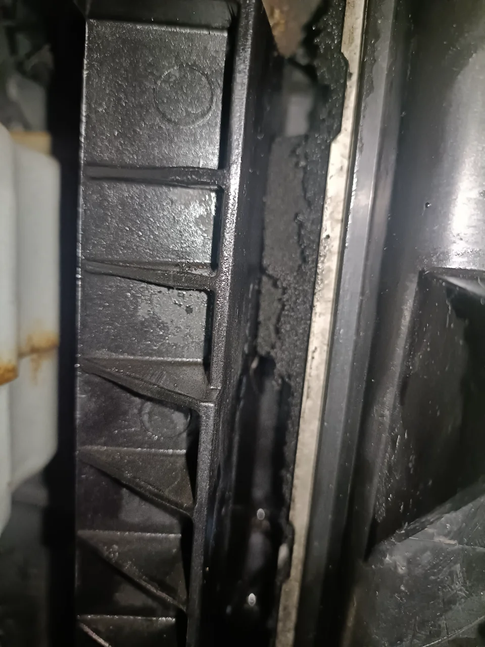

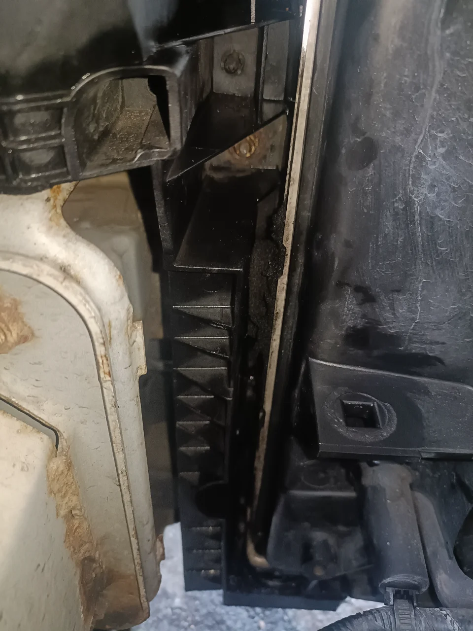

I have recently bought a used 2011, 1.3l, Mazda 2. It's been having some pretty big coolant leaks and it looks like its coming from the nearside of the radiator.
There is some foam that lines it, which is soaking wet and crumbling in my hands.
Does anyone know how to fix this / What this is caused by.
Thank you.

Replace the radiator. They're inexpensive. That foam may be some sealant the previous owner put in the radiator so you wouldn't notice the leak.
Also if you continue to drive it make sure the coolant is full otherwise you could destroy the engine. I'd take it to a radiator shop asap.

That's what I was thinking. I've been filling and checking the coolant level before I drive it, basically every time.
Thank you for your help.
