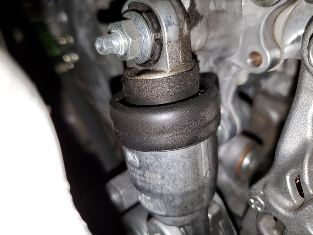

Went to check mine. It has started too although still in the early stage. Less than 15.000 miles.
Just clean it off good and check it periodically.I think (think -- it's been a while) mine,as it was failing, just slowly caused an increase in "engine roar" that wasn't all that noticeable until the new one was installed and then noticed it was quieter.Kind of like when shock absorbers wear out slowly and then you really notice the difference with new ones. Don't remember any squealing or loud oddball sounds.
Noises would start later when almost all the oil (its not a lot anyway) is out I guess.
I was suspecting high heat may have something to do with the rubber grommet not being able to seal properly.
Off to the dealer. I dont believe its normal to have any leaks no matter which element at low miles plus its a bigger risk when oil gets to the belt and who knows how it affects the other parts on the belt (crankshaft pulley, alternator bearing, AC pulley , etc). Hopefully they will replace under the 3/36 warranty.

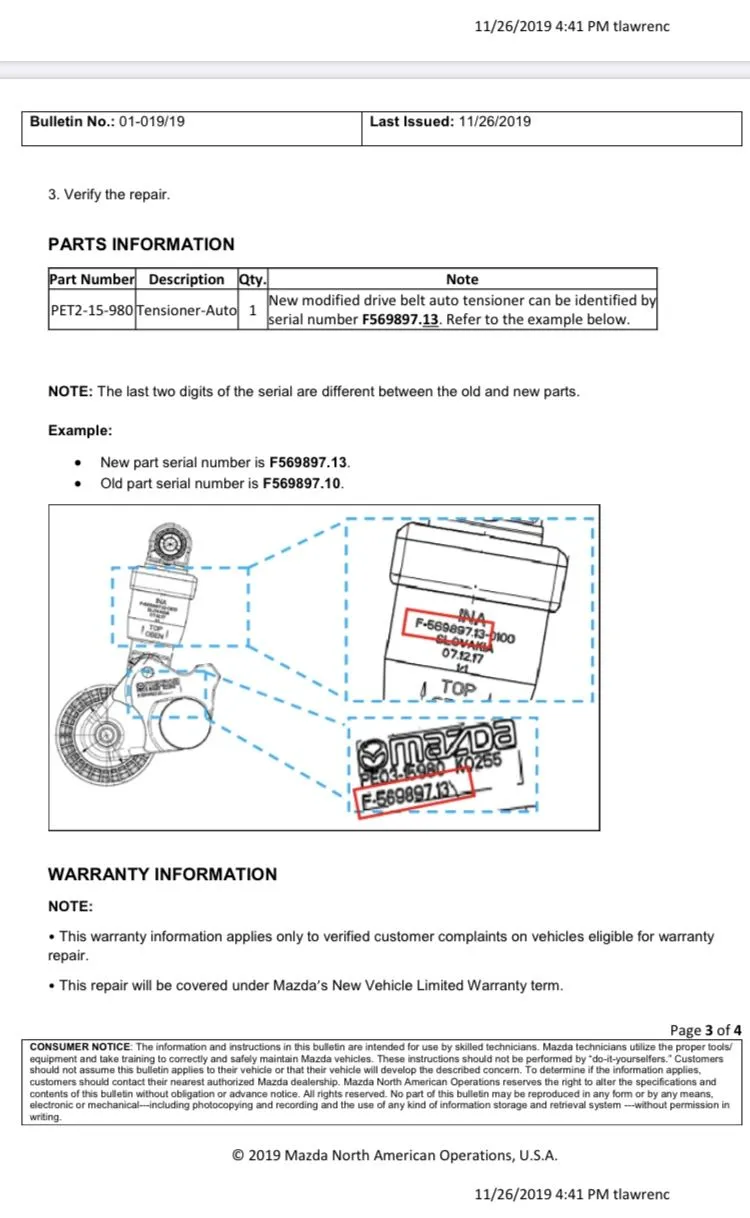

Yes, there’s indeed a TSB but it’s too late for most of us without new-car warranty!
TSB 01-019/19: OIL LEAKAGE FROM DRIVE BELT AUTO TENSIONER AND RATTLE NOISE FROM ENGINE COMPARTMENT
Description:
Some vehicles may exhibit oil leakage from the drive belt auto tensioner and rattling noises from the engine compartment. This may be caused by insufficient sealing at the drive belt auto tensioner damper when the auto tensioner fully operates under both high ambient temperature and high load conditions. To eliminate this concern, the shape of the drive belt auto tensioner damper has been changed.”
The TSB 01-019/19 issued on 11/26/2019 is applicable to US spec. 2013-2019 CX-5‘s and all other SkyActiv-G 2.0L / 2.5L and 2.5T’s presumably with PE01-15-980 or PE03-15-980 belt tensioner. People should check your tensioner before your new-car warranty runs out or you’ll be facing possible expensive repair sooner or later!

The TSB says to use PET2-15-980 tensioner and “new modified drive belt auto tensioner can be identified by serial number F569897.13.”. My theory is the latest PE03-15-980C is equivalent to modified PET2-15-980 with serial number F569897.13., but added some expensive super sealing which caused the 40% higher price!

We can also check the serial number mentioned in the TSB. One of the serial number can be seen easily on damper cylinder beneath “INA” wording. Everything with “F-569897.13” and higher than “13” is the revised version which has different shape of tensioner damper with better sealing.
