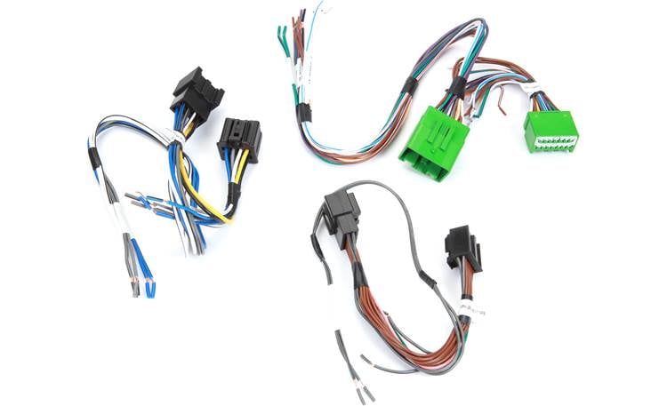

Wiring harnesses $34.99: you only need one of the harnesses (Black 16-pin) but if doing a broader install the others might be needed. The green 16-pin and black 16 pin connectors both fit the factory Bose amp but I didn't verify the other harness, will detail pin outs below:

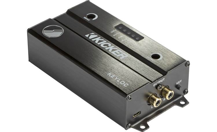

Kicker Keyloc $124.99: I used the Kicker Key 2 channel LOC in conjunction with an amp I already had. If you wanted to kill two birds with one stone, you could get the Kicker Key mono amp. The 2 channel LOC can be found here:

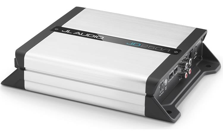

JL Audio JD 250/1 $229.99: I already had this amp from a previous install. Amp/Sub choice are personal preference. JD 250/1 here:

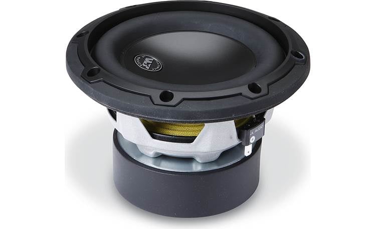

JL Audio 6w3v3 $299.99: Already had this sub from a previous install. Again, amp/sub combo are personal preference. These little 6.5" JL subs put out A TON of fairly accurate bass for their size. I used this because it fit perfectly in the wheel well. Sub here:

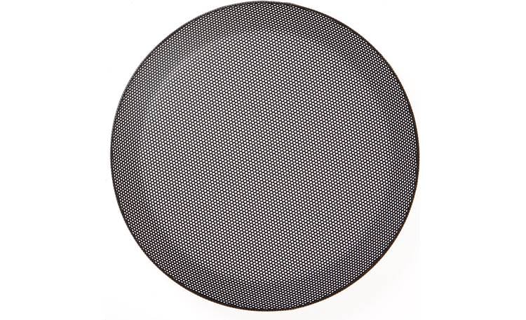

Sub Grill $34.99: self explanatory, here:

Step 2: Prepare your integration wiring harness. This will avoid cutting/splicing any factory wiring. Using the wiring harness linked above, you're going to want to grab the black 16-pin harness that looks like this:
After removing the amp cover under the passenger seat, you'll end up disconnecting the same black 16-pin plug from the factory Bose amp. It looks like this (ignore the disconnected green plug/leave that connected):
Ignore the wiring labels that come on the harnesses. With the plug disconnected if you are looking straight on at the Bose amps female port/slot, the pin outs look like this:
On the PAC harness above with all the brown wires, you'll end up connecting crimping together the grey and grey/black stripe wires, and then for the other 3 channels you'll cut them in the middle, and add ~8 foot wire pig tails onto them. Do the wires one at a time and label them as you go if it helps. Make sure you are working on the male end of the plugs below, not the female end otherwise the wires will be reversed and it won't work correctly.
