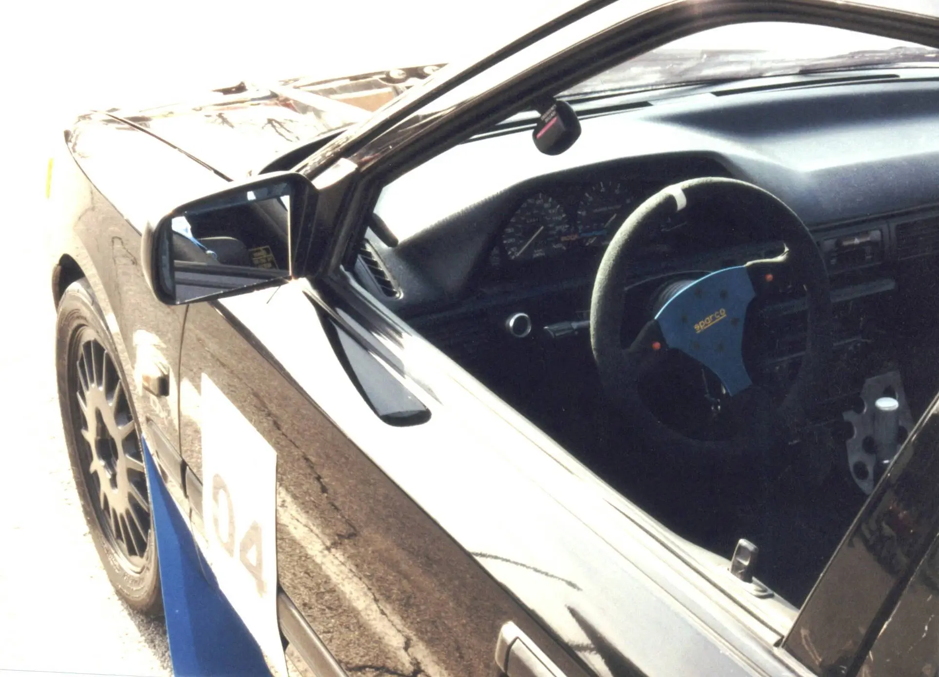

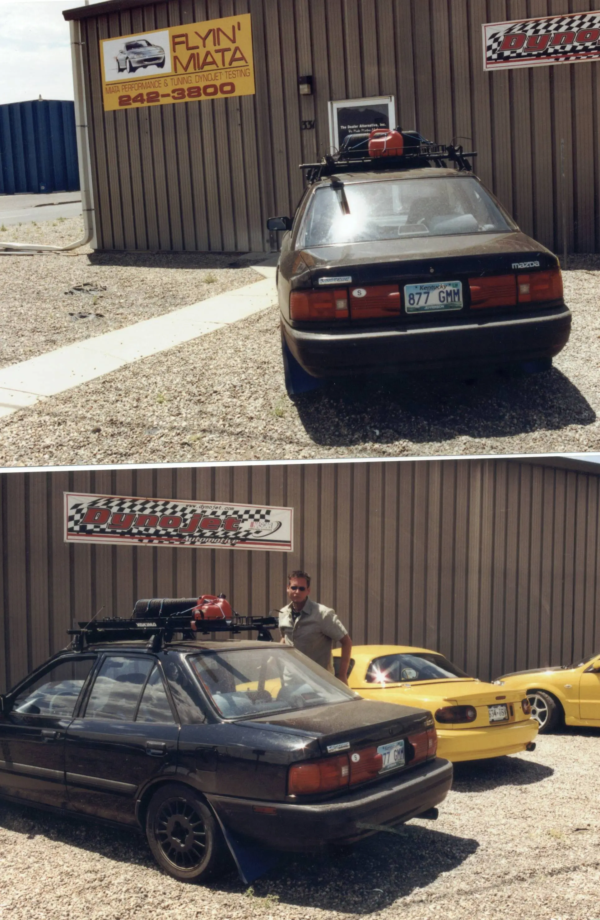

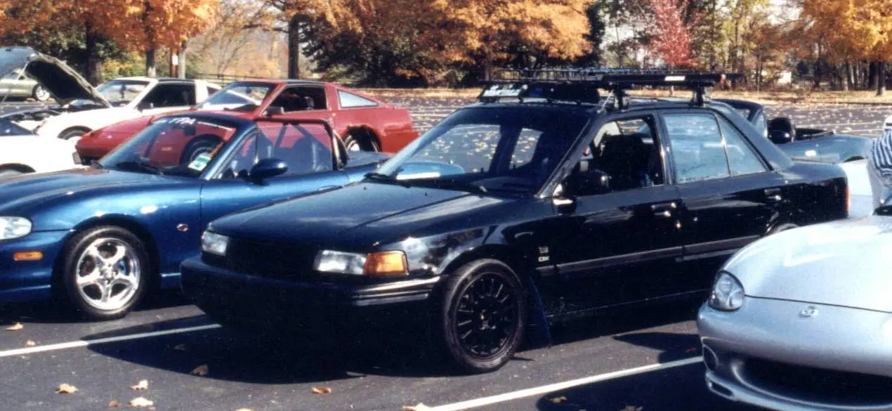

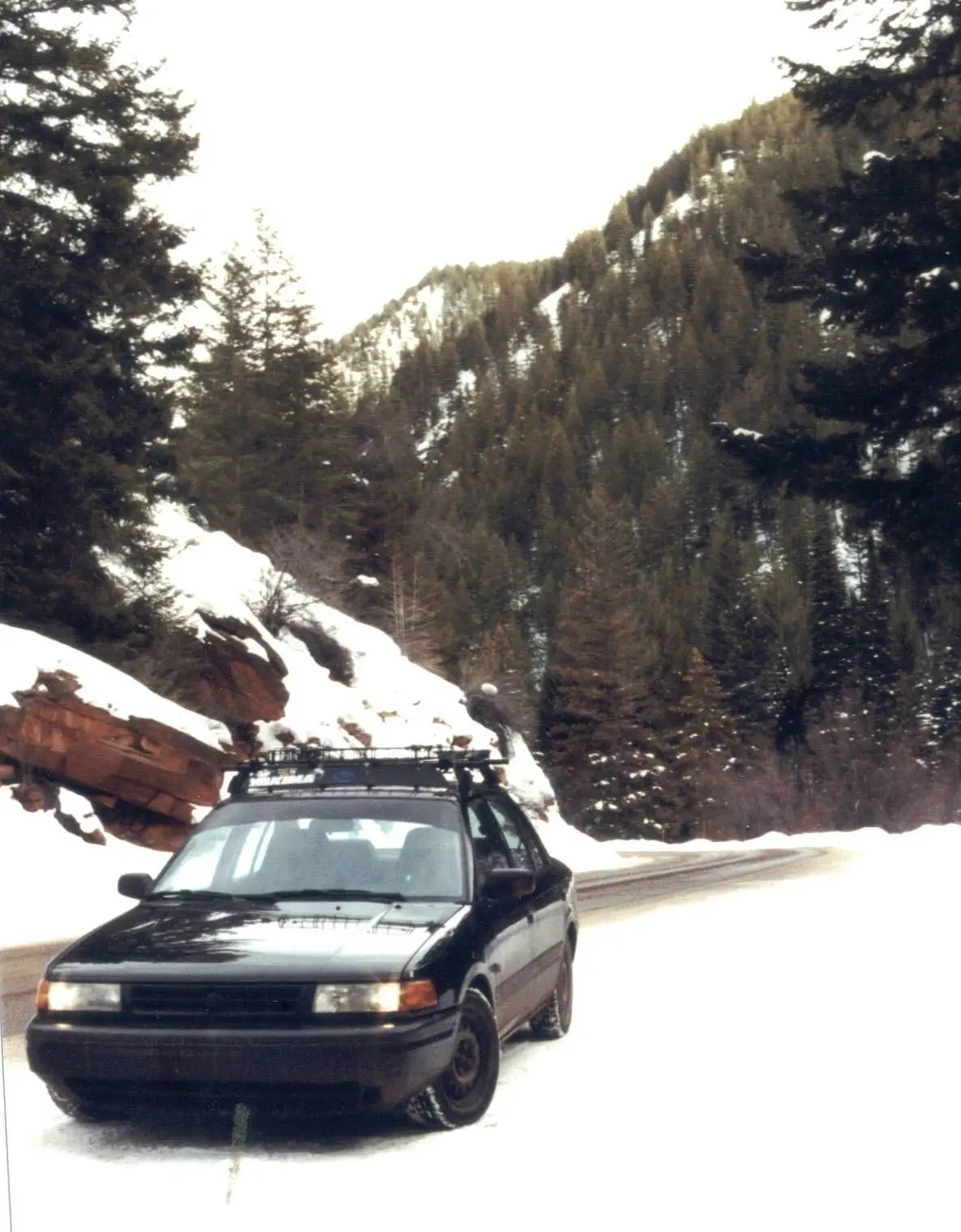

heres some OLD pics of her (enduro rally style bitches)

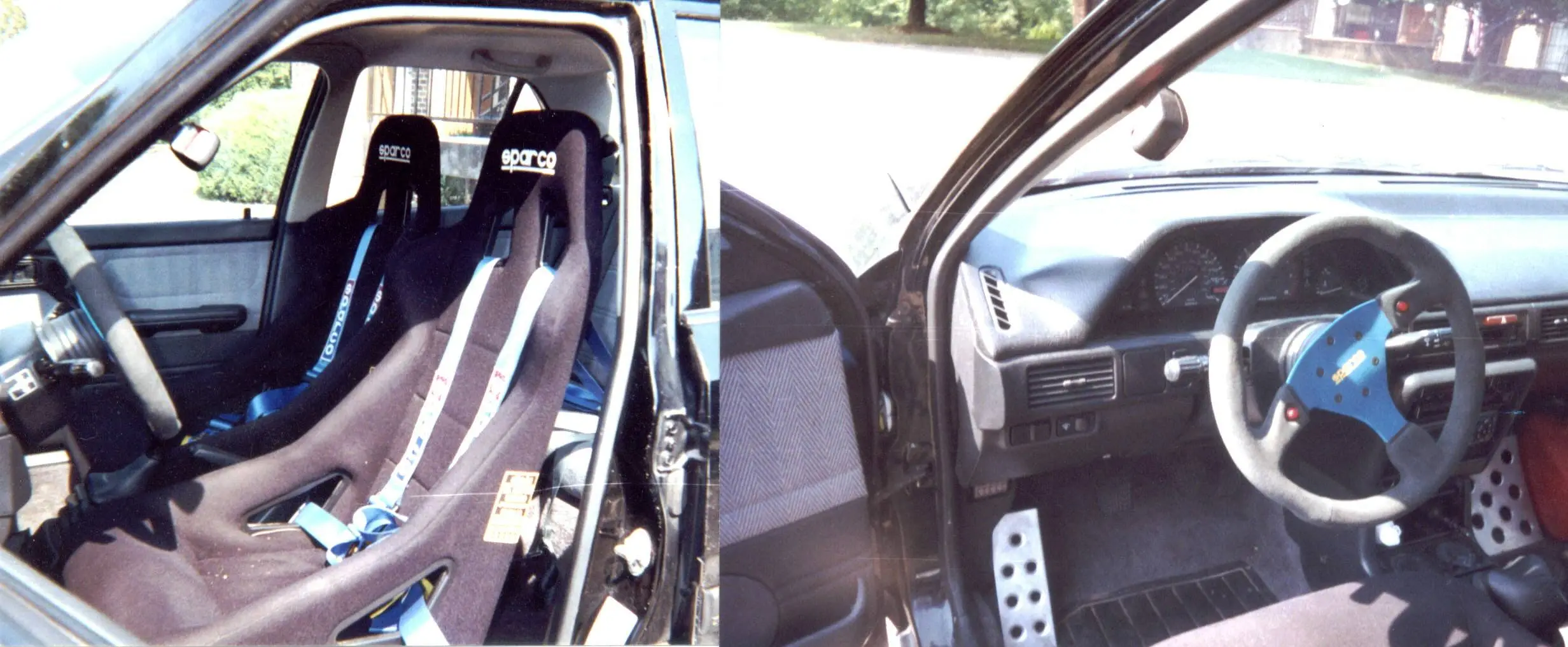

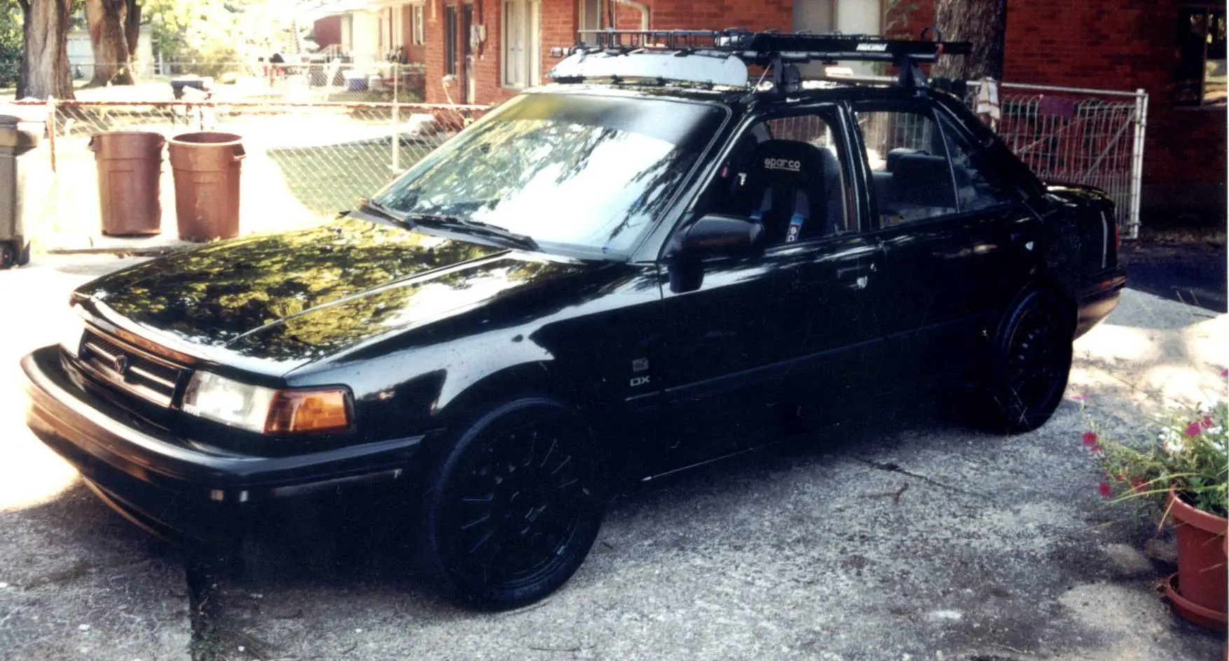

and the interior
