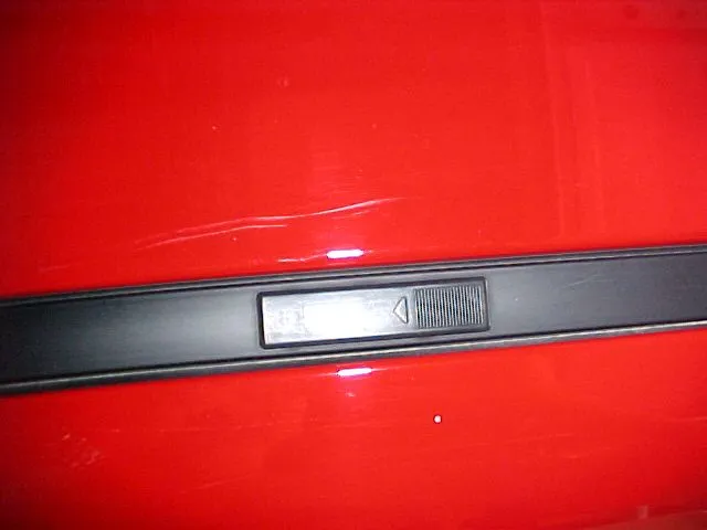

    something like this?
    Attached Images Attached Images
    Sigs are visible only in your first post on a page. To change your thread display preferences, click here and enable 'Always Show Signature'.

    those clips in the jpeg cost 70 bucks each? regardless i just want to take them from the dealership. i ain't payin' nothin more then 3 bucks each..................hahaha..........

    The $70 for the part #'s he provided are for the strips that fill the gap in the top of the car from front to back.
    The picture I provided are my interpretation of what you said:
    "they are on the black strips on the roof of the vehicle, it's about 1" X 3" and has little finger grips and an arrow pointing toward the front of the car."
    I was simply asking if the picture I attached is what you're talking about?
