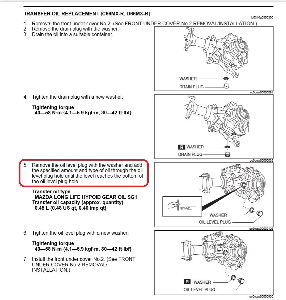

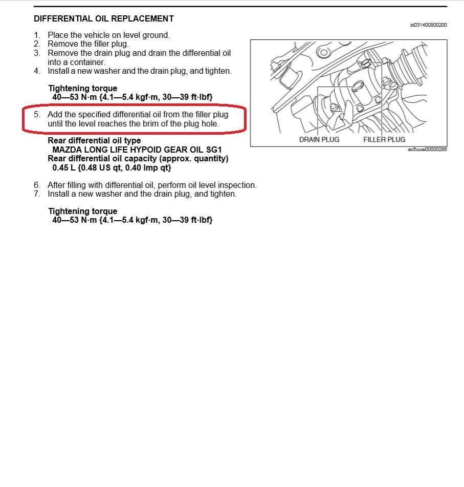

Unfortunately several posted Mazda Factory Workshop Manual page pictures related to gear oil change procedures on front transfer case and real differential are all lost after our server update or Ill re-post here.
Finally found a couple of pdf attachments thanks to our great Anchorman! I converted them to jpg's and here they are:

Just make sure when you follow the procedure, you need 0.75 ~ 0.85 quart gear lube for rear differential than stated 0.48 quart (0.37 quart for gen-2 CX-5).
