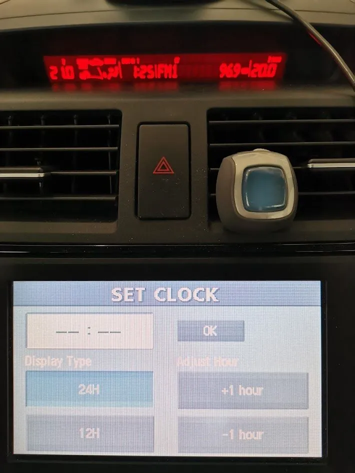

There is no clock on the GPS screen, and the time shown on the red LED panel is incorrect, unless the battery is disconnected and reconnected exactly at 1:00AM or 1:00PM.
Hope to learn more about the temporary fix once I have a copy of the TBS, as the 1:00AM/PM method did not fix all of my issues, see the below picture. The time is grayed out and reads "--:--", meaning the GPS won't sync it. Time shown on the LCD display cannot be set to 12/24 hour mode, cannot adjust timezone changes, more importantly daylight savings time adjustment twice a year.
