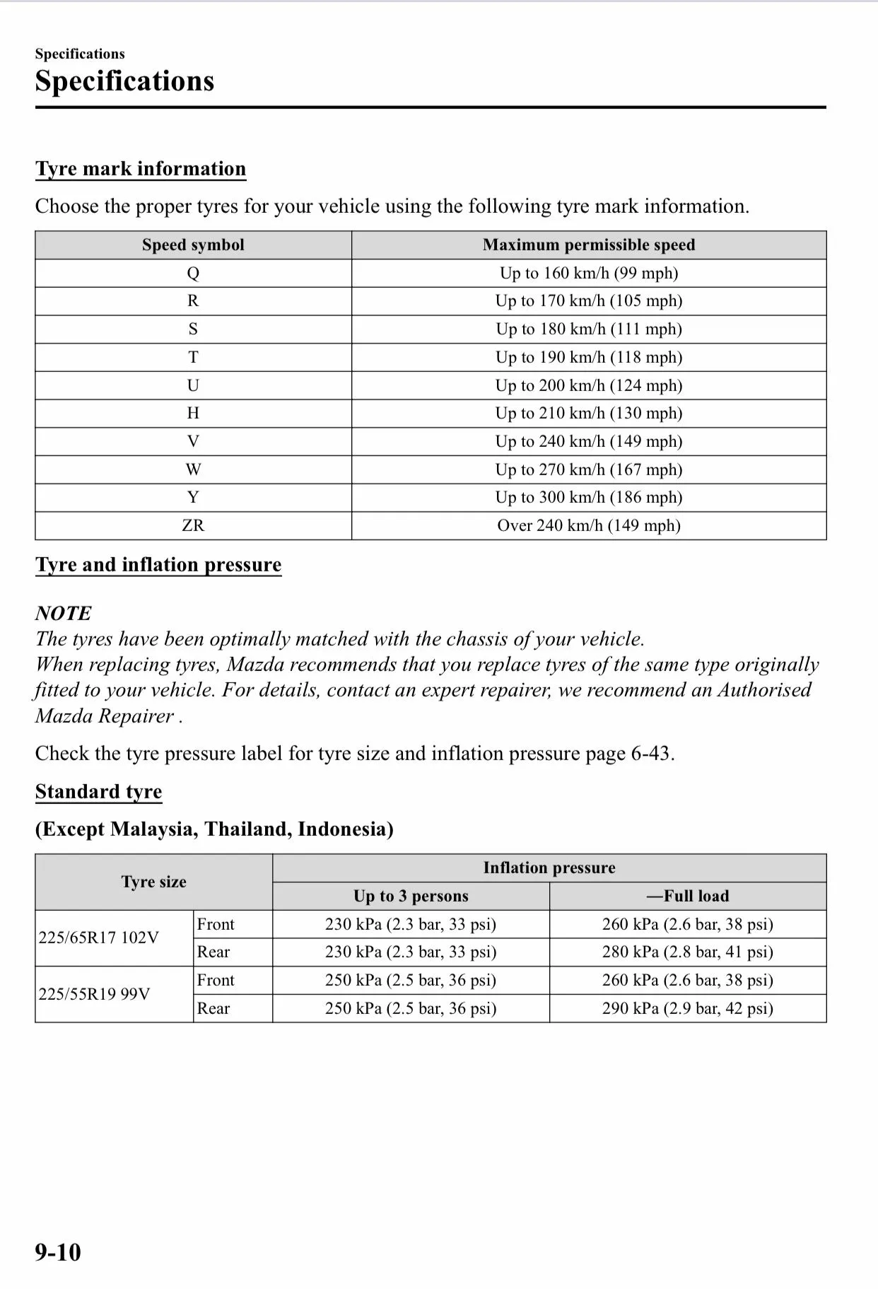

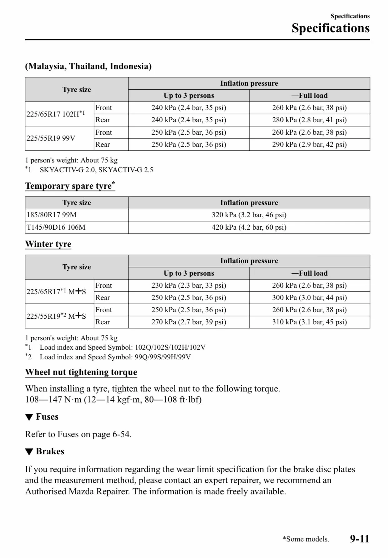

I go with 39 psi cold too for all four 19 tires mainly for even tread wear to maximize the tire life. My experience on one-number-fit-all manufacture recommended tire pressure for US market is its usually a bit too low which wears out the outer sides of tread faster. Tire pressure should be flexible depending on many variables: tire type、brand (design characteristic)、temperature、speed、and load. For those who believe we should follow Mazda recommended tire pressure with 35 psi (36 for gen-1 CX-5) on 19 tires, see the different tire pressure recommendations for CX-5 from UKs 2017 CX-5 Owners Manual with wide range from 36 to 42 psi depending on load. One example even recommends 45 psi on winter tires!

I go with 39 psi cold too for all four 19* tires mainly for even tread wear to maximize the tire life. My experience on one-number-fit-all manufacture recommended tire pressure for US market is it*s usually a bit too low which wears out the outer sides of tread faster. Tire pressure should be flexible depending on many variables: tire type*brand (design characteristic)*temperature*speed*and load. For those who believe we should follow Mazda recommended tire pressure with 35 psi (36 for gen-1 CX-5) on 19* tires, see the different tire pressure recommendations for CX-5 from UK*s 2017 CX-5 Owner*s Manual with wide range from 36 to 42 psi depending on load. One example even recommends 45 psi on winter tires!
