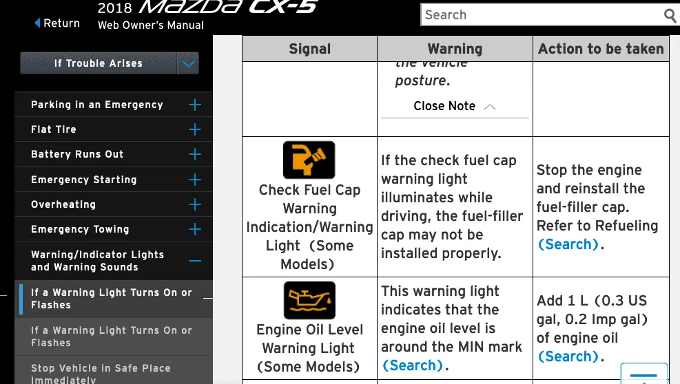

    Here's the light that I saw - I was confused since it was not the low oil pressure light which is RED.
    2018 CX-5 Low Oil Level warning.png The Low Oil Level warning light came on only briefly. Now that I added the remaining oil in the 5 Qt jug, the oil reading is fine - a uniform, thick film right between the Full and Add marks.

    Quote Originally Posted by MyFirstMazda View Post
    If your low oil pressure light is illuminating you will shave years off the life of the engine if not ruin it right away. Did you use an OEM filter?
    See my post at 12:30 pm - it has an attached screenshot of the 2018 CX-5 Owners manual. It was not the low oil pressure warning light.
