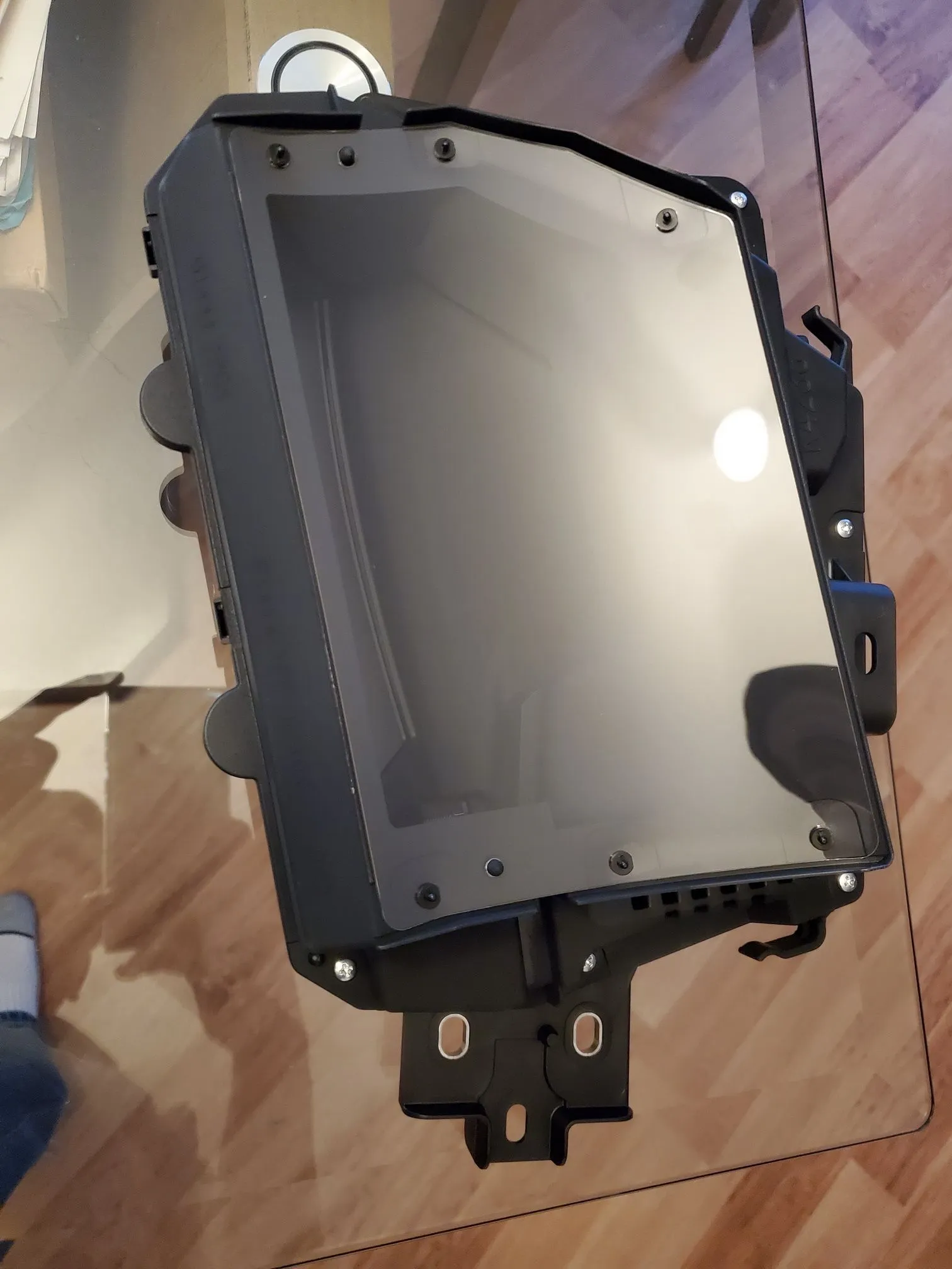

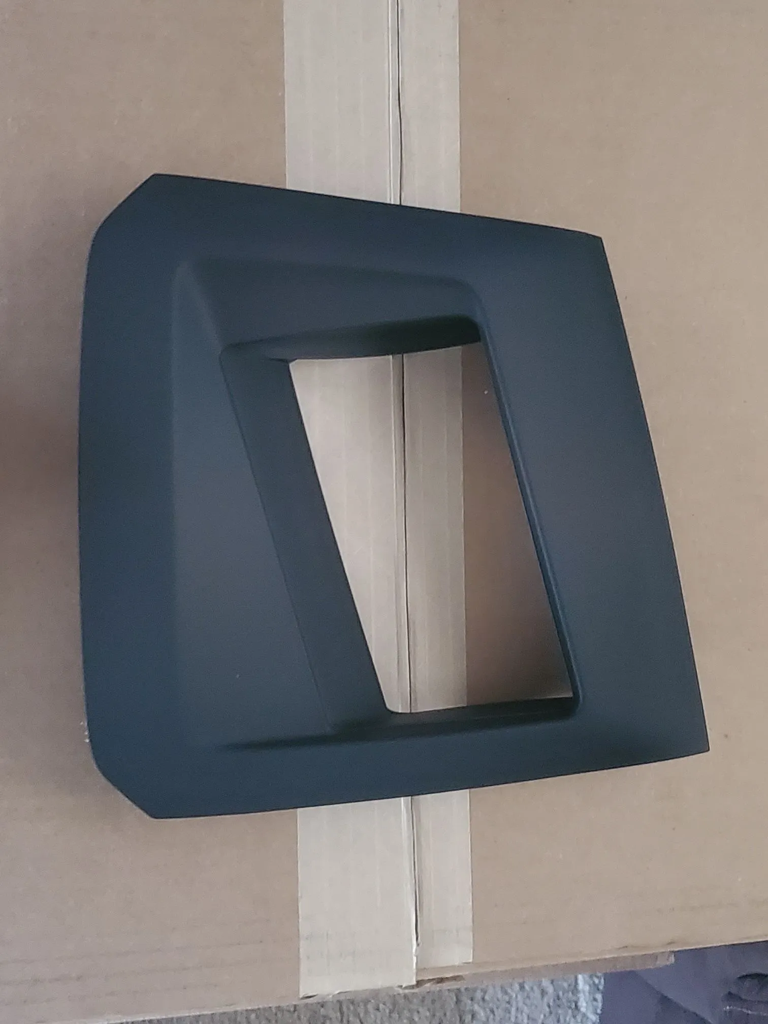

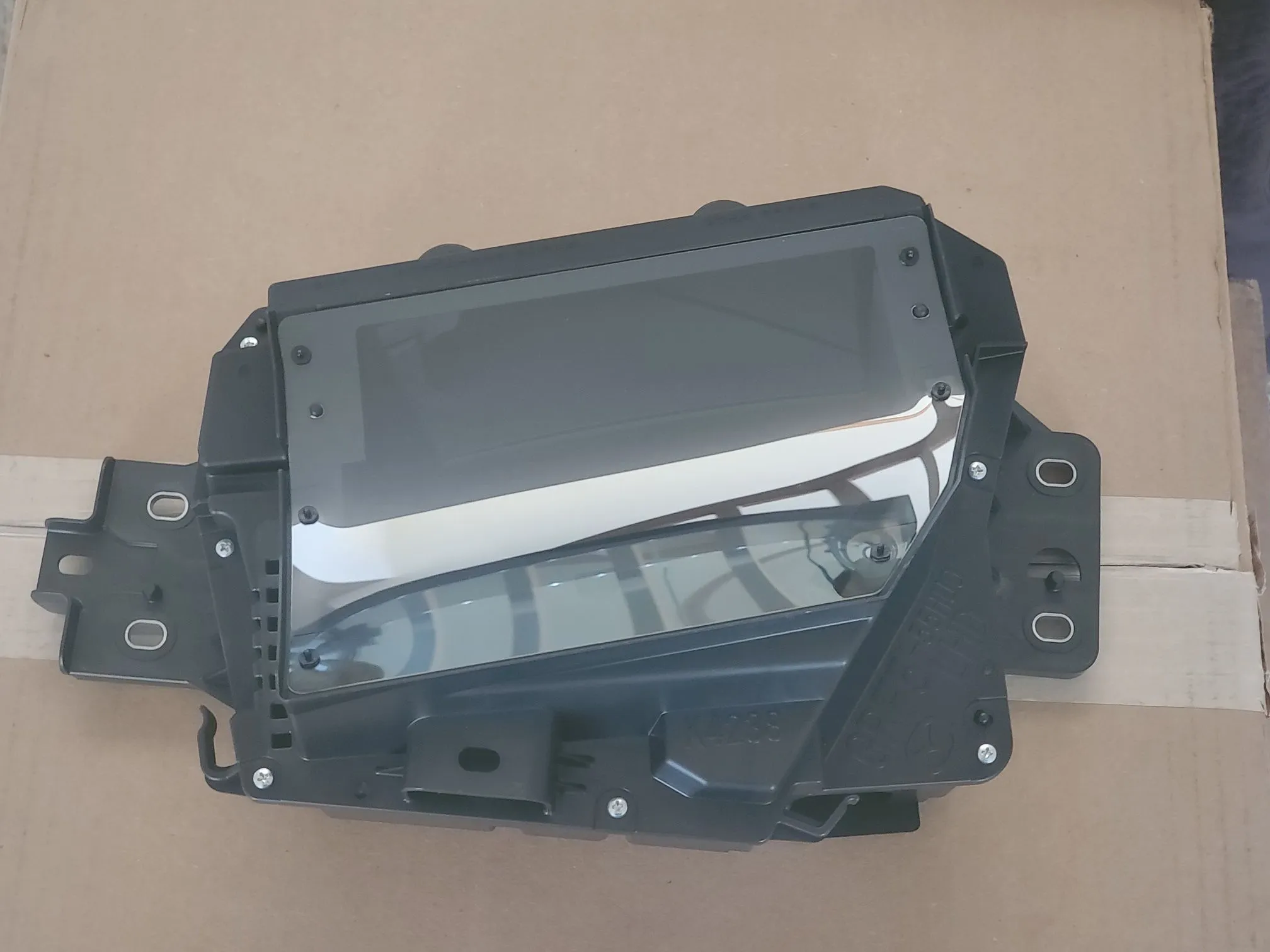

There is two parts needed
GRF5-55-HU0B Display Head Up
GRF5-55-41XA Upper Cover
I made the order and parts will arrive tomorrow.

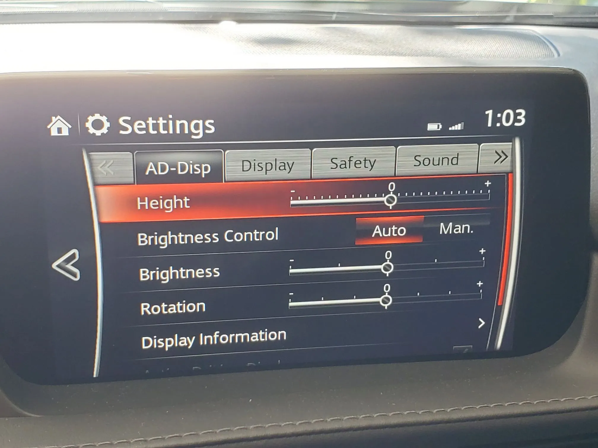

One last thing I need to verify is the control/setting tab on display will show up or not.
What I would expect, the tab would be activated when new part plugged in. Will see!

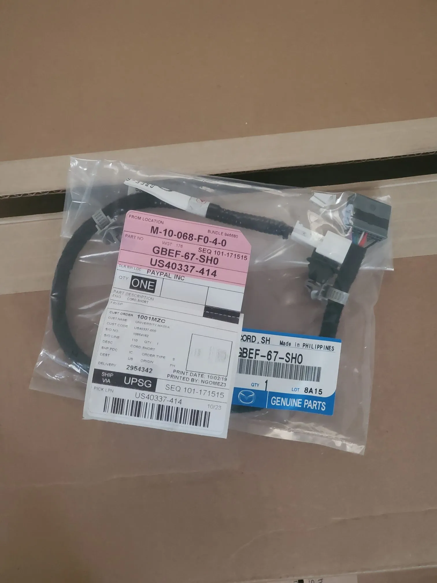

Received parts yesterday but could not install yet because there are 2 additional parts needed.
GBEF-67-SH0 Wire
GRF5-55-225 Lower Cover
I have ordered these parts. Waiting for them to arrive.

All parts cost me total $966.52 to be exact.
What you need:
GBEF-67-SH0 Wire
There is part number for screws but you can buy them from any auto parts store. You need 4.
So, I got all parts I needed. i removed terminal cable from existing connector and plugged the HUD in.
It worked. AP-Disp tab appeared on display when you go to setting. I can see projection from the HUD.
Technically, it is Plug-n-Play but installation is another story.
I get into another issue when it comes to install the HUD. I have tried from bottom and even removed brake pedal assembly, but there was not enough clearance to put the HUD in place.
Also, there is no go from the top without removing instrument panel and cluster. I am researching to find the way to remove them in near future.
