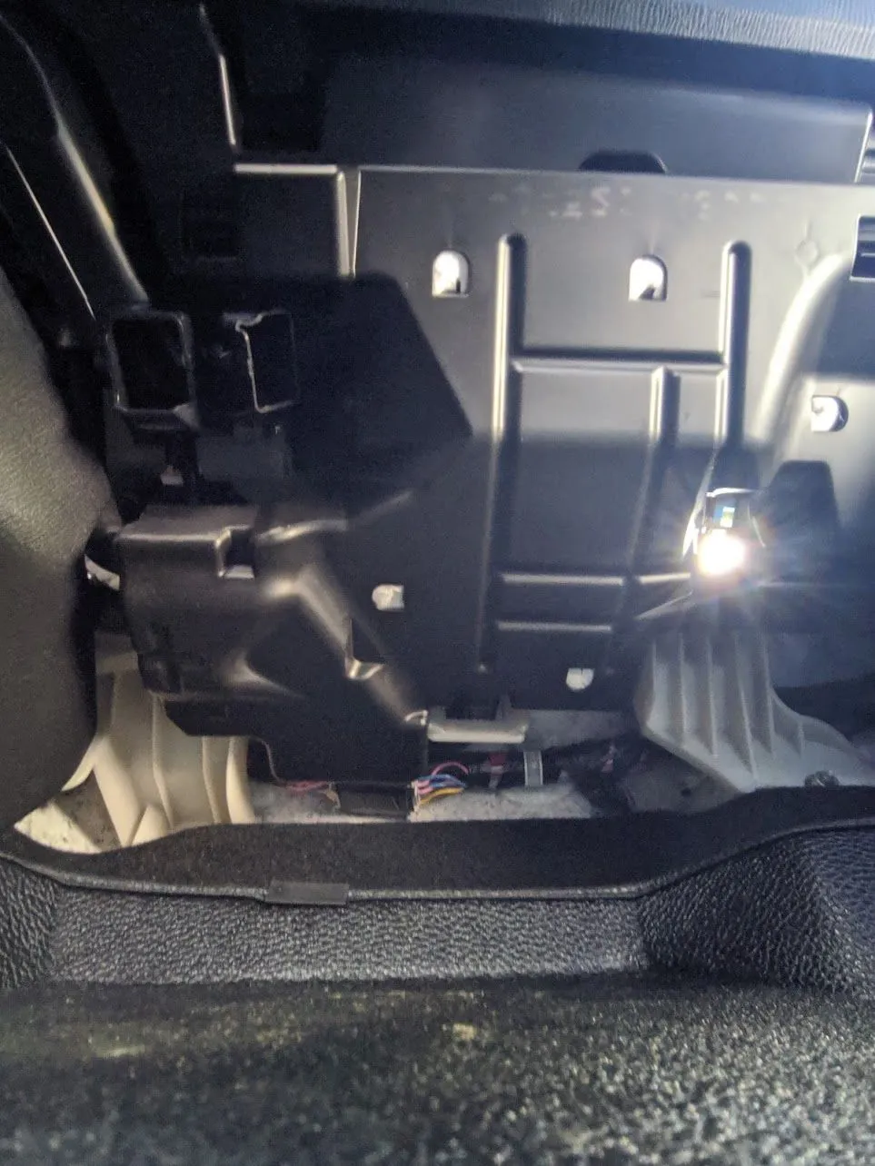

4. Checked underneath the front passenger seat and found a wide white piece of plastic still attached to the bottom of the seat. Moved it around and did not make any noise.

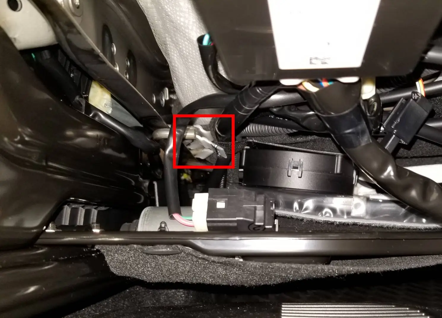

I listened to the latest clip you uploaded and it sounds very close to what I experienced. Double check these two connectors under the passenger seat are in place. In my case, it was the clip behind the one in front. Hope this helps.

I checked underneath the seat again for the white clips. Mine looks different than then photo you posted. I couldn't get a good photo of it. Is it on both the right and left side of the seat?
