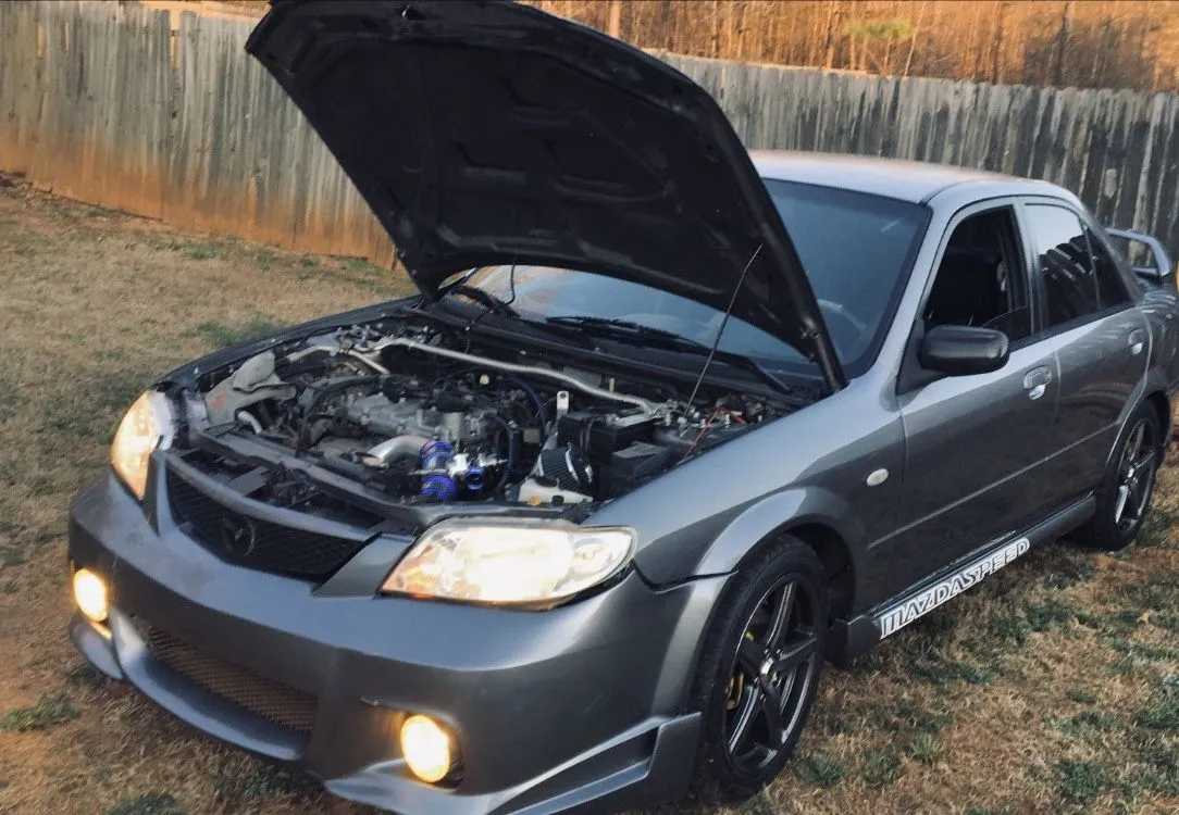

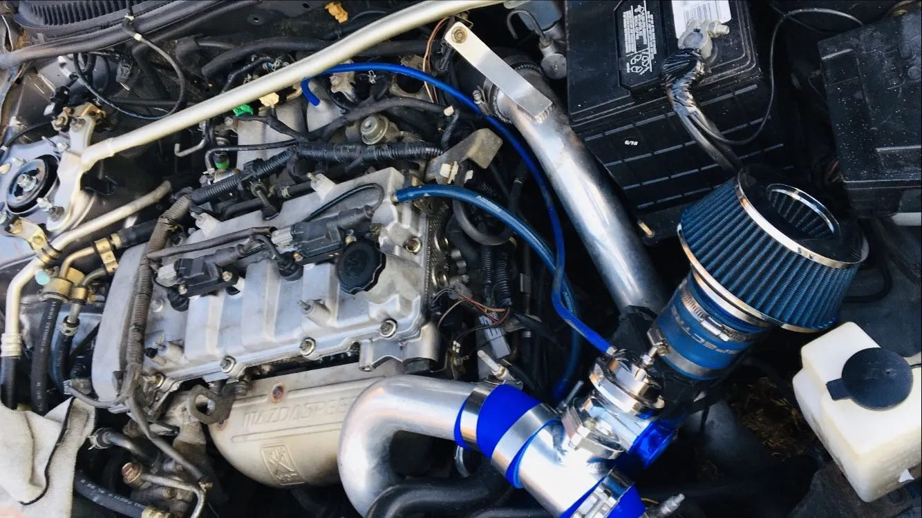

I have a 03.5 Mazda. Mine is 95% original and stock except I did exactly what u want to do. I upgraded all plastic turbo pipes with aluminium brand name pipes that share oem mounting connections and routes. I installed a Greddy Bov and aftermarket wastegate. Upgraded all the turbo vaccum lines. And that basically made the airflow better and the car just became more alive and responsive. And deff more reliable considering the fact that I left the turbo psi rating oem and just allowed the turbo to access the amount of air it ever needed. Next mod is deff front mount intercooler and a custom catch can. And a little longer down the road exhaust
Manifold from a 626. As far as suspension noice just get some custom spring bushings that sit up under the upper springs and check all your control arms bushings and press down on each corner of the car and see if one corner is harder or bouncier then the other. Also on flat surfaces u can always do a quick finger measurements and see if the gap between fender and tire are all the same for the front side and then see if both the rear wheels have same wheel gap. As far as spark plugs I just used the tip of my key and raised the gap a tiny bit on each plug and I’ve never had to replace them for 3 years now. Check all egr,vcs, vics solenoids. They throw codes
Like 0660 0090 03000. And they all share same
Solenoids except 1 3 same 1 diff. Check electrical connections and then the vaccum lines running to and from them. Car will have black smoke and run rich if either
Of those are bad changed all 3 over time for the same issues ur having. Im 95% sure thats issue you’re havin bro. Good luck with the car/ good choice ;) with the
Color. Sexiest color in my book ESP with the gunmetal wheels
