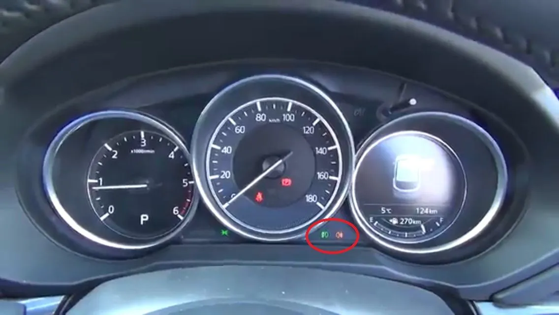

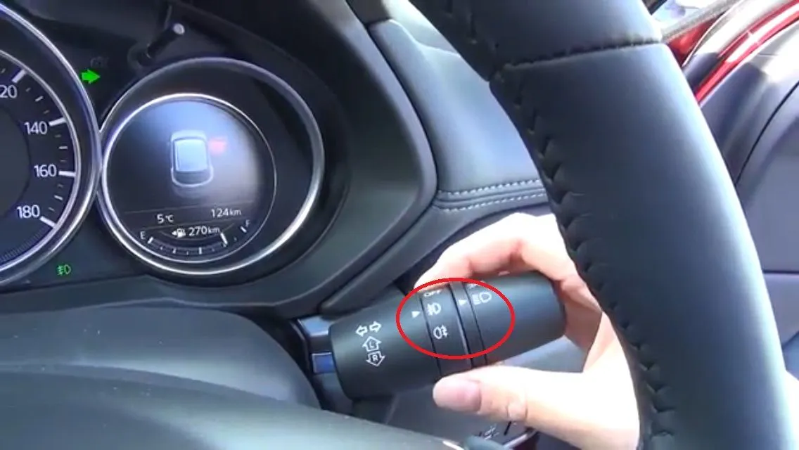

Legally in Europe or other countries when Rear Fog Light is mandatory, you can only have one red bright tail light serving as rear fog light. It'd be on the left side for left-hand drive vehicles such as in Germany; but on the right side for right-had drive vehicles such as in UK. Or you can mount it in the middle, like on Mini, for any countries.
You need different light stalk switch with rear fog position which can only be toggled, so the rear fog has to be turned on manually again for each engine start-up to meet the regulation. The dash front and rear fog indicators are also required by law which are missing for our US CX-5.

And here's new light switch for rear fog mod, but dash fog indicators are too expensive to add.
New fogs and switch installed.
