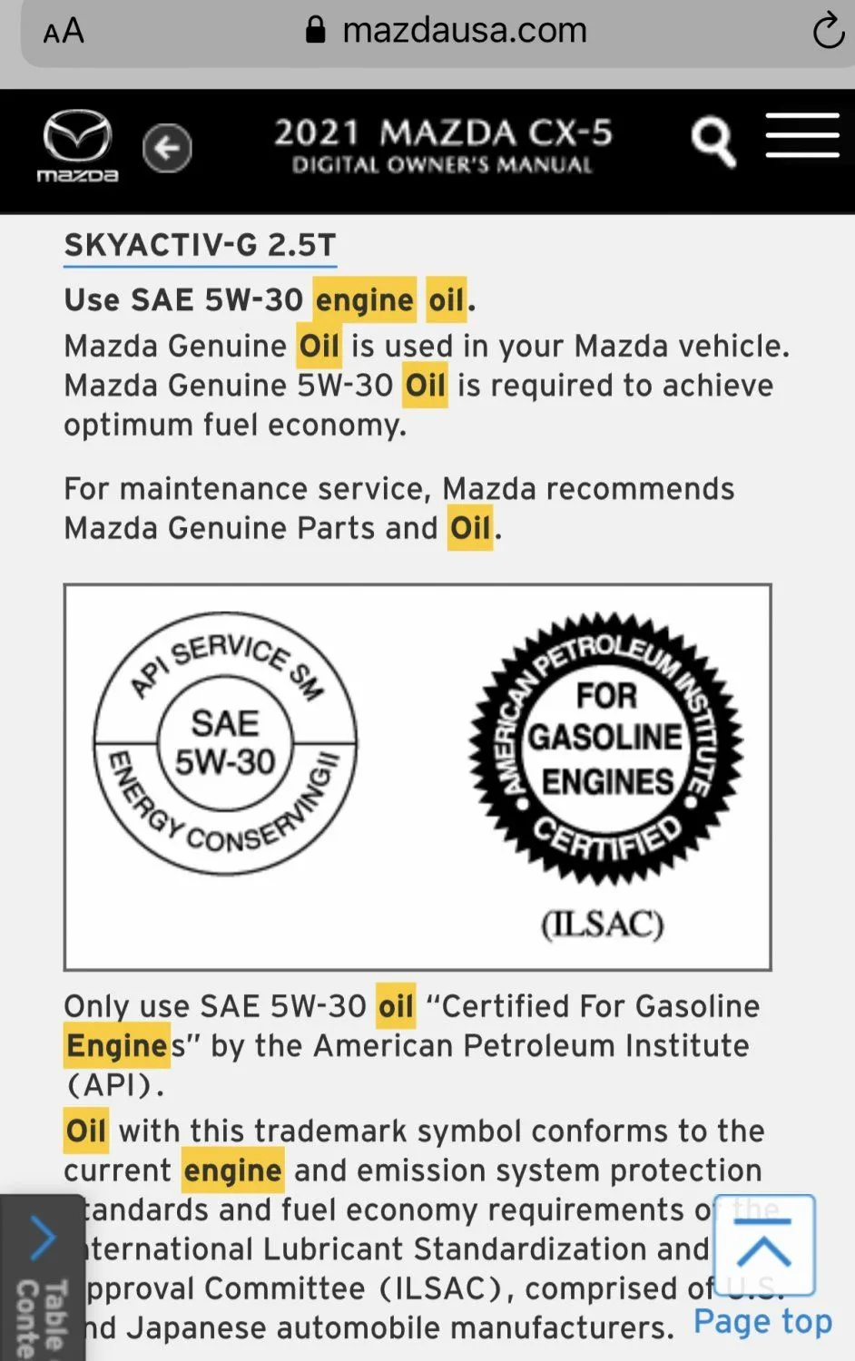

For 2021 CX-5, Mazda doesn’t say Castrol® as one of the recommended engine oils in owner’s manual like it used to be. Between the 2 oils you listed, I personally prefer Castrol Edge 5W-30 full synthetic oil.
Here’s oil recommendation on 2021 CX-5 2.5T for USA and Canada:

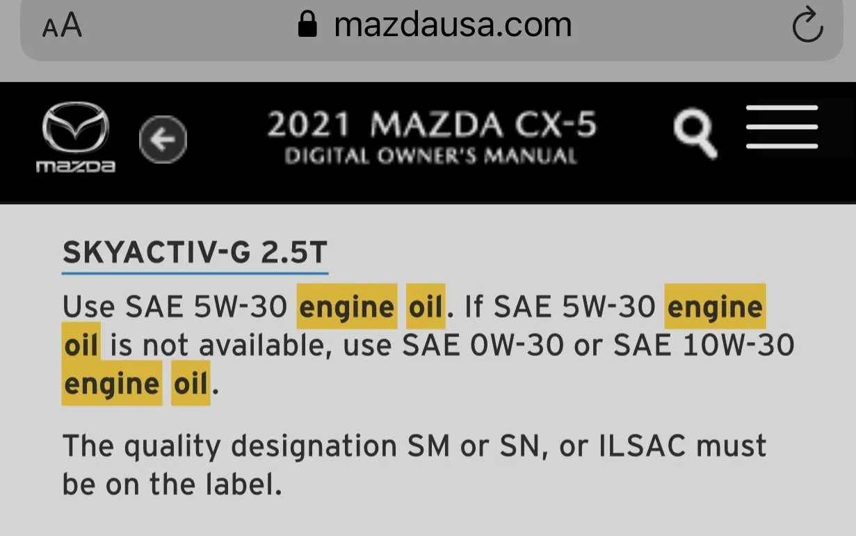

And here’s oil recommendation on 2021 CX-5 2.5T for areas other than USA and Canada:
But I agree with dunhillmc. If I had a 2.5T, Idemitsu SP / GF-6 5W-30 oil would be my top choice.
