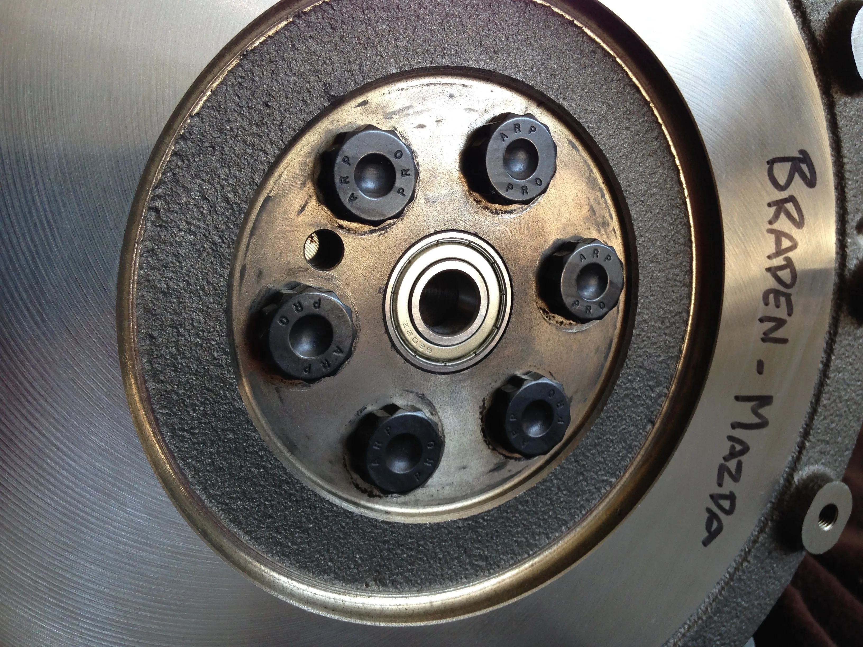

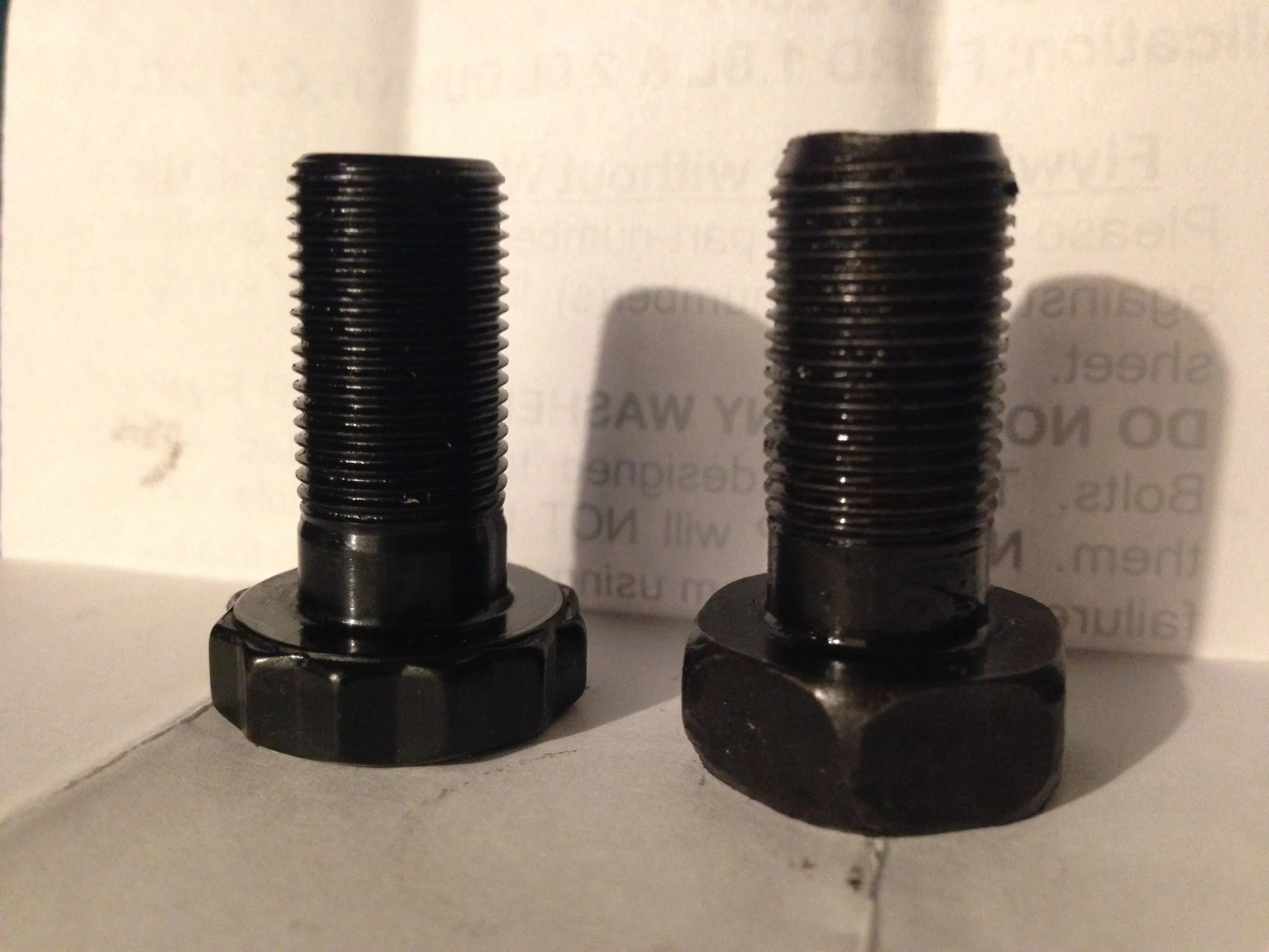

Found some ARP flywheel bolts that are a perfect match for the FS. They're listed for a Ford Duratec but the under head length and thread pitch are the same.

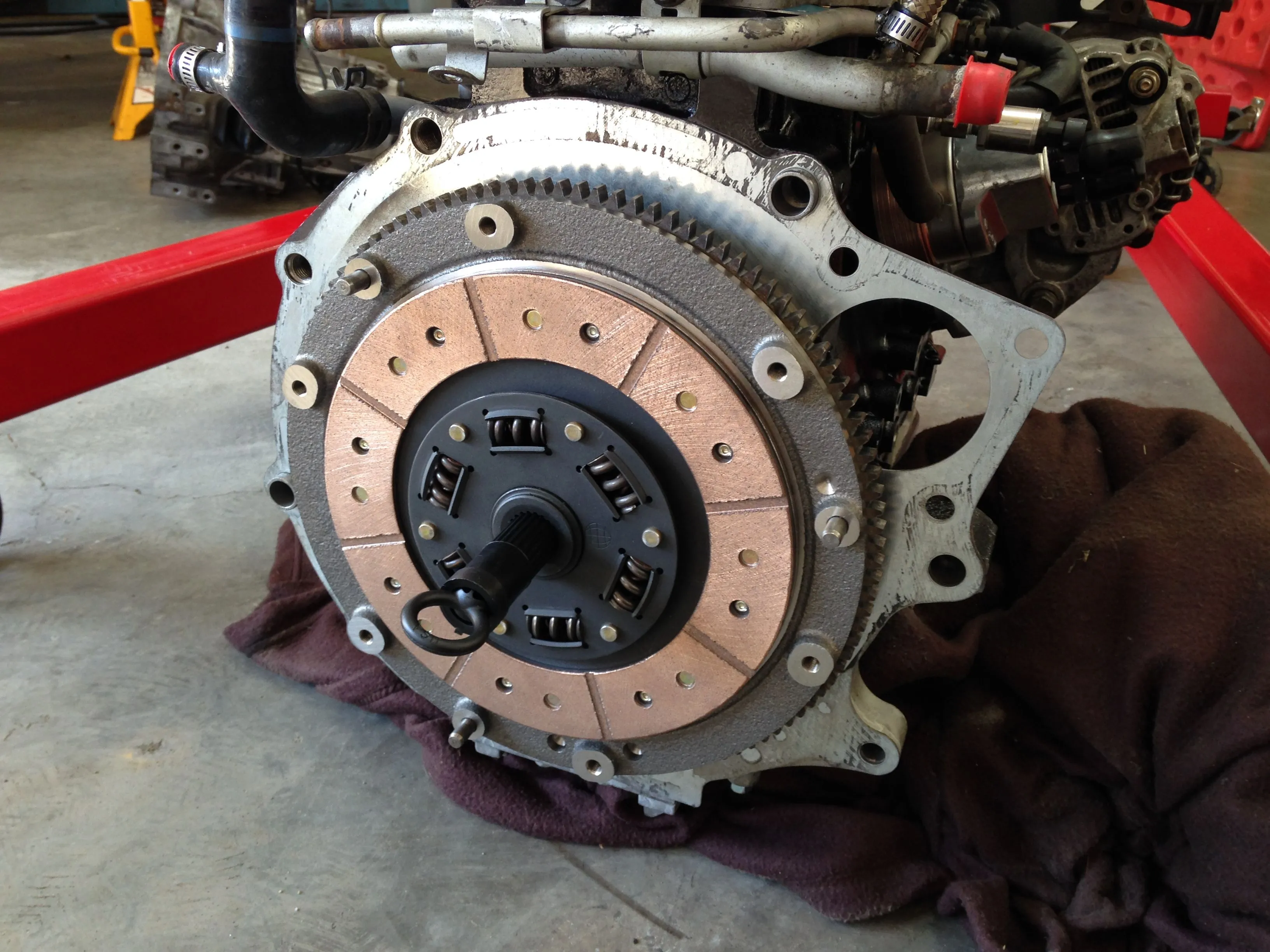

Topped it off with a SPEC Stage 3+ clutch. Hoping this will be a little less harsh over the 6-puck I ran before.
