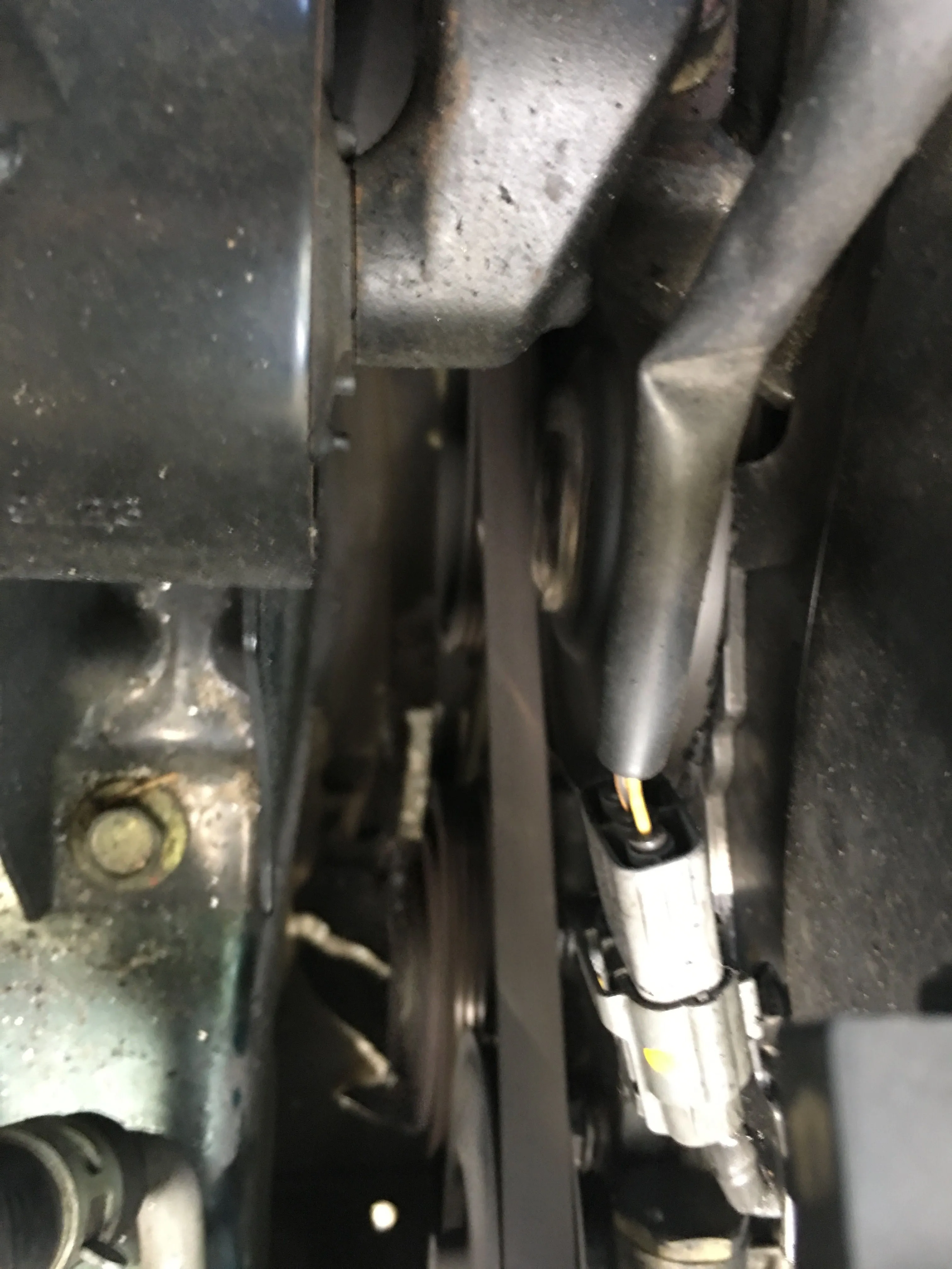

OK so I had a noise every time I engaged the AC switch on in my car. A rattle. It would last 5 or 6 seconds and was intermittent. I drove the car like that for 6 months.
Now the AC does not come on and when I look inside car the AC Clutch was slipping & not engaging but now it does not turn spin at all.
The car is old. 2000 Mazda Protege' DX 1.6. The repair shop wants $1400. to replace compressor. They also just don't replace just the clutch even if the AC compressor itself is still working.
They also told me the car was not safe to drive because metal filings from compressor could fly out and snap the belt that is shared with other components such as power steering.
I pulled both AC fuses as to not turn AC on accidentaly. Question: How dangerous is it to drive without the possibility of the AC coming on, since I pulled both AC fuses?
And please explain. Thanks in advance. I'm not a car guy or 6 months ago I probably could have just repaired the clutch myself as I have seen people do on YouTube.;-)
But what happens if I just leave it the way it is? Do I need to do that?
Am I in danger driving the way it is?
It's already failed. Even though the AC cannot come on? I pulled the Fuses.
So No possibility of AC compressor coming on or clutch becoming engaged.
A shop wants between $200 & $300. to Bypass.
I'm almost positive you can just unplug (or cut) the wire powering the AC clutch and then it will never be able to engage.
When it's not engaged it just idles on a bearing.
The pulled fuses should do the trick but cutting the wire makes sure.

You can't see in the photo but the 3 big nodules that stick out from the clutch plate cover are pretty much chewed up.
I can get a better photo so you can see.

With 5057 Posts I'm sure you help a lot of people. Thanks again. I'll try to take a picture of the 3 tore up nubs on the Clutch cover plate just so you can see how bad it is.
