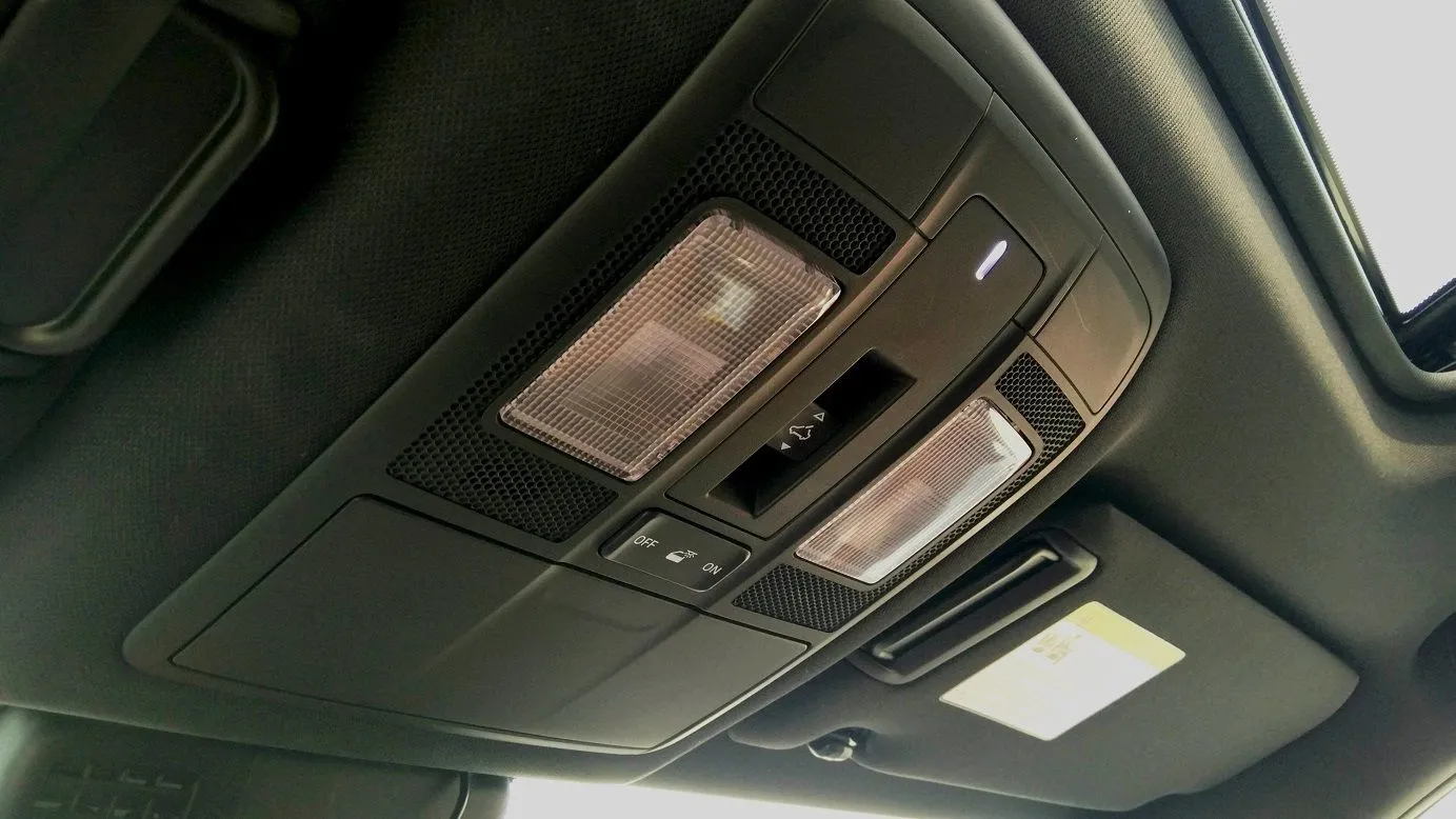

    So I took a picture of the overhead map lights. How do I pry the lens open to change the bulb? It looks like its permanent.
    Attached Images Attached Images

    The pry points from the 2019 owner's manual at Mazda USA is at: https://imgur.com/a/TgYsXLt
    Is yours a US model?

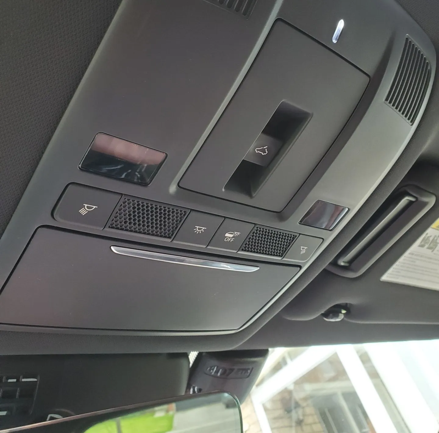

    Interesting. It looks like there are two different overhead consoles for 2019 models, Type A and Type B.
    Trixstar's (Type A)
    Mine, a 2018 Signature (Type B)
    I think I prefer the look of the 2019 over the 2018, so nice job Mazda. Unfortunately it looks like the Type A console has integrated LEDs instead of LED bulbs. Here's what the manual says:
    "The LED bulb cannot be replaced as a single unit because it is an integrated unit.
    The LED bulb has to be replaced with the unit. We recommend an Authorised Mazda Repairer when the replacement is necessary."
