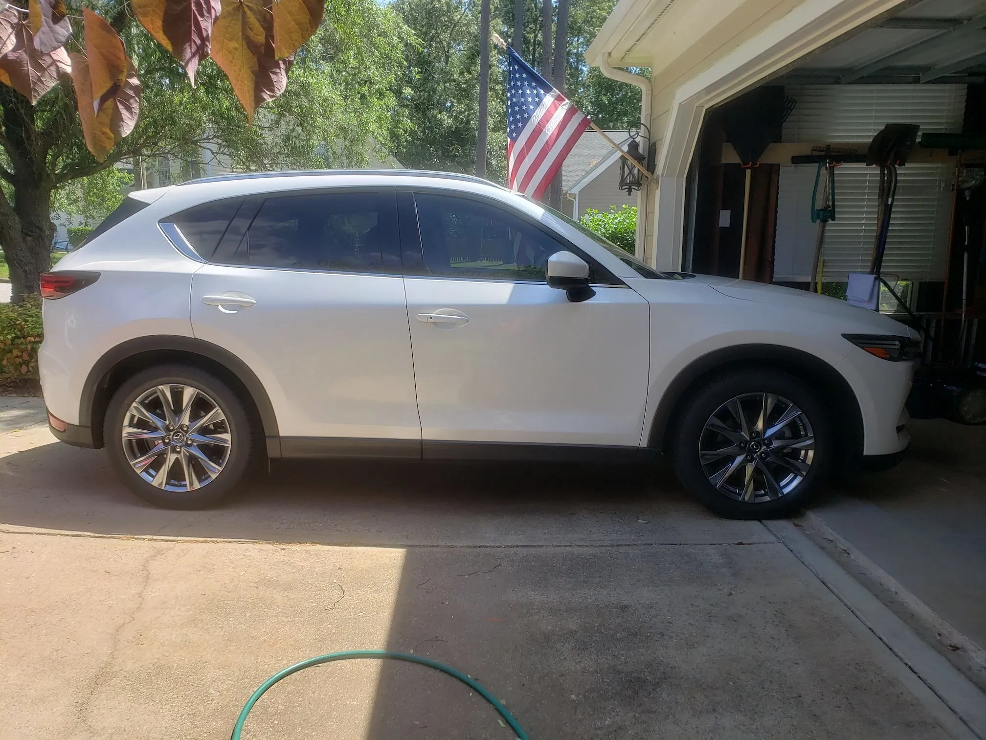

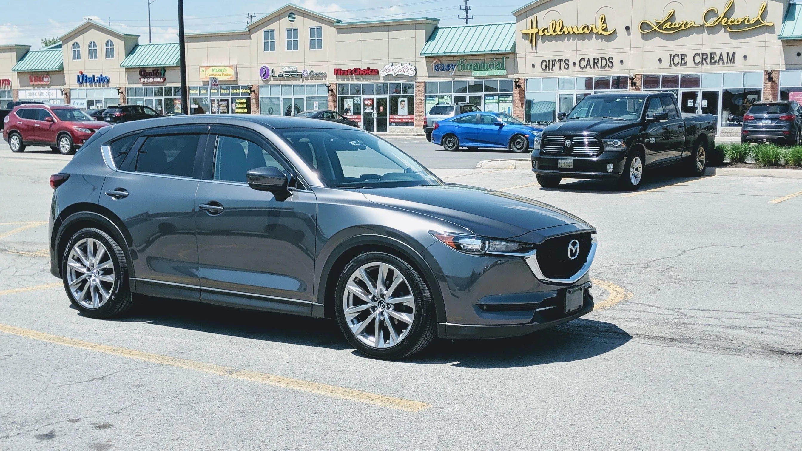

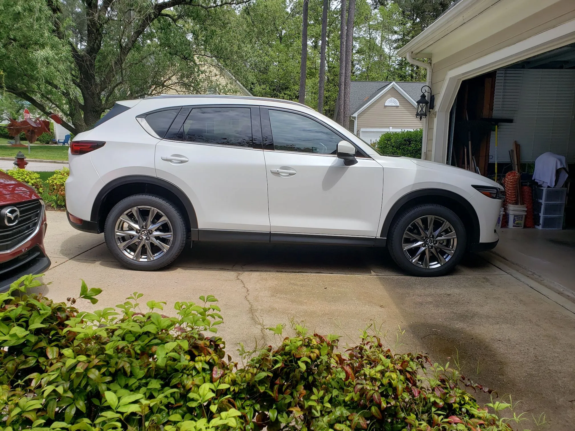

Been cruising the forum a while considering mildly lowering my 2019 Sig CX5. After hearing reviews by the rather small sample size of pioneers on this forum, I went with the Eibach Pro-Kit. Result=LOVE IT!! Visually=just what I was hoping for. Handling=just what I was hoping for. Ride/comfort= not much noticeable difference from stock. Only had about 1000 miles prior to modification but had a 2016 also so I know what the stock ride feels like. I've put about 1000 miles since the Eibach upgrade and just slightly stiffer, but just slightly.
Moral of the story, go for it. Won't regret it. My first post ever and I'm loading pictures so pray for me.

Stiffer wasn't meant to mean better. just stiffer. As in not as soft over bumps, through pot holes. A little more to the sporty side and less Lincoln town car like. Behaves= flatter on curves, less body roll as you would expect with a vehicle that's lower to the ground. I'll rarely benefit from the improved handling as I drive fairly conservatively. I thought it was worth mentioning for those looking for the improved driving experience as opposed to myself who was mostly interested in the aesthetics.
