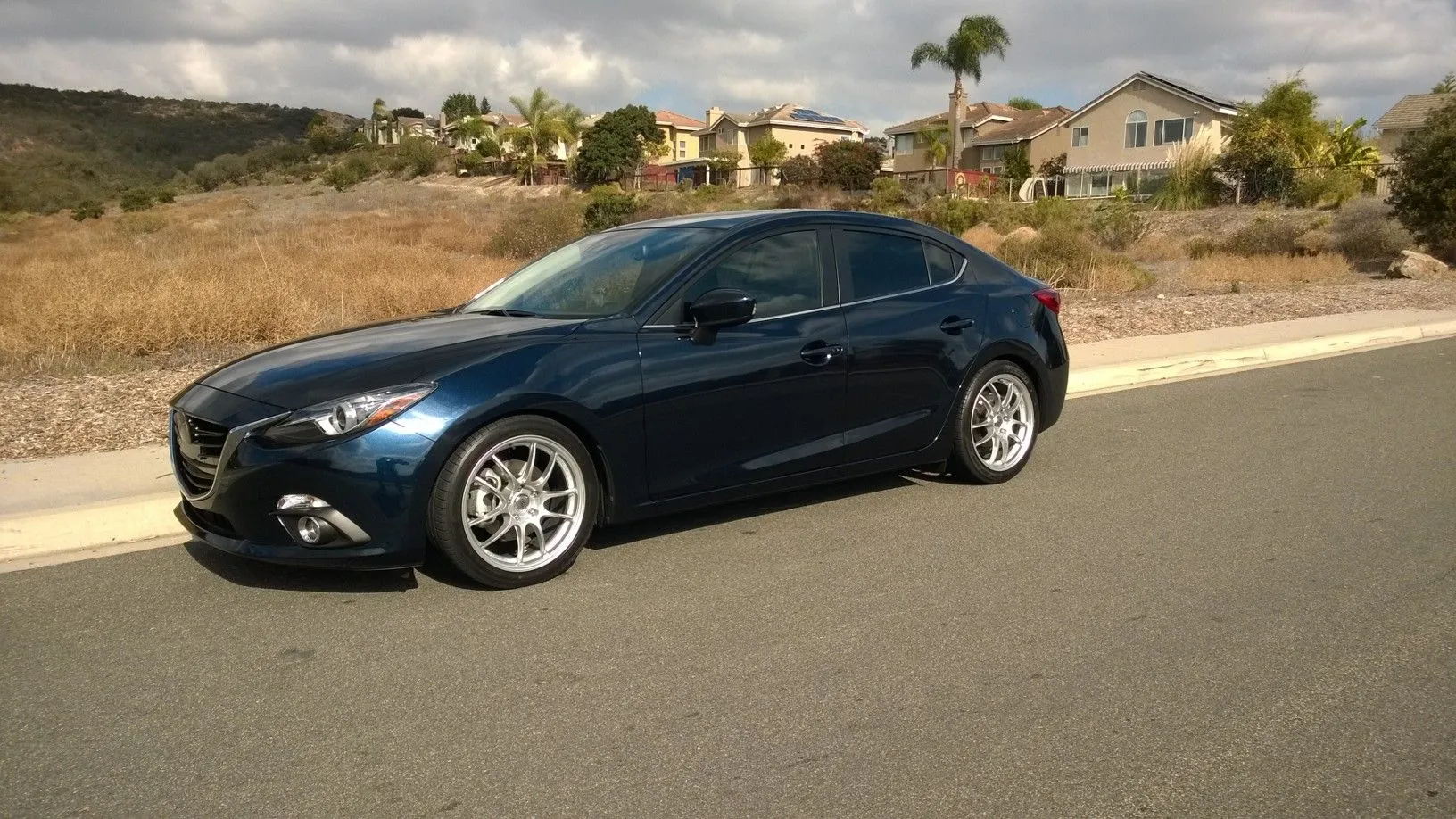

Looks: The lowered stance of my 3 stands out compared to most other 3s on the road. The Enkei Racing wheels provide high contrast to the 3's deep blue color.

Have those Enkeis been durable? I'm considering them for my 6, but want to make sure I don't get something that will bend more easily than factory Mazda wheels. The roads here aren't terrible, but they're subject to the same broken bits as roads elsewhere. Plus, I have need of driving on gravel roads, too.
I answered your PM, also with more details but yes, the Enkeis are more dense than most non-forged wheels, so they have been very durable, even when I bumped the rear into a curb. I was always very impressed with their quality - worth every penny.
Sounds like a really fun car!! Have you had to change any other suspension components, or is everything else OEM? Also, are you running a custom toe/camber alignment, or is everything aligned to factory specs?
When I had the Eibach springs installed, I think shorter bump stops were included but I'm not positive about that. Koni Yellow front-adjustable shocks were also installed at the same time. They feel a bit tighter than the OEM shocks. Good question about the alignment - that was done at the same shop, after the install of the springs and shocks. The receipt stated "custom alignment" so I believe it was not OEM. Total labor charge to install everything + alignment was $360 - not bad IMO.
My 3 handles somewhat like a Mitsu Evolution of fame. I know a coworker in Malaysia that has one and the ride and handling are similar. Of course, his Evo is cranking out 400 HP at the wheels so acceleration between our cars is a bit different. :D
