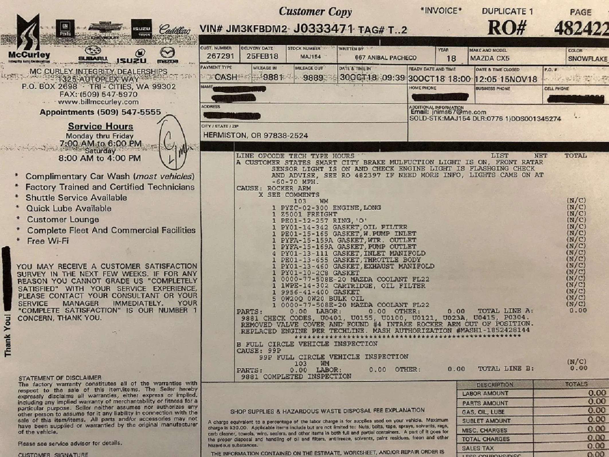

Here is my Service report from them changing my engine
hopefully you guys can open that so all of you doubters out there will understand this is not a joke. I sincerely hope none of you have to experience this. I can't emphasize enough how important this is. You may be driving around with this problem as we speak. the only way you will know is if you get the RPMs high enough and maintain them for a bit. If the rocker is off your car will go into limp mode. They will need to reflash your PCM to the correct logic and obviously address your engine issue.
Thank you to all of you out there who have been believing me and backing me up.
