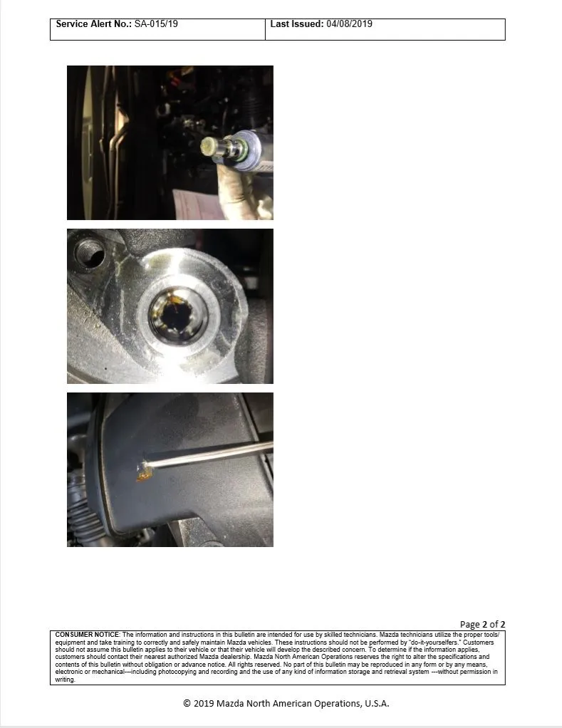

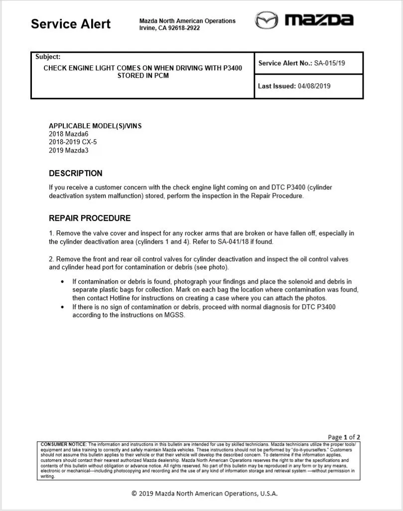

Based on the Service Alert Mazda submitted to NHTSA, the problem does include 2019 CX-5:
attachment.php
attachment.php

Note the reference to SA-041/18 in the above under Repair Procedure in the event of discovered broken/dislocated rocker arms.
Here it is on the NHTSA website. It outlines the steps the mechanic/dealer is to take.

The 2019's can have the issue, it is the same motor. The software update is so the check engine light won't go on. That is what they did to jjm86m's car after his went into limp mode and the lights went on. After they did the software update he no longer got a check engine light and he continued to drive the car. Then after seeing this thread he insisted that they check the valves and low and behold the rocker arm assembly was off.
I think that if you can accelerate fine and drive 80mph a few times without your car going into limp mode, your car is not one of the ones affected with the problem. I wouldn't be surprised if there was more wrong with the affected engines because the 'fix' is installing a new engine instead of replacing the rocker, which would be much cheaper to do.

Agreed. MyFirstMazda said it correctly that PCM software update is to not only raise the oil pressure in HLA like Mazda claimed, but also make CEL won't turn on even thought the rocker arm is laying down there based on jjm86m's experience. I believe this only masks the problem, and also indicates Mazda may not know why and how the problem happens. Yeah, if the problem can be resolved by simply raising the oil pressure, Mazda can also easily replace the fallen rocker arm back into the position and not to replace the entire engine which definitely is a lot more expensive.
