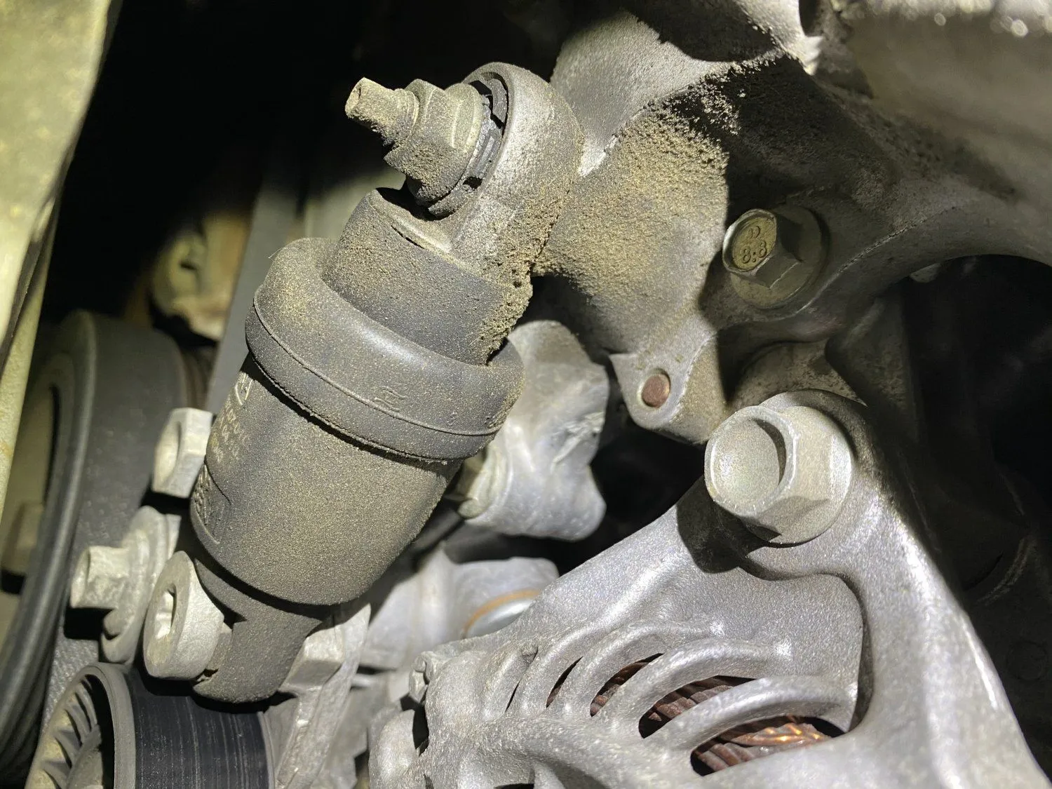

View attachment 233139 that's how leak is looking. I'll check the other thread mentioned above.
