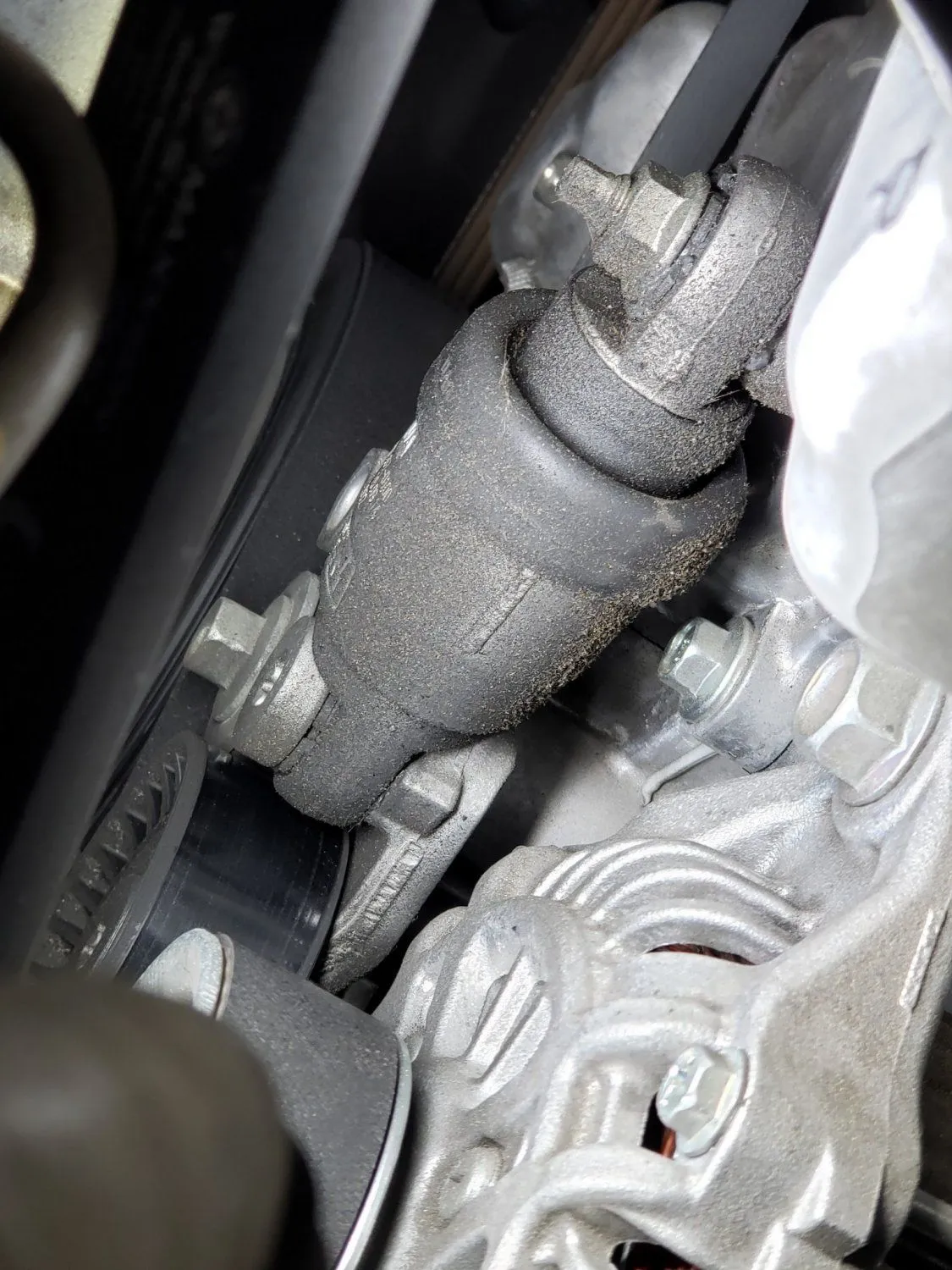

that's how leak is looking. I'll check the other thread mentioned above.
View attachment 233139 that's how leak is looking. I'll check the other thread mentioned above.
Yes, it’s leaking ⋯ :(

TSB 01-019/19: OIL LEAKAGE FROM DRIVE BELT AUTO TENSIONER AND RATTLE NOISE FROM ENGINE COMPARTMENT
Description:
Some vehicles may exhibit oil leakage from the drive belt auto tensioner and rattling noises from the engine compartment. This may be caused by insufficient sealing at the drive belt auto tensioner damper when the auto tensioner fully operates under both high ambient temperature and high load conditions. To eliminate this concern, the shape of the drive belt auto tensioner damper has been changed.”

From that picture, it looks like they leak from the top of the boot. If it is not under warranty and you are going to change it yourself you can probably wait for nicer weather if it isn't making noise. It doesn't look like it leaked that much yet.
No, just looks like a little seepage,not even a real leak.I'd just wipe it off and check occasionally.

Of my 3 Mazdas ('14 M3, '16 M6, and '17 CX5), the Mazda6 showed the oil stains like the pic above, and even on the generator (I wonder why). I cleaned it up completely. I have not seen any sign of leak for more than 6 months. I will keep it under regular check.
Once something is leaking it’ll keep leaking until the fluid is below the threshold making the leakage or the fluid is almost running dry. My leaky tensioner will be replaced soon but not in a hurry. In the mean time I’m waiting for a recall happening if we’re lucky like the problematic LED DRLs on ‘16 CX-5.
But, I have not seen any sign of leak for 6 months after cleanup. I check it every weekend.
