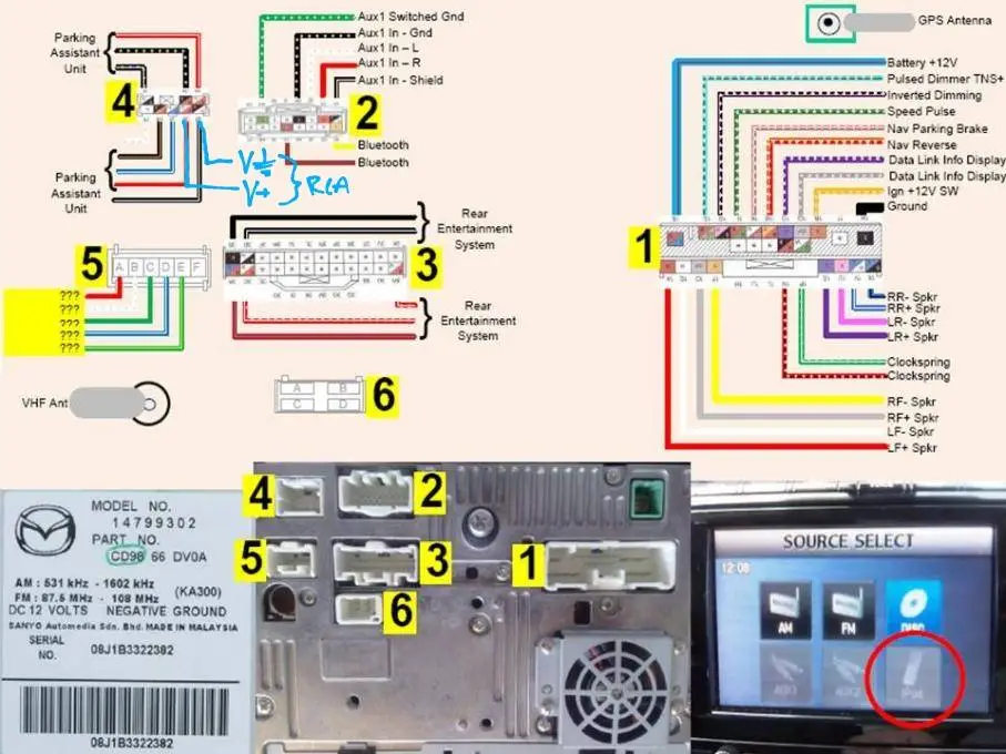

    Hello forum
    I've searched for days to find something about how to reuse the factory reverse camera with an aftermarket head unit but not found anything.
    Can it be done?
    Or rather, how is it done?
    Thank you

    It can be done. A camera is nothing more then video feed + ground and a power/trigger. I have no experience with the OEM Navi unit but I*m 99.99% sure the connector is a clip type. OEM does not use RCA bc it technically is not secure from vibrations. Great for home use but not auto. Aftermarket stuff uses RCA bc it is universal. So, you will likely need to clip off and solder a RCA end to connect it to the aftermarket radio and splice in the power/trigger. It is unlikely you are going to remove camera to solder RCA end so be careful working in the cabin.
    OR, it is also likely Mazda reuses the same connector for other Mazda products so you can look into, say Mazda CX_ converter cable. 1st step you need to do is remove the radio to see what it looks like.
    Google image *mazda5 radio pin out*

    Thanks for the help. Here is a pic of the back of the head unit. Lots of extra cables from this thing...
    I'm not sure which is the camera feed though. Or how the reverse action works. I'll look into the CX adapter.

    Take off the hatch door panel, lift the weather cover, and see if you can identify the backup camera's wiring color code. This will give you a head start on what to look for at the back of the headunit. Btw, can you post a pic of the top of the headunit casing to see who makes it?
    Reverse engineer below (remove space). Has reference to back-up cam pin out and convertible cable. Looks like the OEM camera is 6V so you may need a step down converter if the aftermarket radio supplies 12V or you want to tap into a different 12V source.
    https://forum .mazda6club.com/electrical-hvac-lighting-audio/384361-how-install-backup-camera-bose-navigation-system.html

    Thanks. Yes here's a pic, doesn't say much...

    Oh, Sanyo. I didn't know they even made car equipment.
