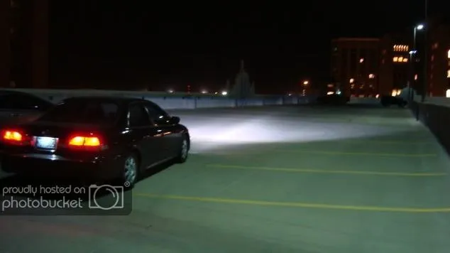

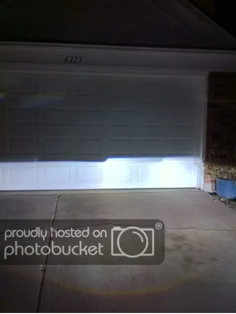

Here's a couple of example photos from someone with the same car and setup:
attachment.php
attachment.php
So would that be better to look at than LEDs? Or same issue.
I'd say the output would be more "predictable", as in you should be able to expect a similar cutoff as your halogen set up (though this is still up in the air as I don't know for sure). Meaning yes, they would be better to look at than LEDs in your case.
Still, the easiest (and probably the most practical) solution would be to buy a new set of good quality halogen bulbs, with a colour temperature of 4300k to 5000k.
