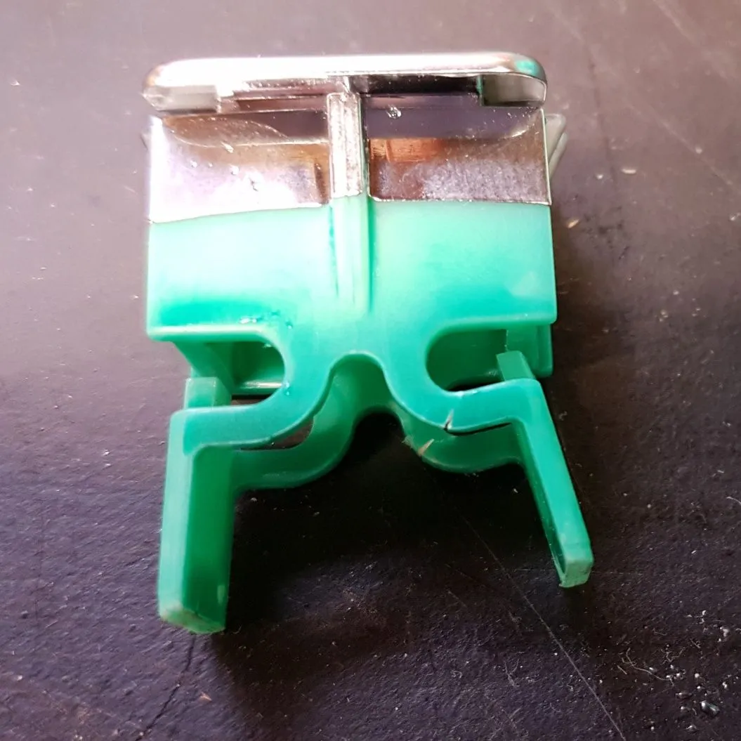

I installed a roof rack on my daughters car and while finishing up one of the "screw" covers broke. Are those available?
I also damaged one of mine when pushing it in.
How damaged is yours?
Likely you will not take it out again unless you want to remove the rack.
I would just guerrilla glue it in somehow.
I did get it out. All i know is it won't click into place.

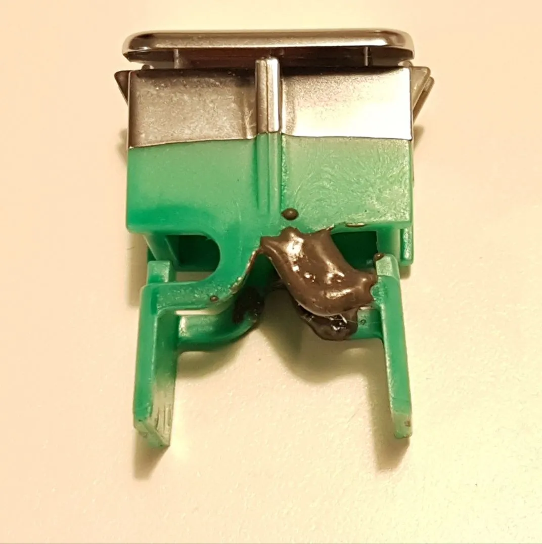

I broke one during the install on my 2016. I used a bit of JB Weld and it was as good as new.
I just installed roof rails on my 2019 CX-5 and one clip broke on installation. I used two surrounding blobs of JB weld to reinforce the break and held the tabs with a mini C-clamp while it cured.
