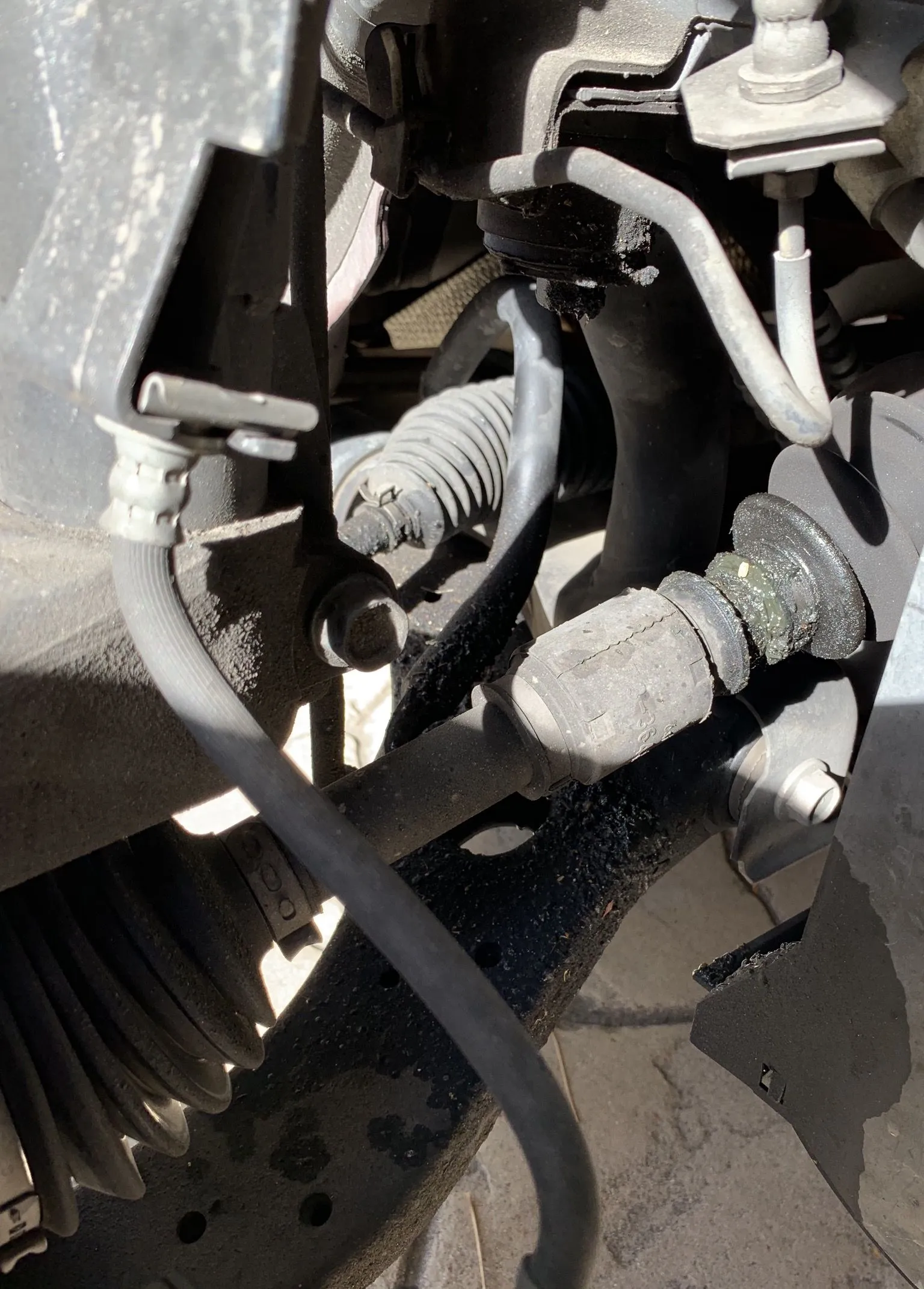

Doing oil change and tire rotation today
Looks like both CV that*s next to transmission - NOT the ones next to the wheel are leaking and flicking lot of grease
What*s your opinion?
Change boots?
Change full driveshaft ?
Oem or aftermarket ?
Appreciate the thoughts. 2012 mazda5, AT, 109k miles

bad.
If it is fresh and no damage to the internals, I'd just do the boot.
OEM shaft is crazy expensive and aftermarket is hit and miss.
I'd buy the boot, take the unit apart and if not filled with dirt inside, swap the boot and call it a day.
If money if no object, just get full OEM replacement.

Cut boot can be anything from road derby or rodents to bad parts, seems a little off given the location.

It*s in both sides

my 5 had 42,000 miles when I bought it, the inspector said the boot was cracked, the grease was all over the place. He said I shouldn't worry too much about it unless there is noise or wobble. Mazda is like this, even my dad's 92 Protege changed the boots quite a few time (with only 35,000 miles on it)
My fix:
- Chinese ebay (Taobao) has it for US$3.5 shipped to Hong Kong
- Mechanic charged me US$100 for the labour.
The labor for both axles is $270. For the parts,
I have two choice: the aftermarket is $115 each good brand new
Oem i just called the dealer but they need vin number which I didn*t have on vacation, because the price is vary between $160 to $560 for the left and $320 to $420 for the right.

Funny funny, was it driver or passenger side?
I was doing oil change this weekend as well at 140k km (87k miles) and found the same, looks like grease started to come out around that shaft on the driver side axel.
I could not find a crack in the boot, so wonder if the clamp gave out.... I wonder if you had a chance to examine that old shaft and see what was the failure point, the boot or the clamp.
