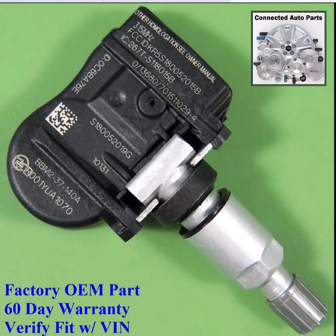

    I'm not sure if there are region specific sensors but here in the US, Tire Rack does list an aftermarket sensor on their website for the Gen 2 and it shows it as being 315 MHz.

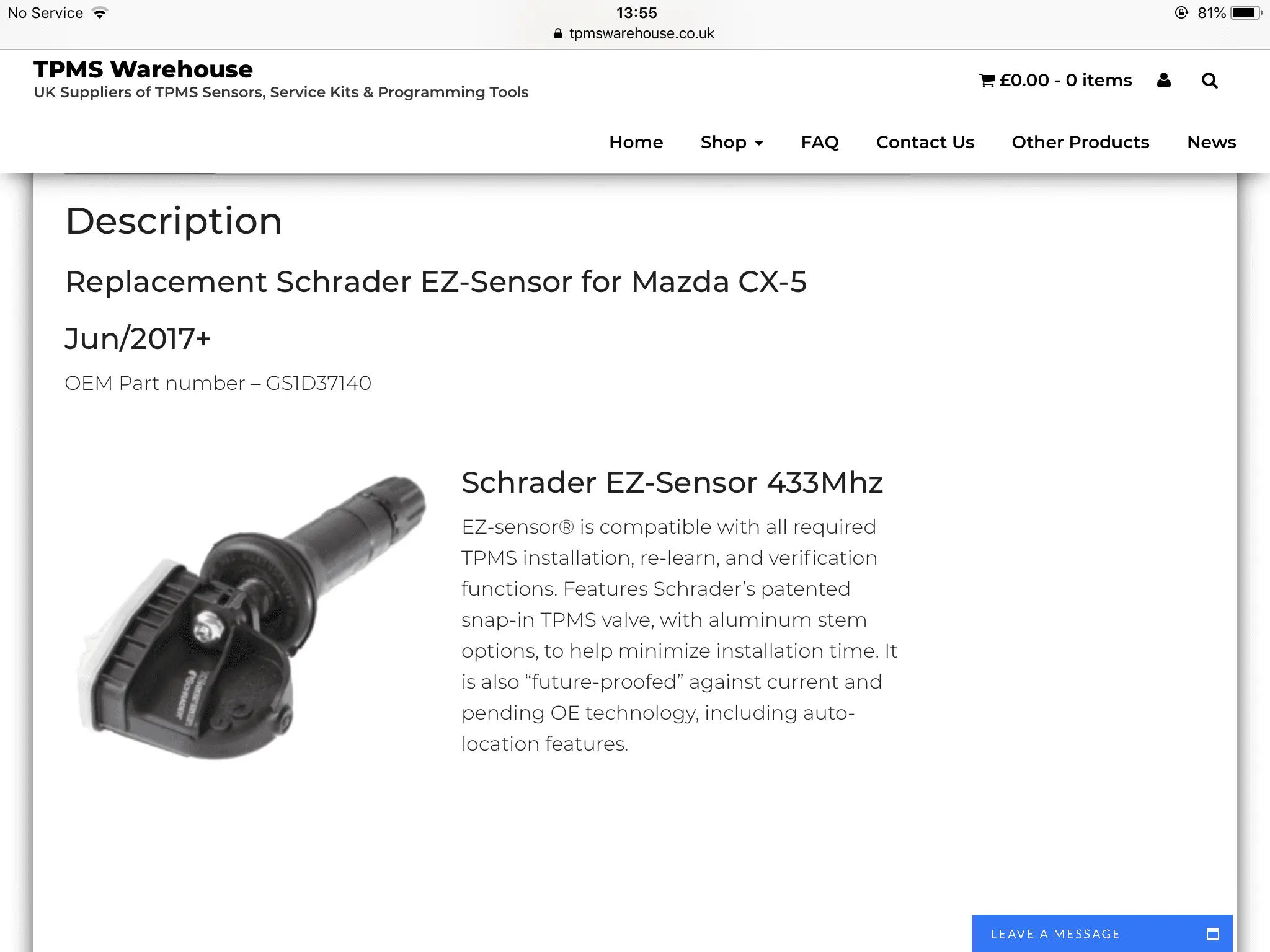

    Not sure it looks like some of the others I’ve seen!!

    Arrow Which TPMS sensors are fitted to a 2018 UK CX-5?
    Quote Originally Posted by wow400 View Post
    Mazda’s part number for its TPMS tire pressure sensor, BHA4-37-140, is the same world wide. That means the sensor used in the US is the same as the one used in UK. You should be able to verify the compatibility of aftermarket sensors with the seller, or simply get these from your Mazda dealer.

    Thank you very much for that - although apparently European ones are 433Mhz, not 315Mhz...?
