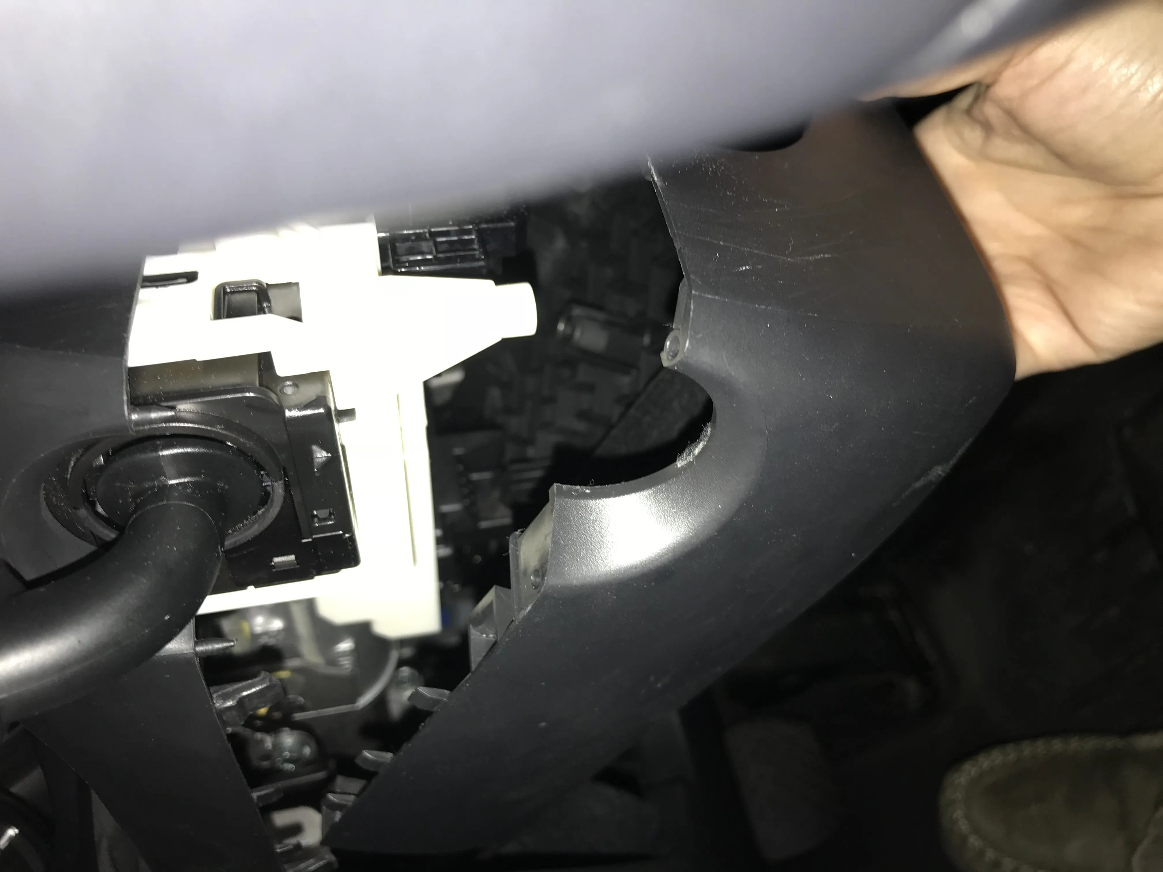

Some folks have asked me how difficult it was to get the steering column plastic surround apart. It's pretty easy. I would turn the steering wheel to 3 o'clock first, that will expose some of the front face of it. I found being able to put a little thumb pressure where the top and bottom come together helped with getting it to pop loose. Basically two screws on the bottom then just separate the top and bottom half. In this photo you can see the snap attach pegs.
