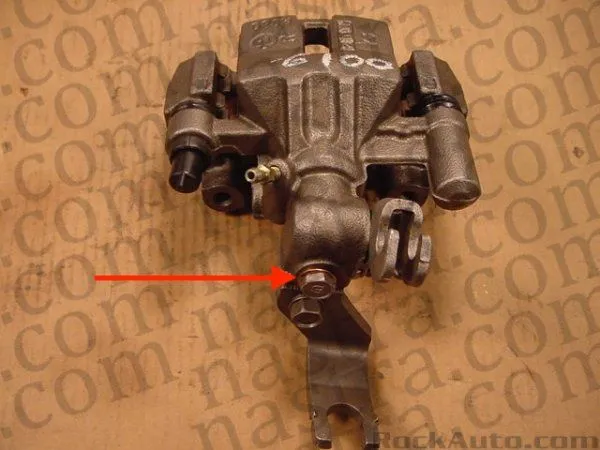

    I put a red arrow pointing to the bolt with the copper gasket that you need to remove to get to the adjuster.
    The adjuster is loose inside, and it might come out with your hex/Allen wrench. I think it is clockwise to push in the piston, and counter-clockwise to release it. But, I am not 100% sure.
