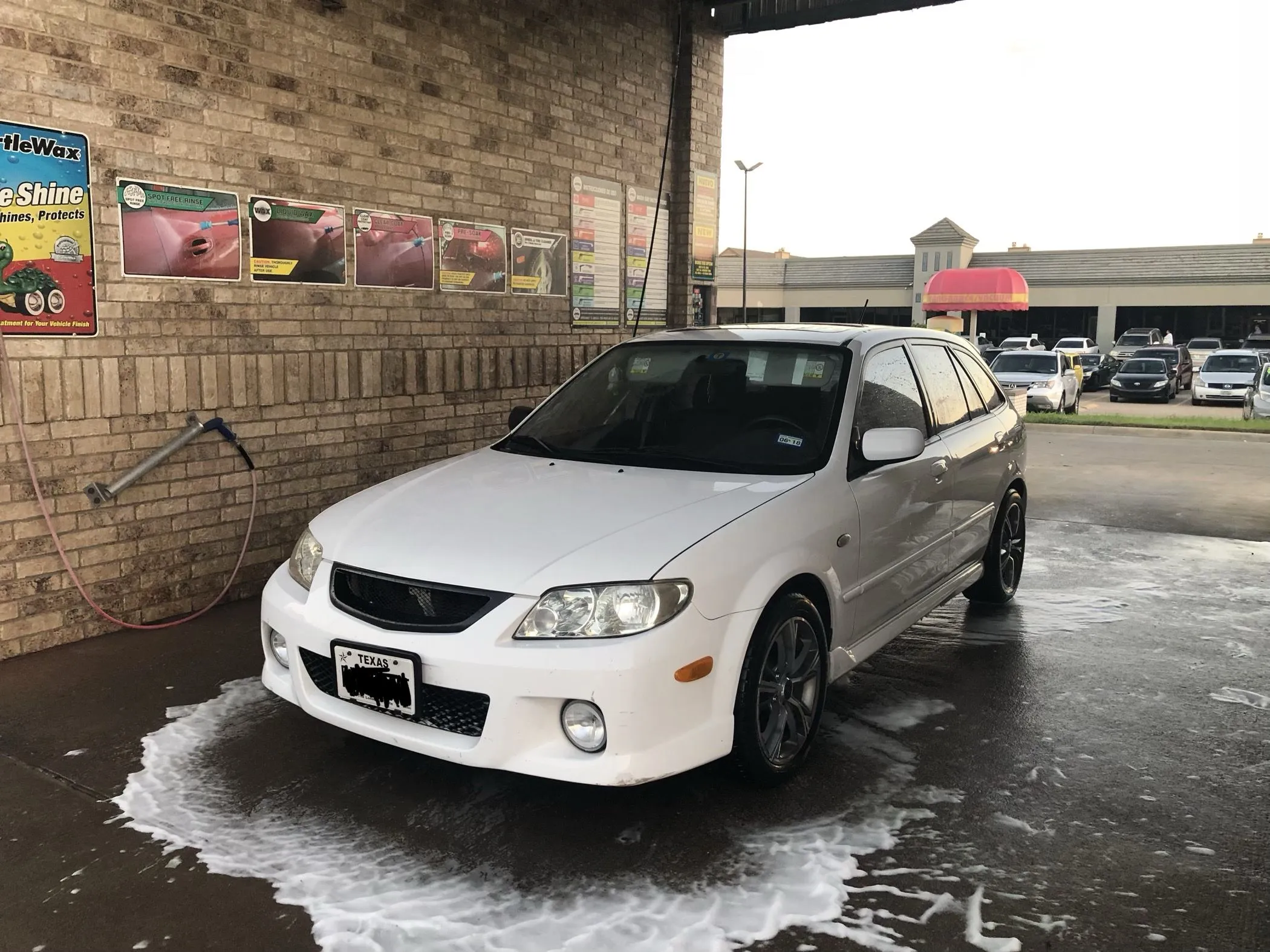

Recently picked up my very first Protege5 from my mother-in-law, who bought it new from the dealer in 2003. It has been garaged its entire life, with the exception of the few months I've had it. I bought it with 81k miles, which seems borderline insane for a P5 nowadays. The paint is in really solid shape, with the exception of some fender and rear passenger dents where my wife ran it into the garage door back in high school. I just replaced the passenger-side mirror because she cracked the inside structure of the mirror when that happened, which looked fine but it had some shake when driving at high speeds. The new mirror is black, which makes me want to replace the driver-side with a similar black one. Father-in-law is from Hong Kong, so he's into "race cars" so he put the rims on the P5 a few years ago.
So far I've barely touched it, with the exception of a few small things. Black neoprene front seat covers because my wife works as a swim instructor and I wanted to keep everything dry. I updated the factory radio with a really nice touchscreen with rear-view camera to keep it with-the-times. I replaced the engine mounts last week (and managed to break my finger in the process) and today I found a fiberglass grill upgrade on Facebook marketplace. I'll probably paint the grill white eventually, but for now I'm going easy with it.
Future plans: I want to switch the tail lights for JDM and see if I can find a Mazdaspeed front lip (which is borderline impossible, if you have one please tell me). I'm also tossing around the idea of having custom roof rack made for the car, but that might be overkill. Most of the ones I find sit too high, so I'm looking for something really low profile.
Overall, its an insanely cool ride and I'm very pleased with it. If yall have any advice, I welcome it!

Welcome to the forum! Good to see another white P5, looks real clean!

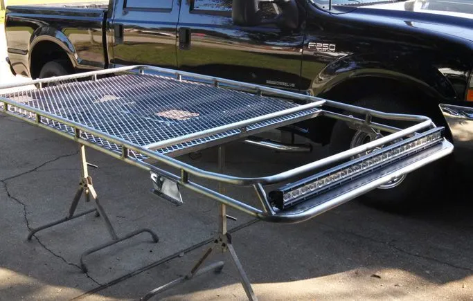

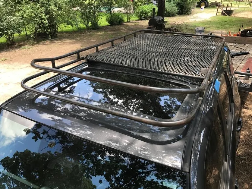

I found a guy on a Rav4 forum that made his own roof rack styled from a *really* expensive brand. I liked the general design and I think that it would work well on the P5 if the design was shortened. I haven't seen anyone with a custom rack like this on a wagon, outside of maybe a Subaru. In terms of originality this would be the way to go. The bar light would be kinda rad too,but that might ere on the side of off-road wagon (which the P5 could never practically pull off). IMG_9115.JPGIMG_9116.JPG
One of the fears I have is making the car too "2006 high-school rave scene". I'm trying to keep it all very clean and nice, but also original and uniquely "me". The P5 scene has apparently mellowed out and car enthusiasts in general have started being more practical in their tastes. Nobody is doing really balls-to-the-wall builds anymore, which could be a good or bad thing, I'm not sure.

That's sick, I was thinking about building a custom basket when I get around to ordering a roof rack. The bar light is definitely offroad-ish, but if you like it then that's all that should matter :)
