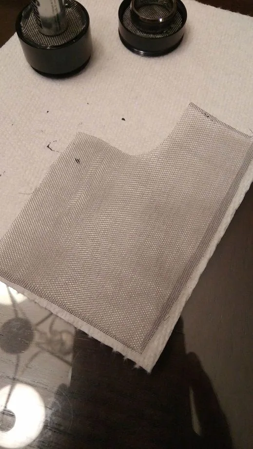

So I ordered some filter material off of eBay back in mid-April. Finally got the material yesterday, so I set about making my own filter.
I chose to use the existing baffle inside the can and add some filters to it. This way, it's located in the same spot as the Mishimoto can shown here:
I don't have a baffle plate like the Mishimoto. Instead I'm using a small amount of stainless steel wool (see the original post).
I was unsure of how many layers of filtration to add, so I figured I'd start with 3 screens and see how things go.
This helpful article from Mishimoto states that they used a 50 micron bronze filter, so I made sure I ordered 50 micron stainless steel mesh.
Here's a shot of the 50 micron stainless steel mesh.

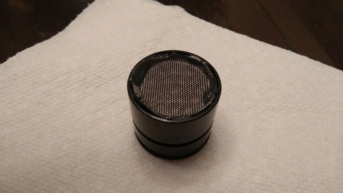

And here's a shot of the baffle portion removed from the can. In this photo, I sized the mesh to the opening and cut it to fit, then mixed up a bit of JB Weld to secure it to the baffle.
attachment.php

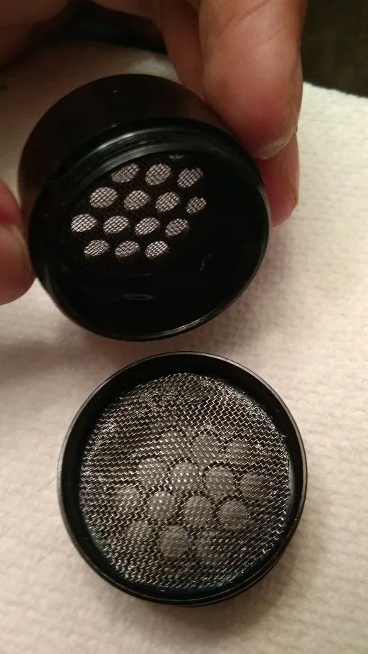

NOTE: If you're doing what I'm doing, make sure you secure the filter screens with JB Weld or something similar. This helps to ensure that there is no risk of the mesh coming loose and being sucked into the intake manifold.
And a shot of the screens attached inside the baffle.
attachment.php
I haven't reinstalled the baffle yet because JB Weld takes about 15 hours to harden completely. I intend to wait at least 24 hours to ensure that the epoxy has bonded and hardened completely before reinstallation. I'll be sure to keep an eye on the catch can for the next few tanks of gas and keep you guys posted with the results.

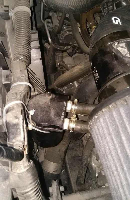

Hi, yes it was still empty at the time, but I have just recently moved the location. Here is a photo of where I have relocated the catch can. Please note that I have a Corksport intake installed, so this mounting solution may not work for you. If I did not mount it here, I would have mounted it on the large coolant hose in front of the engine. I'm hoping the new location addresses the issue, but I will report back in 1000-2000 kms.

Also, I'm not sure how similar the diesel engine is to the 2.5 Turbo, so please keep that in mind.

Ive see people putting the catch can hose there, not the PCV. It does a good job tho. I just bought the can, will install it this weekend and get you updated.
attachment.php
That ADD W1 can is basically the same can that I have, it just has slightly different labeling and a brand name. Do you know what ports the lines are connected to?
Also, what intake elbow is that? Looks sharp.

Just to follow up on this, it has been 4000 km since relocating the OCC. I just checked it and it is still dry. I'm going to trim the tubing to see if that makes any difference, but I'm doubtful that it will.
