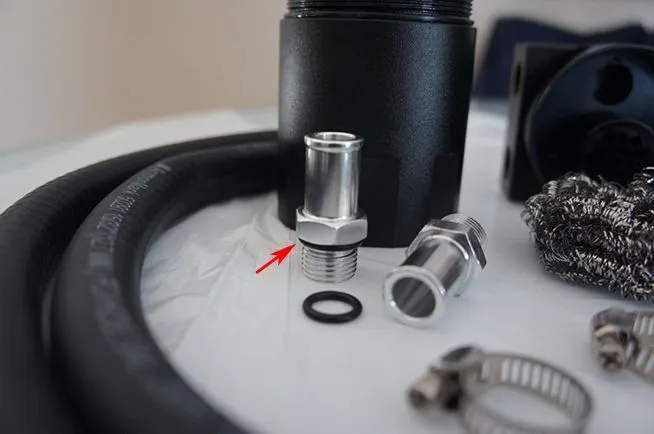

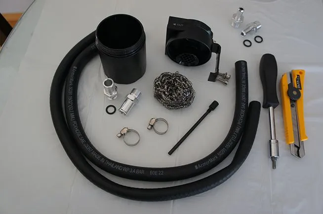

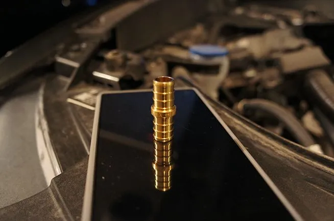

    What you'll need:
    - Aftermarket oil catch can (mounting kit is optional)
    - One 1/2" brass PEX barb coupling (male/male)
    - Pliers (preferably narrow, like needle-nose pliers)
    - Utility knife
    The following materials will vary depending on where you choose to mount the can, what came with your can, and personal preference. I estimated that my installation would require three feet of tubing, but I got four feet just in case.
    - At least four feet of 15/32" crankcase vent tubing (or 1/2" rubber fuel line. You can also use braided SS line, but fuel line is cheaper and works well enough)
    - Steel wool (optional - I just cut a portion from a steel wool dish scrubber)
    - Flathead or Phillips screwdriver (if using worm-gear clamps)
    - Rotary tool or drill to mount the catch can
    - Old rag
    *Pliers and rotary tool not shown

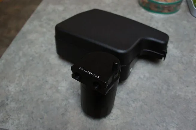

    1. First, decide where you want to mount your oil catch can, and make sure you have everything you need for the installation. Most kits should come with the fittings and o-rings required. Ensure that the o-rings are installed onto the fittings as shown below.

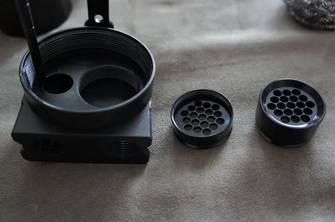

    2. My catch can did not come with a micron filter on the "OUT" side, but I don't think its that important (it's also one extra part to clean/replace). However, on the "IN" side of the catch can, there is a small, removable enclosure. This is meant to give the blow-by something to condense on before settling at the bottom of the tank. I chose to add a very small amount of steel wool to this enclosure to give the blow-by more surface area to attach to. As you can see, there is still plenty of space for airflow.
    Note: For the steel wool, I just cut a portion from a steel wool dish scrubber. This is not as fine as the steel wool you'd typically find in home improvement stores, and it's also rust resistant.

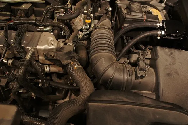

    3. I chose to mount my can on the fuse cover, so I used a rotary tool to drill a couple of mounting holes. Here's a photo of the can mounted on the cover:
    4. Cut your tubing to your desired lengths (remember, measure twice, cut once). Install the tubing, then screw the fittings on to the can. As a note, the crankcase tubing was just a little too small for the fittings on this can, so I really had to muscle it on. 1/2" tubing probably would have been a bit easier to use.

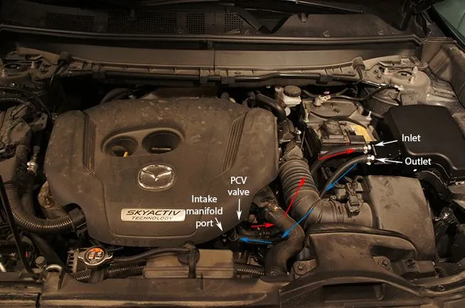

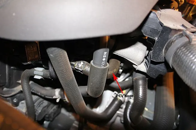

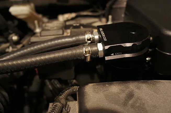

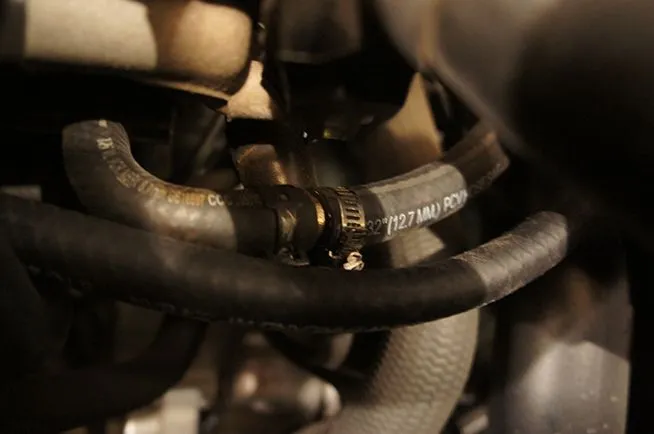

    5. With the OCC mounted, we can now plumb the lines. Refer to the photo below to see where the OEM PCV hose is located (on the right side of the intake manifold, underneath the engine cover). The next photo shows how the flow will run after the installation.

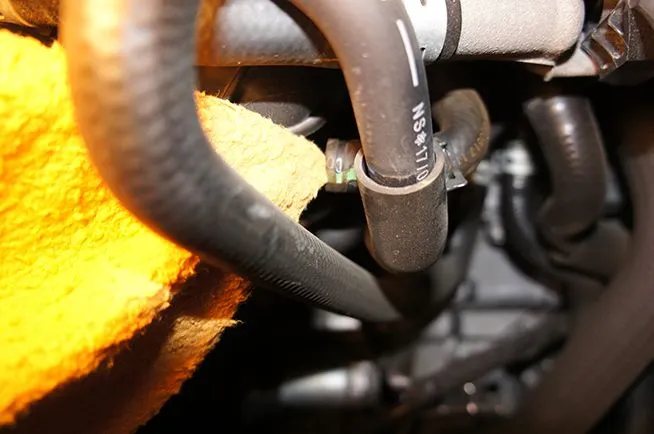

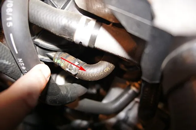

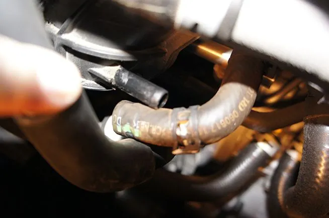

    6. Remove the engine cover to get a better look at everything (just pull straight up, the cover will come right off). Using your pliers, squeeze the clamp to loosen it and move it towards the bend of the hose.
    7. Use a screwdriver with a rag over the tip to slide the hose off of the intake manifold port. It might be stuck on there pretty good, just take your time with it and it'll come off.

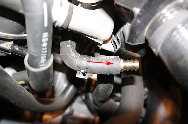

    8. Rotate the PCV hose so that it's facing the OCC. You might have to use your pliers to loosen the other squeeze clamp on the PCV side before you can turn the hose, but I was able to just twist the hose in the right direction. Install the 1/2" coupler and slide the squeeze clamp over the coupler to hold it in place.
    9. Slide a worm-gear clamp on to the other end of the hose from the "IN" side of the OCC, then install the hose on to the coupler. Slide the clamp on to the coupler and tighten it down.
    10. Slide a worm-gear clamp on to the other end of the hose from the "OUT" side of the OCC, then install the hose on to the intake manifold port. Slide the clamp over the port and tighten it down. The engine bay should now look like this:
    11. Start the car and make sure everything looks and sounds good. I took my car around the block a couple of times and also opened it up a bit on an empty road to test for any leaks. If everything looks and sounds good, put the engine cover back on, because that's it!
    Since this install was done last night, I've only driven it around the block to test and then to work this morning (~25 KMs). So far, no issues. At the time of install, I had 11,750 KMs on the odometer. I plan to check in every 1,000 KMs to establish a baseline for how often I need to empty the OCC. All in all, I'm very happy with the way the install went and what the end result looks like. It almost looks like an OEM part
