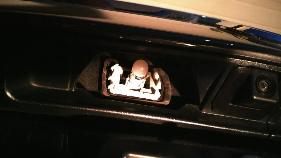

This next step is probably the hardest, which is removing the plastic covers. Here's what they look like:
attachment.php

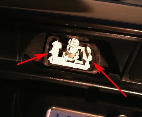

As you can see, each side has a slot that you can fit a flathead screwdriver into. Now, the reason these can be difficult to remove is because of the way they clip on to the bulb holder. In the photo below, you can see that the holder actually hooks on to the cover. Typically, it's the other way around.
attachment.php
With that said, here's what I did to remove them.

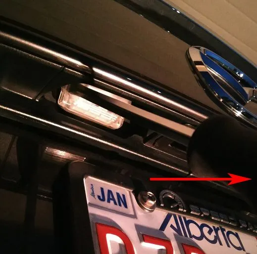

2. Insert the flathead into the slot of the cover that is furthest from the centre. If you're removing the cover on the left side, the flathead should be in the left slot of the cover, and vice versa for the other side.
3. Now push the screwdriver "in", towards the centre of the car. Gradually apply smooth, controlled pressure, and don't jam it back and forth. You might have to crank it pretty far before the cover pops off. Note: The bulb holder is also a bit loose by design, so if you notice that the entire assembly moves a bit while you're applying pressure, don't worry, that's normal.
attachment.php

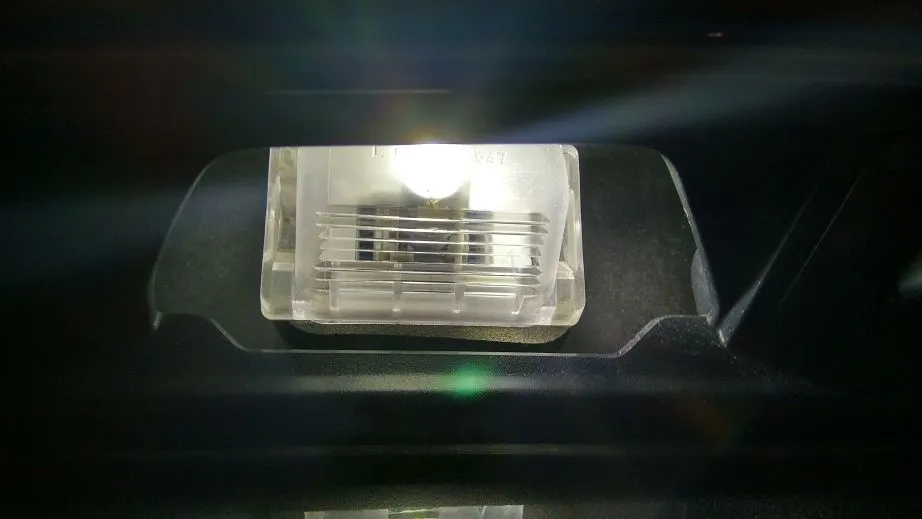

4. With cover off, you can now easily swap the installed bulb for the new bulb. You just pull the old ones out and pop the new ones in. Ensure that you test each bulb before you put the covers back on by switching on your parking lights.
attachment.php
5. Reinstall the covers. They basically just snap right on, but require a bit of elbow grease.
