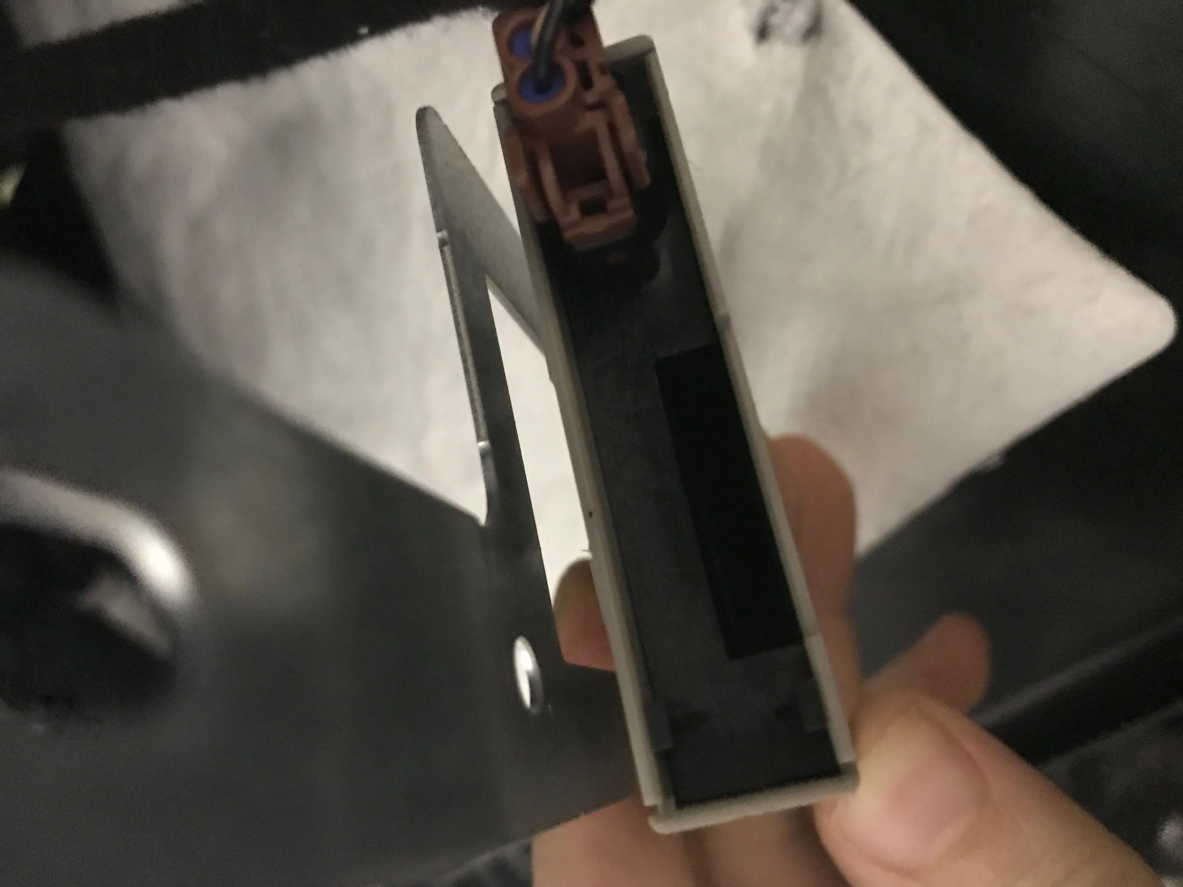

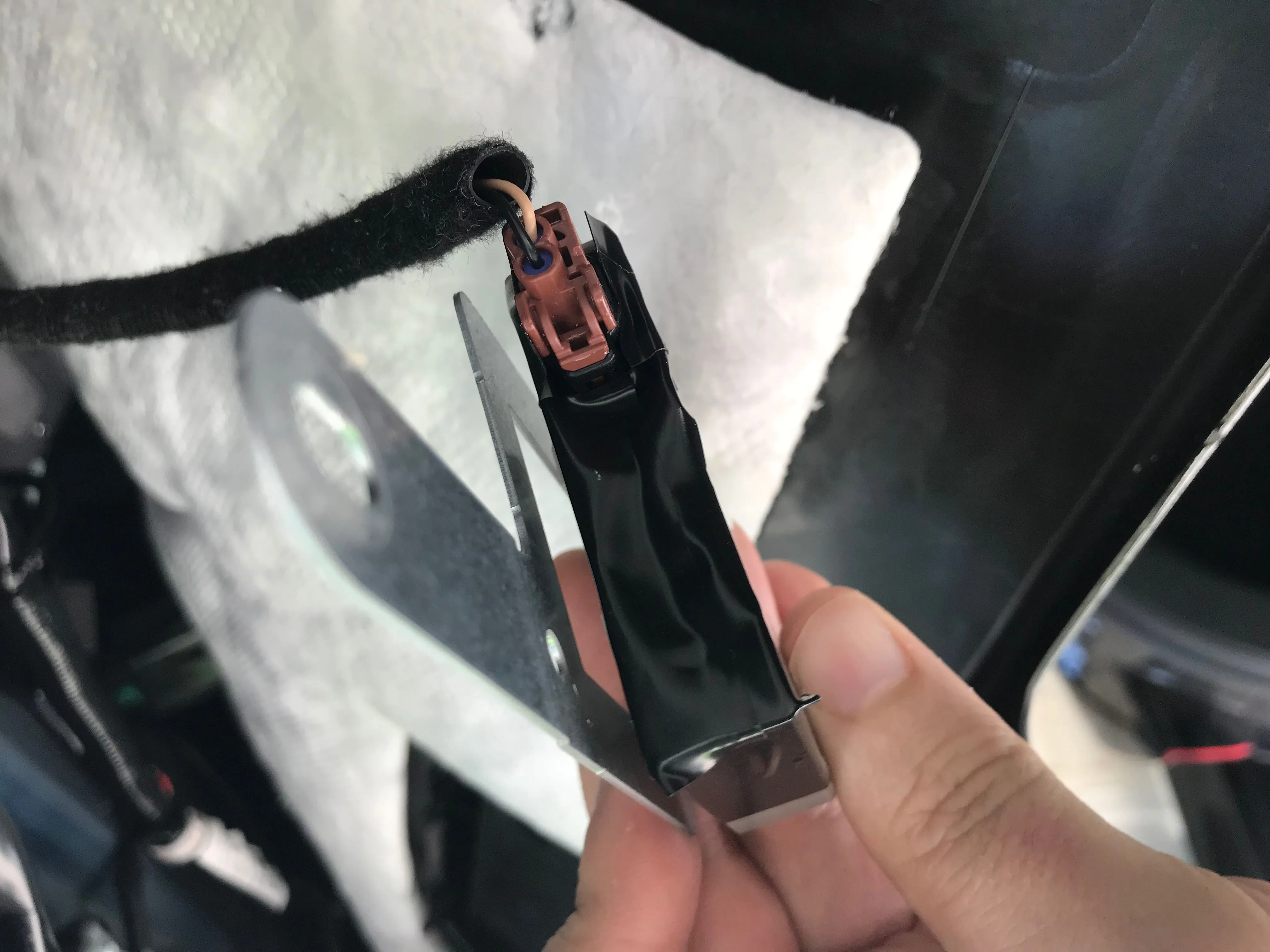

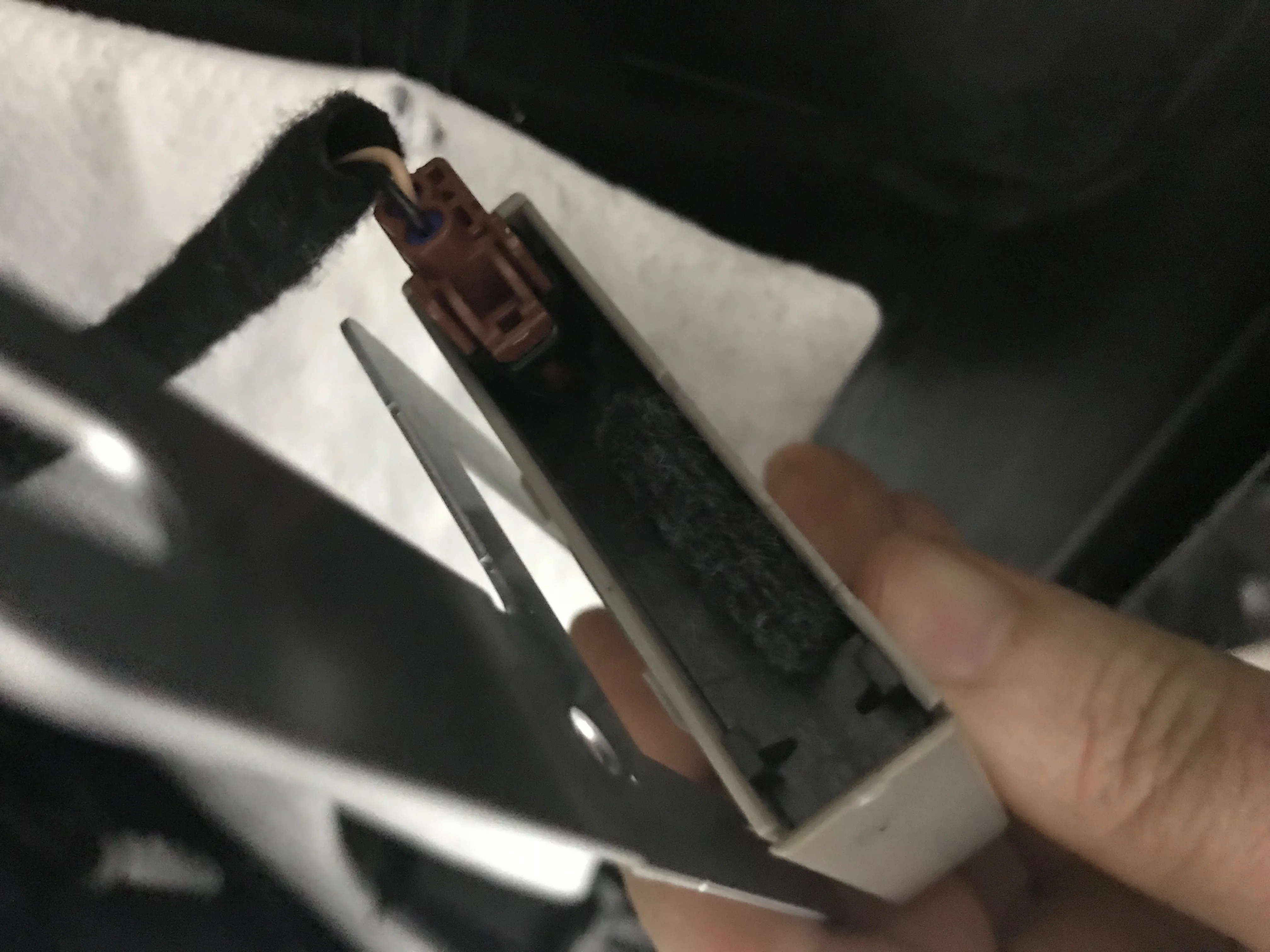

    Quote Originally Posted by Anchorman View Post
    The buzzer is inside the back door. If you take the trim off you can disconnect it or put a bit of masking tape on it.
    Thanks Anchorman!
    The buzzer has a rectangular shaped "horn" opening that I stuffed with some 5 mil thick heavy felt and then taped over it. Measured decibels of the beep went from 89 to 59 measured at head height about 2 foot from door, which is the same decibel level of the door closing itself. Much more tolerable and less harsh now when you hit the open or close button but still plenty to let someone know. Sorry for huge pics, I can never figure out how to adjust image sizes.
    Attached Images Attached Images

    Aye, that*s it. It will always make some noise left connected because it resonates through the bracket.
    Good job. Mine doesn*t bother me so I*ll leave it,
