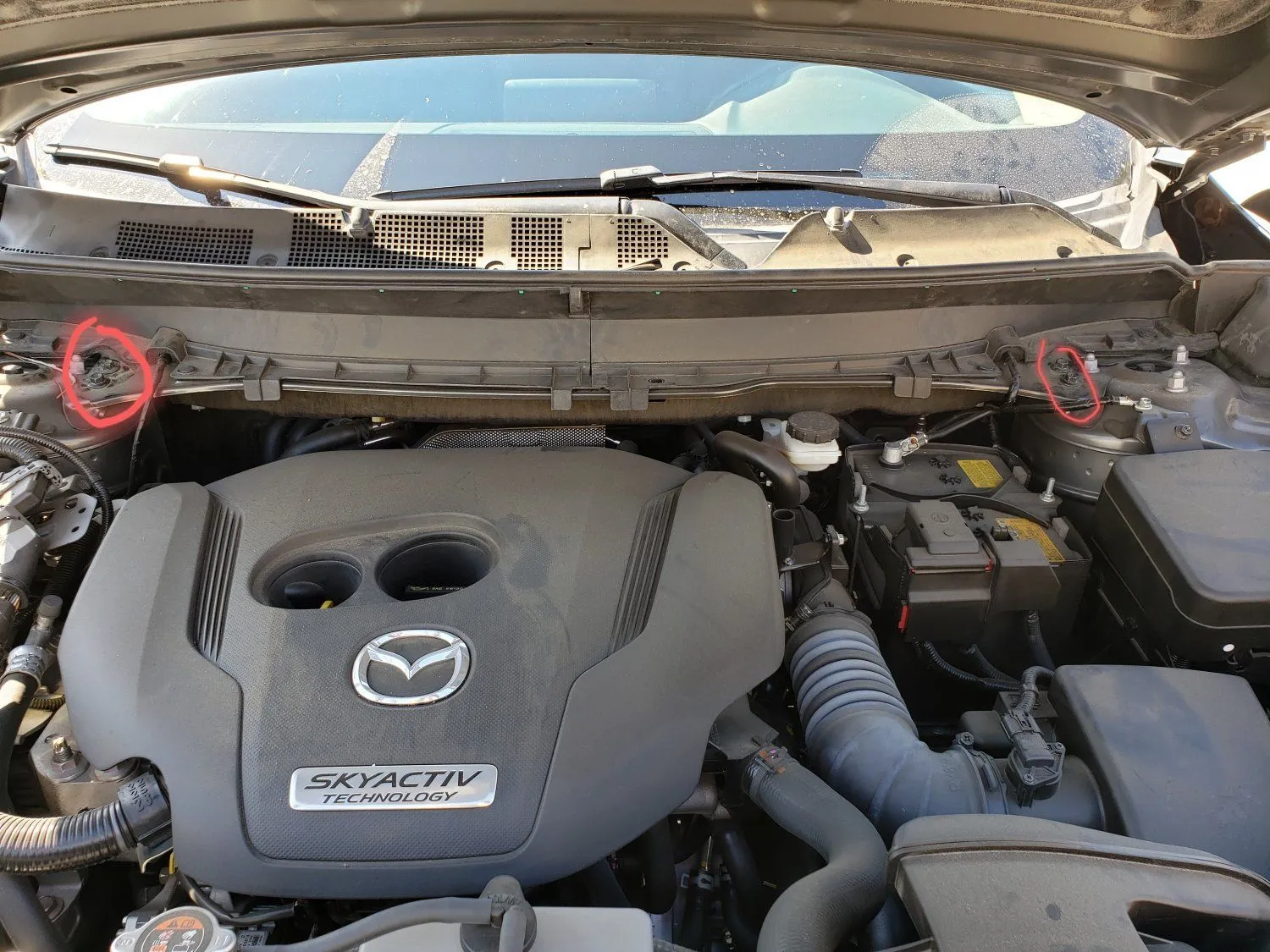

I've had the clunking sound from driver side going over dips and pulling into my driveway since the car had 4k miles in it. I now have 14k miles and the clunking noise has gotten worse over time. In the beginning it happened less than 5% of the time and progressed to over 50% of the time and to point where in freeways little dips would also cause it.
At 7k miles for first oil change and told dealer about noise. They checked it out and said they tightened down some suspension components and that just probably normal sound car makes. At next oil change 12k miles had different dealership check it out and they said likely control arm issue so theu replaced them but it didn't fix the problem. I followed up with the same dealer at 14k miles because the problem kept getting worse. Service manager sat in car with me and he said it sounded like it could be coming from cowl area. Left the car with them and they checked out the struts and cowl area and found the cowl panel bolts could use some re-tightening.
The fix was simply re-tightening the cowl panel bolts. I'm stoked no more annoying clunking noise going over almost any dip and when pulling into my driveway. I'll post a pic to the bolts that need tightening. Hope it helps any of you other there with this mysterious clunking noise that has most dealerships stumped on the fix.
Here is pic, the four bolts that need tightening are circled in red. The service manager said they weren't loose but just weren't tight enough. He said they knew it could be the culprit because when trying to loosen them they came loose pretty easy and normally they should be really tight and little harder to loosen. Good Luck! Hope it helps!

Here is pic,the four bolts that need tightening are circled in red. The service manager said they weren't loose but just weren't tight enough. He said they knew it could be the culprit because when trying to loosen them they came loose pretty easy and normally they should be really tight and little harder to loosen. Good Luck! Hope it helps!View attachment 228636
Created an account just to respond to this. Recently purchased a used 2018 CX-9 GT and heard this sound while test driving but didn’t know if it was the shocks or something else. Glad I tried this first - no longer hear the sound as I drive across speed bumps or any parts where the car would move up/down. Thanks!

My 2020 CX-9 is now FIXED! The strut part came in. They replaced it and the clunking problem was still there on the test drive. After much investigation it was discovered that the front wiper linkage mount was loose! Tightened it and took another test ride. Problem solved.

A TSB for the cowling panel bolts being loose, came out about a month ago.
