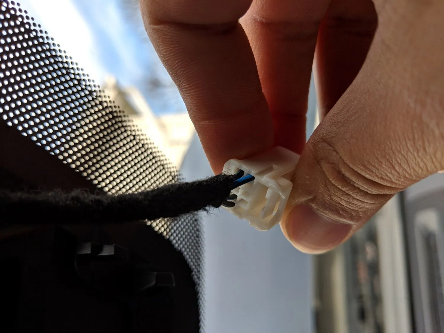

    That's actually awesome, I'm tempted to try it. One of my issues with my Invisicord is it was difficult to insert the pins properly. I had to secure it with zip ties to guarantee it won't pull out.

    It might have been just me, but the pins on the Invisicord I received were very hard to press into the harness plug. Either the plug terminals are too tight against the plastic and leaves very little gap for the Invisicord, or the pins on my Invisicord are a little too thick. I have them inserted to a point that they won't fall off, but a light tug on the cable will pull them so I just zip tied them into place.
    One question I have with this newfound discovery is if it is constant or switched output so hopefully we get an answer from @philw66.

    Same thing, invisicord pins seem to thick to push into harness plug. Barely half in and ended up securing it with tape.

    Follow up...
    Received the cable today.
    https://www.amazon.com/gp/product/B0...?ie=UTF8&psc=1
    Installation couldn't be more straightforward. You will need to supply your own usb cable (the shorter the better).
    https://photos.app.goo.gl/QLjpoRF1iqjLrCQZ8

    That*s the best solution by far. It*s a 5V output, right?

    Quote Originally Posted by Anchorman View Post
    While I did not check the output with a voltmeter, the seller stated that the output was 5V usb.
    "Hi, yes this converter will add a 5V usb output between your rear view mirror and electrical harness. Please note that this product is only compatible with select mirrors and that you need to look at the connector of your mirror to verify fit.
    By SELLER on April 24, 2019"
    It did not fry my dashcam. It is a switched output, so my dashcam unit powered down a few seconds after ignition off.
    Hope this helps...
