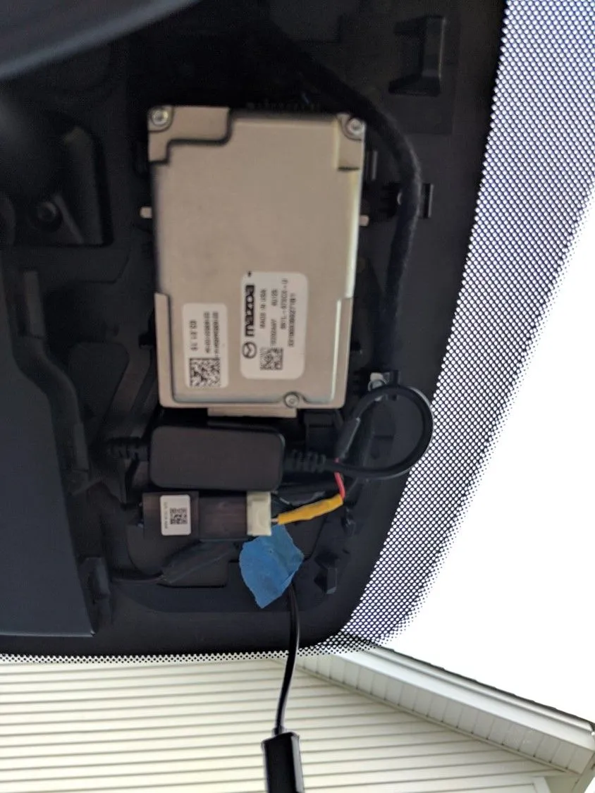

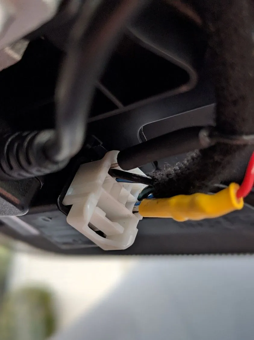

    Just did mine..
    Also installed a dashcam that receive power from the mirror on my cx9 GT (2018). I basically doctored my own invisicord by buying the mini usb with the 12v to 5v converter built in with two wires. I think soldered the wire with two jumper pins and connected to the ignition power. (See above for other ppls excellent instructions).. Works like a charm!

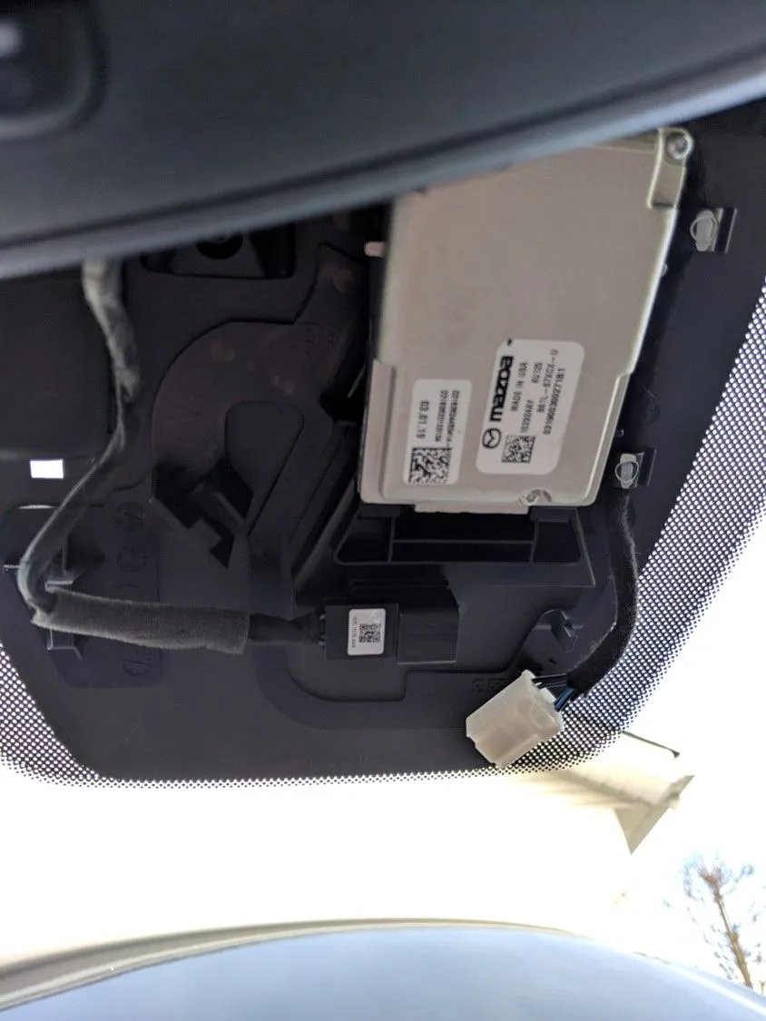

    i have the 2019 cx9 I can't get the access to the mirror plug with the new frameless mirror. anyone has a 2019 and did the mirror tap can share some clue?
    edit: so I was able to access the plug. with the new frameless mirror in 2019 they have the connector hid in the rain sensor area behind the cover.
    pull over the cover and you will see the connector.

    Quote Originally Posted by hollandog View Post
    But the wiring harness is different than described here. Have you found wiring harness scheme?
    Mine looks like this:

    Quote Originally Posted by crimeariver View Post
    I ended up running the cable to use the 12V socket by the passenger side.
