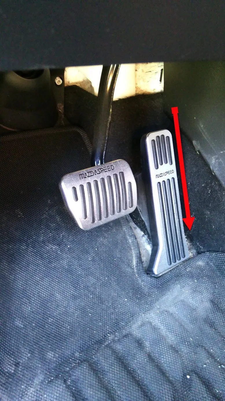

    First, these are the pedals I ordered. They are the same ones Stryker medic ordered and installed back in 2016. https://www.ebay.ca/itm/262622354075?rmvSB=true

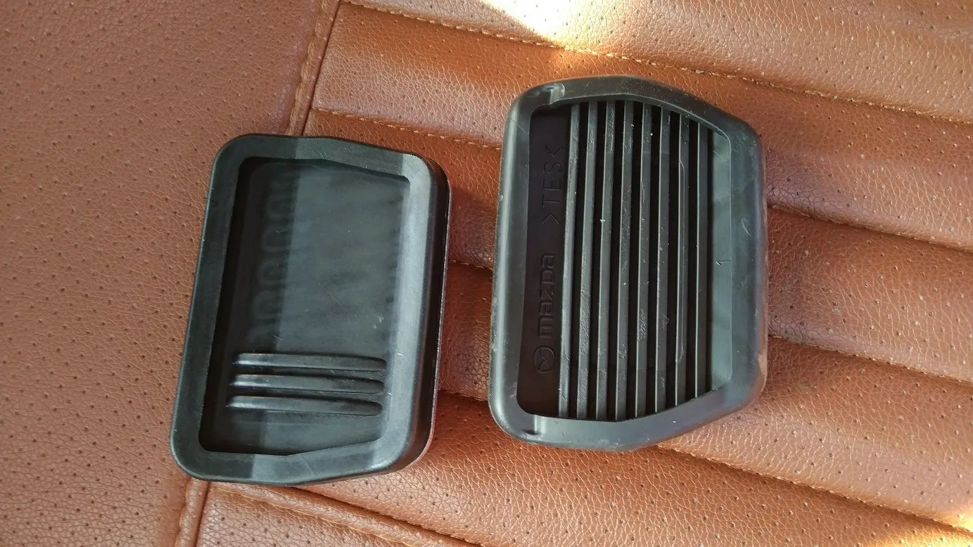

    Here is a picture comparing the aftermarket brake pedal cover and the OEM brake pedal cover.

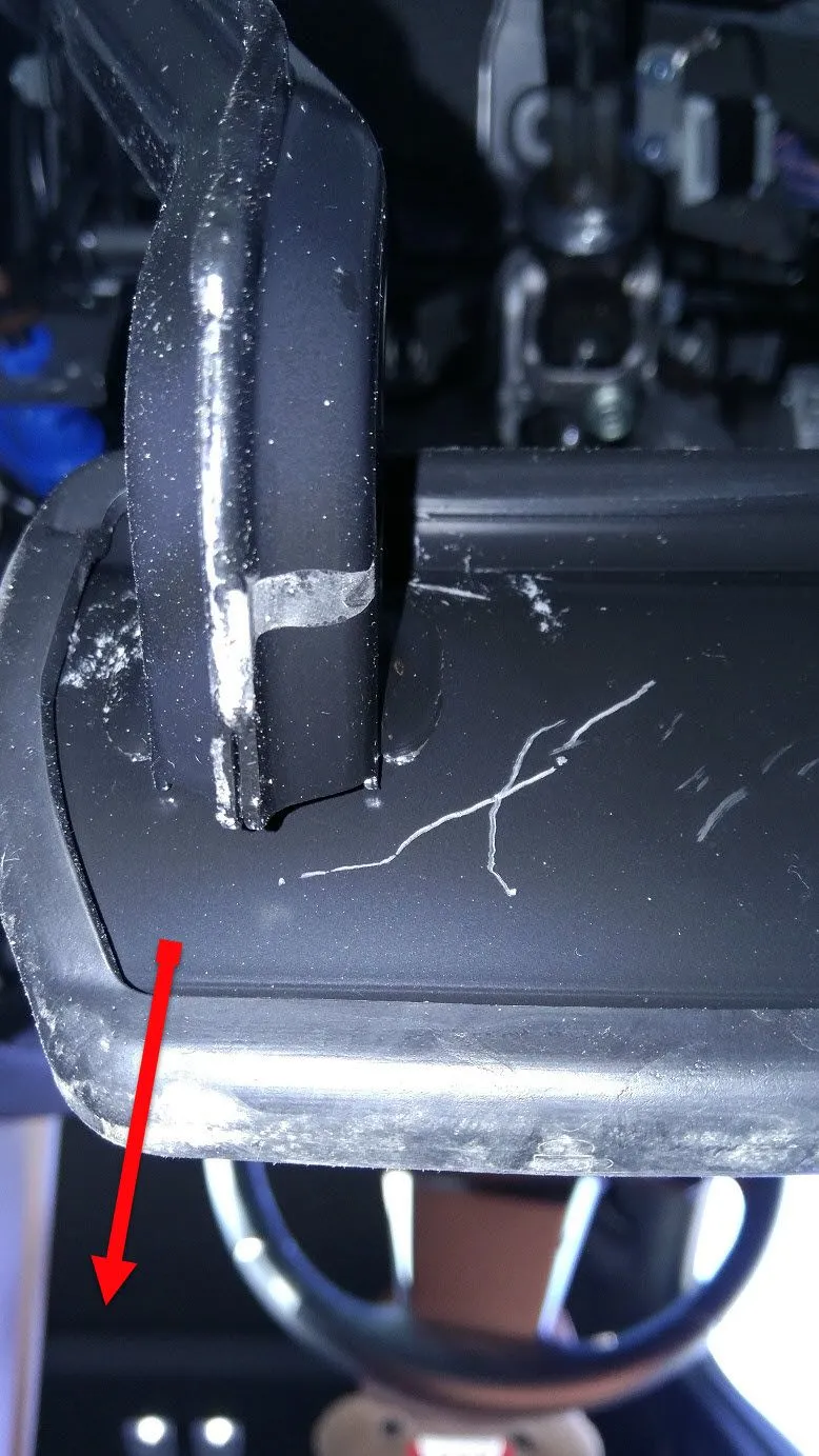

    2. Remove the OEM brake pedal cover. It's very easy. I've found that its easiest to pull it off starting from one of the bottom corners. Just grab a hold of the rubber edge shown in the picture below, and pull to free it from the metal pedal it is covering.

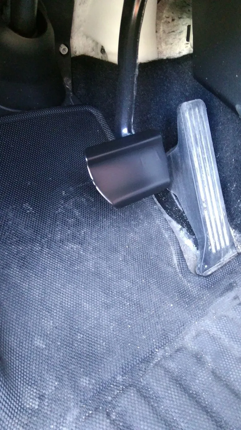

    3. Install the aftermarket brake pedal cover. This might be the hardest part, simply because you have to pull back the rubber lip on each edge separately to get it attached snugly. If you have a screwdriver, you can use it to help you pull the rubber lip back, but I found it easier and faster to just use my hands.
    4. Install the aftermarket accelerator cover. The cover just slips right over the OEM pedal. Once the cover has been slid all the way down, feel around the edges to make sure all of the rubber tabs on the back wrap around the OEM pedal. If there are any out of place, just pull them out and wiggle them behind the pedal.
    5. Step back, because you're done! Super easy.
    Hope that helped you guys out! If you have any questions, post them here and I'll do my best to answer them.
