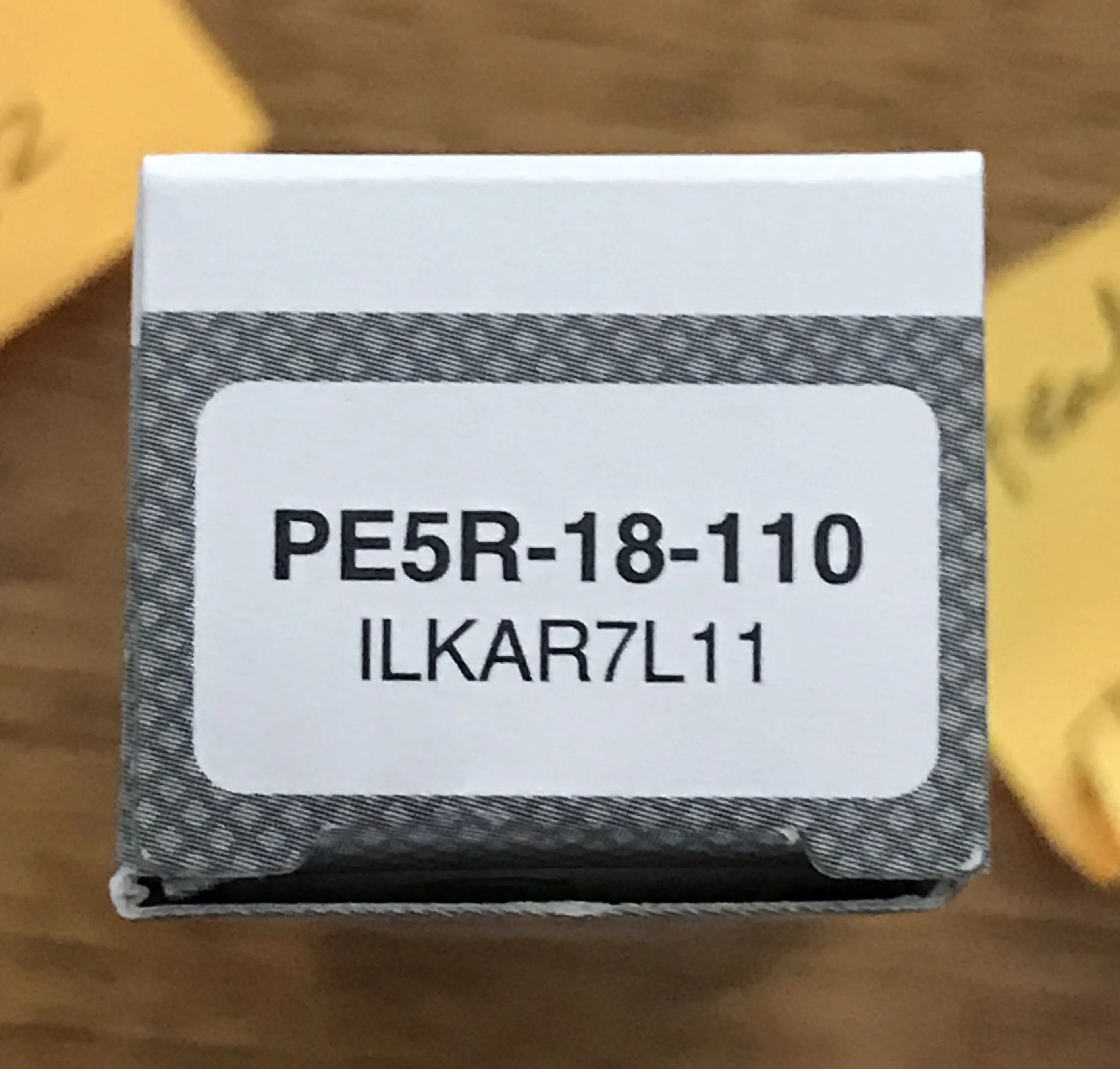

Just got a set of new plugs from the Mazda dealer. This is on the box. Same numbers (both) are printed on the insulator of each plug. Sure looks to me that NGK provides OEM plugs for Mazda.

PE5R-18-110 and PE5S-18-110 are basically the same spark plugs. "S" is standard spark plug but "R" is resister spark plug which adds a 5kΩ resistor in ceramic insulator to suppress ignition noise generated during sparking.
I'm not so sure about that...
PE5R = NGK ILKAR7L-11
PE5S = Denso ZC20HPR11
That's stated in the factory parts catalog
