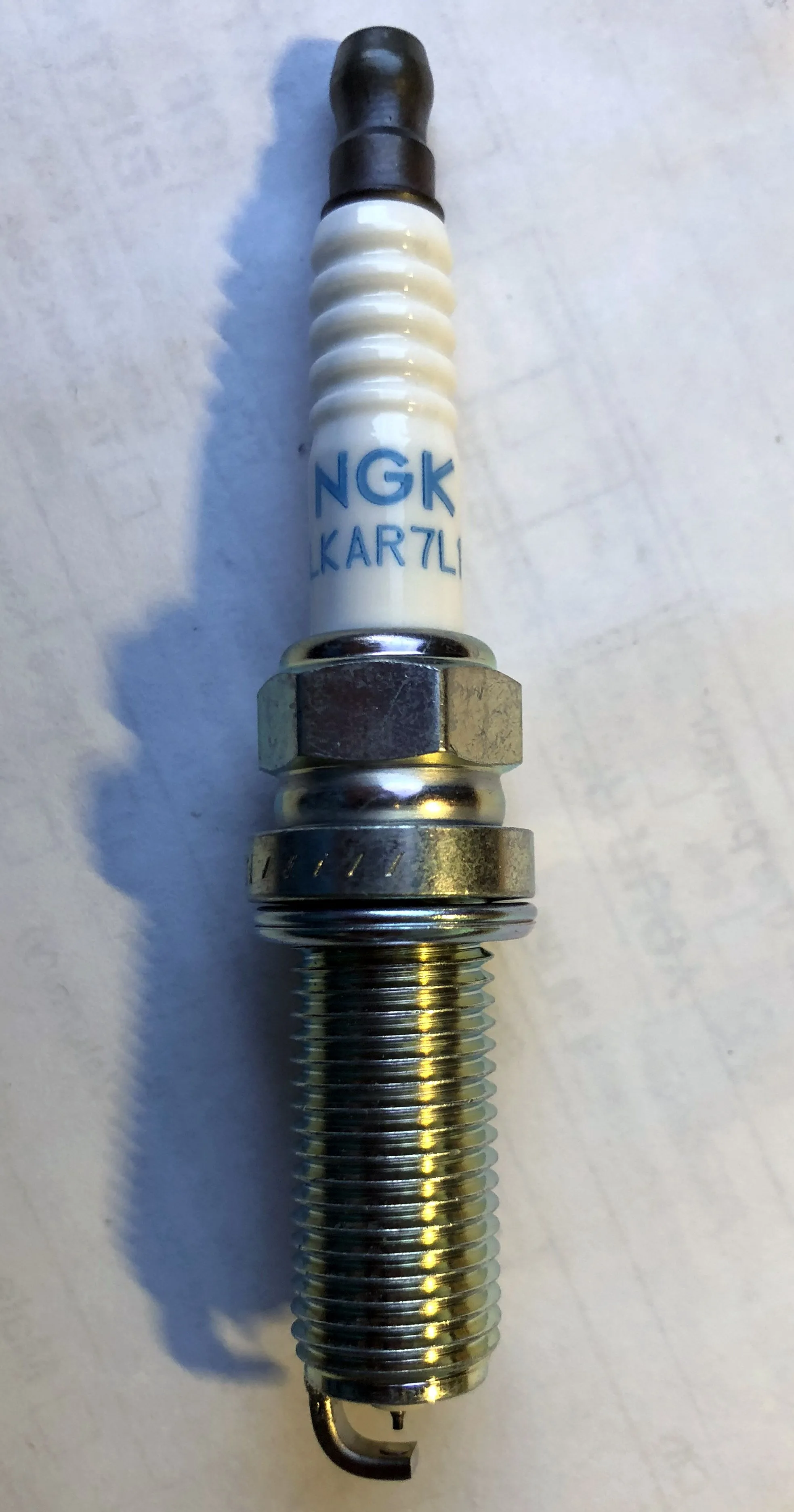

The give away for me in the OP picture is there is nothing printed on the insulator. No brand or part number. That screams knock off.
Every spark plug I’ve ever bought had that printed on the insulator.
Why there's no any model imprint on ceramic insulator of NGK plug?
Actually there is one, but on the other side of the insulator, I took a photo of it.
I also found an interesting pic on eBay, the seller claimed that it's the OEM spark plugs for CX-5.
That's weird as mine actually have something printed on the insulator, here is the pic:
People always use this as the evidence that Mazda PE5R-18-110 spark plug is the same as NGK ILKAR7L11 plug. But the imprint on ceramic insulator is different.

With all the Mazda and NGK spark plug pictures available here I still wish there're more side-by-side comparison pictures beteeen Mazda PE5S-18-110 and NGK ILKAR7L11 spark plugs from different angles. I wish your side-by-side comparison picture has full plug view with NGK and model # imprint on ceramic insulator. And a close up at tip area side-by-side would be nice too. I'll find time checking the package of Mazda plug at my dealer and see if there's "ILKAR7L11" wording on it.

PE5R-18-110 and PE5S-18-110 are basically the same spark plugs. "S" is standard spark plug but "R" is resister spark plug which adds a 5kΩ resistor in ceramic insulator to suppress ignition noise generated during sparking.
thanks for clarification Yrwei, it doesn't seem like we can buy the "S" version anywhere online though... when I Google only the "R" resistor version shows up....
PE5R-18-110, do you have any links to buy the "S" version that came with the CX-5 from the factory ?
