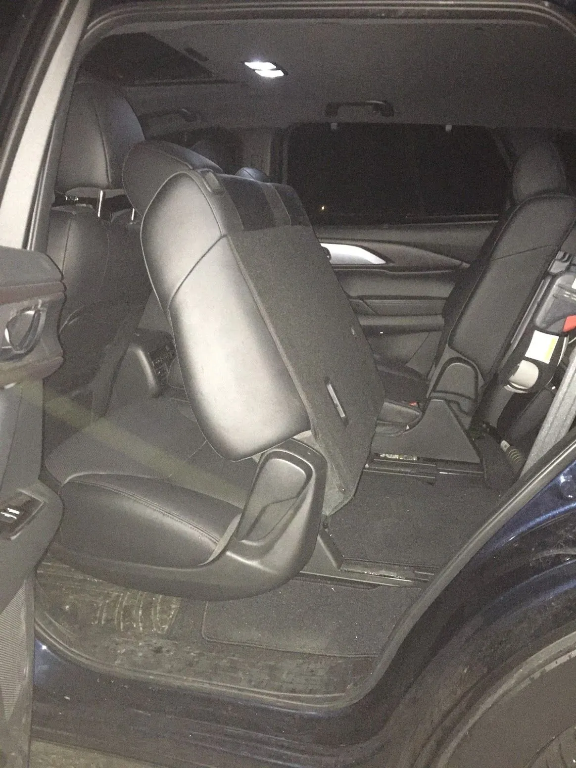

Same with my '17. Here's a bad photo (it's 10:30pm and drizzling here). I got it into this position without touching the bar under the front of the seat; I only used the lever by the headrest.
