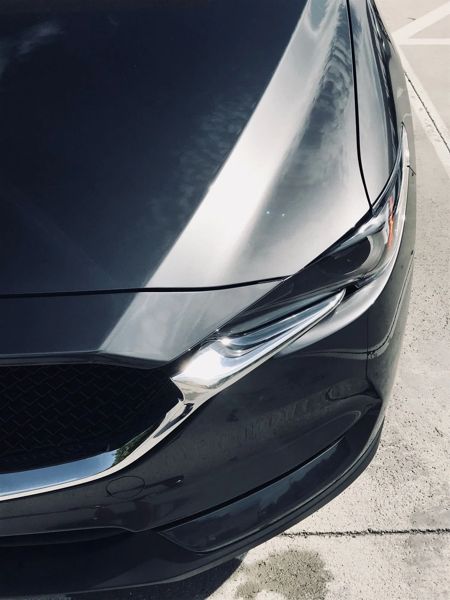

I applied this product to the front bumper cover and plastic top grill lip of my '17 Machine Gray CX-5:
https://www.amazon.com/dp/ (commissions earned)
After 5500 miles, I don't see any unusual paint wear. It has a few pinhead-sized rock chips here and there on the front clip, but that's expected for any vehicle that sees highway use. I live in SW VA and my car is parked outside nearly all of the time, but regular car washes and the proper cleaning products keep it looking fantastic.
