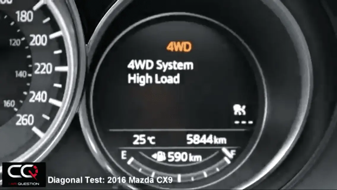

In this AWD diagnostic test made by Car Question, very few fail on it but a gen-2 CX-9 with i-Activ AWD did fail with "4WD System High Load" warning message. They re-tested again with another CX-9 later making sure it's not a mechanical issue - and that's not the case. They were also surprised to see the fail since the Mazda CX-3 and the Mazda CX-5, with struggle, got to the top.

Not just Mazda's i-Activ AWD locks the clutch coupling when a wheel could leave the ground, all other AWD systems on compact CUVs would do the same thing. In old days a true differential lock or limited-slip differential would control any single wheel slippage on the same axle, but newer AWD system utilizes ABS / TCS system controlling single wheel spinning on the same axle with brake for better control and less cost.
In Car Question AWD diagonal test they also found turning TCS off actually helped their CX-5 easier to get to the top.
